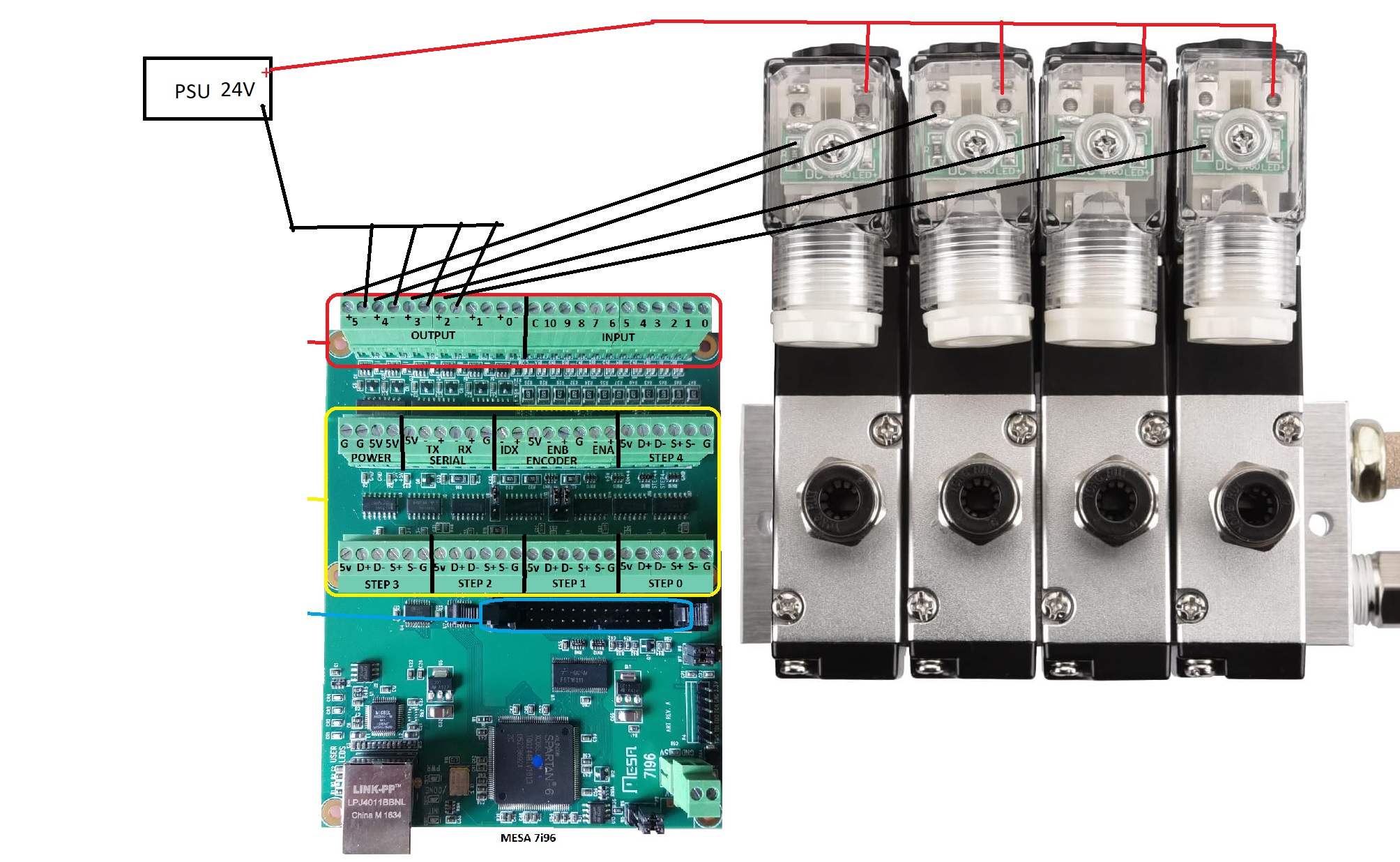

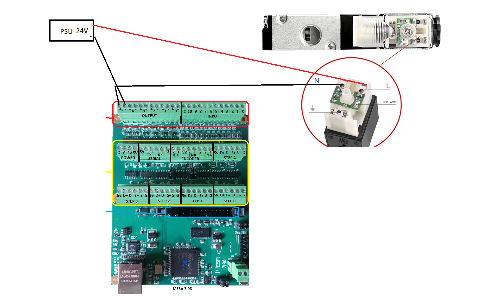

08 Sep 2024 14:23 #309659
by swepeter
Replied by swepeter on topic Mesa 7i96 Output Wiring
I am a bit lost as well and the pictures are gone. Is this correct?Thanks so much
- Posts: 18093
- Thank you received: 5325
08 Sep 2024 14:29 #309663
Replied by PCW on topic Mesa 7i96 Output Wiring
That look correct as long as the valves have flyback diodes
(it looks like they do)

08 Sep 2024 14:40 #309664
by swepeter
I believe they do. a led there at least

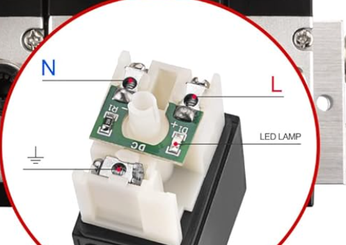

- Posts: 21957
- Thank you received: 7478
08 Sep 2024 14:56 #309669
Replied by tommylight on topic Mesa 7i96 Output Wiring
---This has NOTHING to do with the subject, it is a public announcement to be careful on the internet!!!---
Those pictures are proof of how bad the internet has become, notice the L and N marks, that would imply mains voltage (110V or 220V) as L stands for a phase and N for neutral, yet this is for a low voltage DC equipment that clearly has marks + and - on the board.
