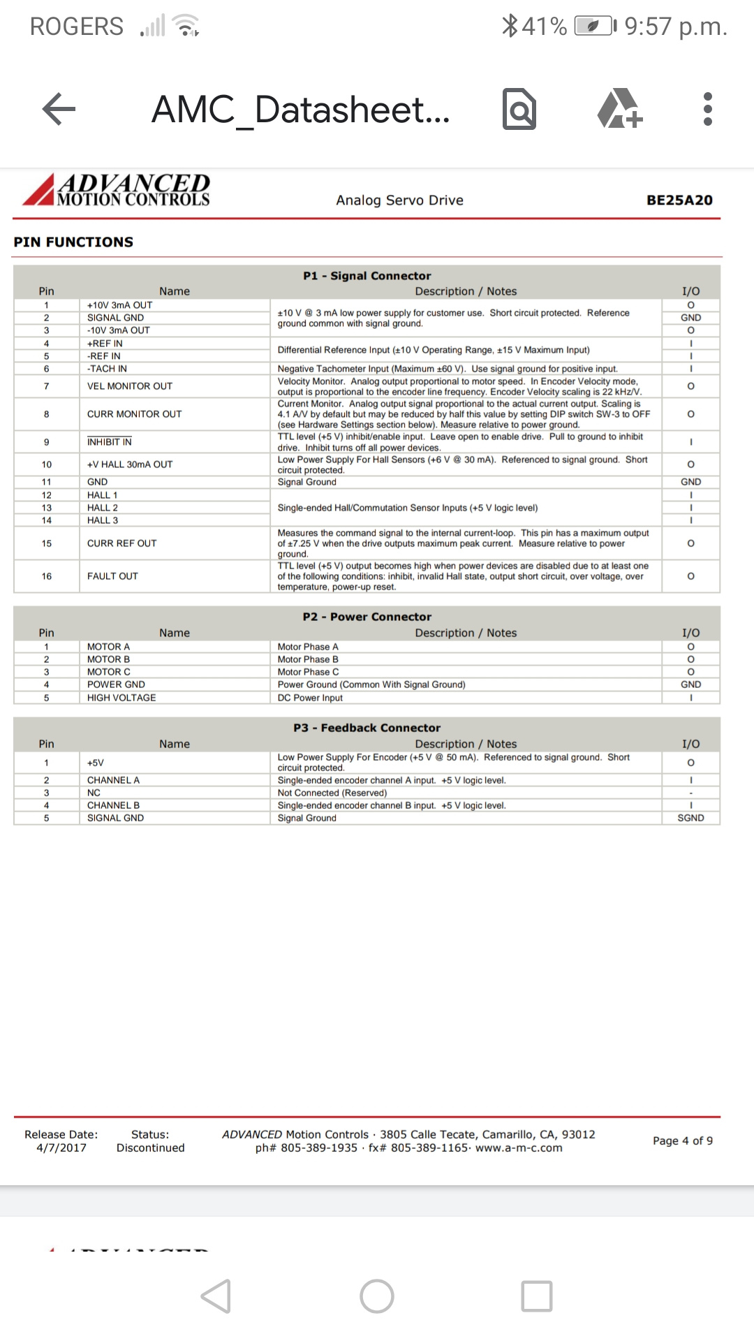

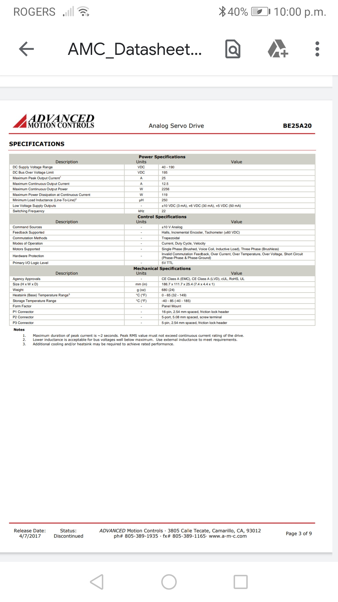

I'm sorry about that tommylight, I totally forgot about you telling me that, I'm not the sharpest nice in the drawer sometimes, as for the signalling voltage I'm not really sure, I read the documents and I would say it's 5v but not 100 % here is a couple pictures of the specs.

Yes, you are correct. The enables and fault output are all 5v. You don't need a 24V supply in there. I gather that's probably what John was telling you in the other thread.

Those drives have one major issue that needs to be fixed before proceeding any further, namely the inhibit input is reversed, meaning if left unconnected the drives will be enabled, and that is a big NO for servo drives.
That can be foxed by adding a resistor to pull that input low always until Linuxcnc takes control and sends the required 5V for enabling the drives. A 1KOhm resistor should do the trick, but you will have to test that and be sure that the drives remain disabled until the enable on Linuxcnc is turned on. That input then must be connected to enable on the 7i77 for all drives separately, and the other side of the 7i77 enable connected to 5V.
The fault can be connected directly to one of the first 4 inputs on the 7i77, namely the input 0, 1, 2, 3, and those inputs should go through a comp as to trigger the fault for each axis when the input value reaches 5V, not hard to do in hal once you get the hang of it.
Do not proceed without testing the resistor part, having enable working correctly on servo driven machines is a must, there is no way around it.

Ok great, so do I connect the resistor to the inhibit in to the signal ground on the drive?
- Posts: 22037
- Thank you received: 7505
09 Apr 2020 19:25 #163418
Replied by tommylight on topic Need some wiring help with board...
Yes, inhibit it and the other side of the resistor to signal GND.Ok great, so do I connect the resistor to the inhibit in to the signal ground on the drive?

For AMC (Advanced Motion Controls) servo amps, you can easily invert the inhibit signal by removing a shunt soldered to the amplifier board (J1).
With J1 removed, you can wire directly to the Mesa enable - no relay(s) needed.
Jim
