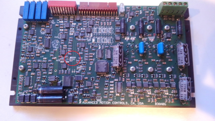

10 Apr 2020 12:17 - 10 Apr 2020 12:29 #163512
by Catch22
Replied by Catch22 on topic Need some wiring help with board...
My board is a bit different, still can't find the dang J1.
Tried to add a picture but it won't let me says it exceeds the size I'm aloud.

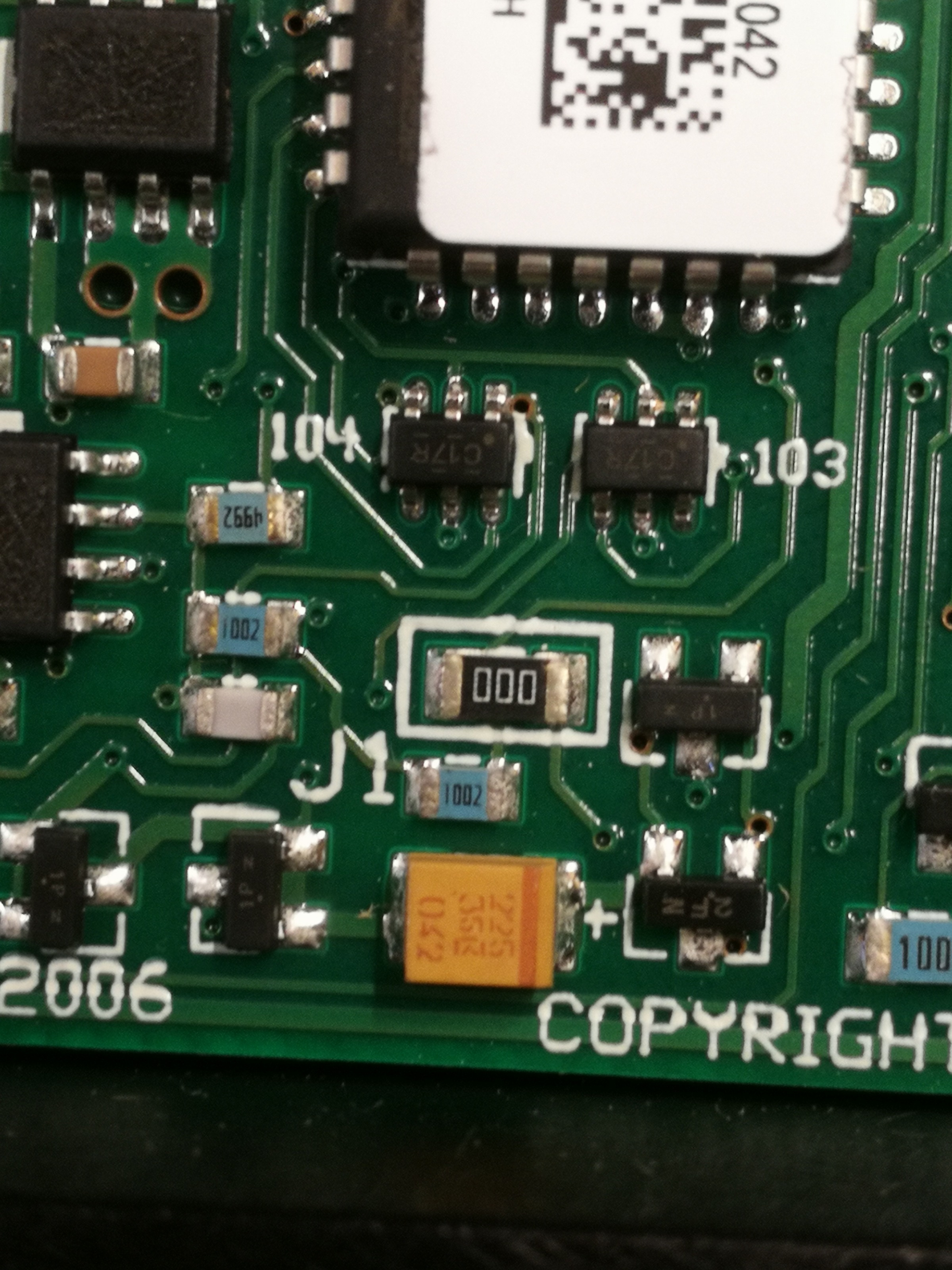

12 Apr 2020 13:38 #163804
by superlen
Replied by superlen on topic Need some wiring help with board...
Yes, the one in the box. It's a 0 ohm resistor loaded there. You simply need to remove it. You don't have to pull the board, but you need to make sure it's powered off first.
I would also make sure to watch out for ESD. One side of this resistor is most likely a direct connection to a processor input pin. I wouldn't run out and buy esd wrist straps and such, but I wouldn't pull it off while sitting on a wool chair, in a carpeted room, in Arizona, during an August dry spell either.
