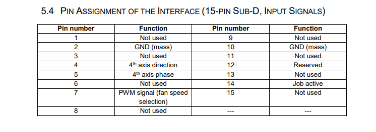

Hi
Well i have a lot of questions
I'm sure this machine is not perfect but i like the idea to share a all in one solution with big surface for mill mostly aluminium/wood and use as big 3D printer
I check for stepcraft 2 D series CNC + 3D printer adapter
I dislike to order the USB version with UcCNC but i think this is better for use the 3D printer easily.
The manufacturer allow to order a internal parallel port adapter for replace the usb interface.
What did you think :
-order machine from other manufacturer ?
-pay 200e more and use Uccnc for 3D printer, so use the machine immeditly and do the retrofit later because not easy to use as 3D printer with Linuxcnc ?
-do not use Linuxcnc for 3d printer ?
For retrofit :
-use parallel port adapter + mesa 7i92M (or other ?)
-use other mesa card like 7i76e or 7i96 and remove all the stepcraft electronic ? (i have finally thinked : need to add external driver and the performance kit include some special encoder for Y axis so is really more simple to keep the internal board and use parallel port
Or do not order this machine and find other better product ?
For reference :
www.stepcraft-systems.com/images/SC-Serv...ructions-PH40_v2.pdf
At the end "only" step/dir and relay + pwm for fan need to be configured from parallel port so linuxcnc need to be configured correctly for the extruder motor amount quantity, the temp for bed and extruder are set directly on the dedicated controler.

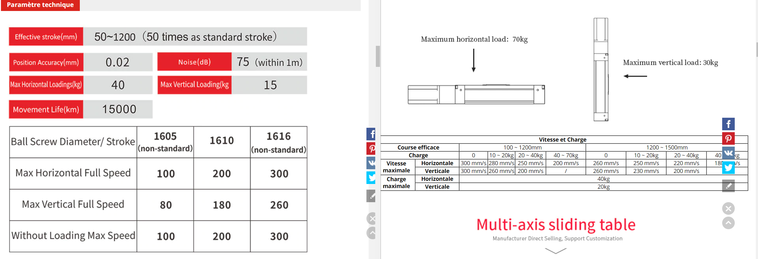

The RXS-100 rail and FSL60 have some specs attached
i know her lol after 3 time she never use anymore, or if this is not easy as she want i can order a printer for familly later :baiser:

That would also do nicely for a plasma cutter. Prices ?The RXS-100 rail and FSL60 have some specs attached
- alkabal
- Posts: 476
- Thank you received: 52
28 Apr 2020 22:56 - 28 Apr 2020 22:56 #166026
by alkabal
Replied by alkabal on topic CNC Stepcraft 2 retrofit mesa + 3D printer stuff
price is somethink like 500 to 1000 euro depending on the length
RXS-80 is little cheaper
and exist some similar model with belt and pulley less exepnssive, more fast but less rigid
