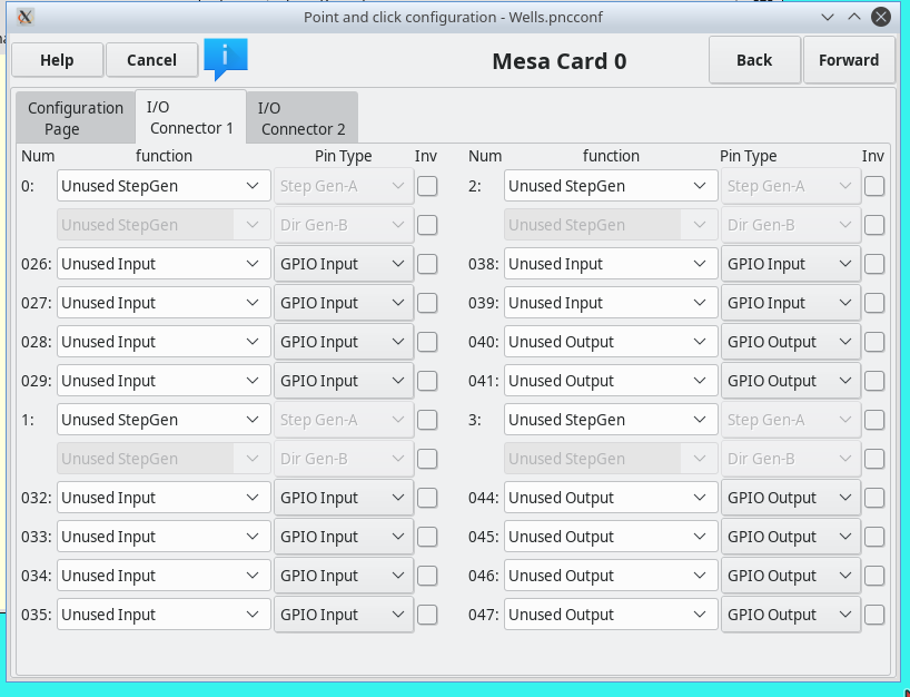

I can see the 7i29 on this system - seems to make sense - but I can see the two 7i84's - but what I see on the screen doesn't match up with the number of inputs/outputs on the card in the Mesa configuration wizard
There are three "SOFTWARE PROCESS DATA MODES", but I didn't see a place where I would choose?
Perhaps I'm supposed to use a low-level configuration tool first?
I think I should see something like 32 inputs and 16 output?
I've attached what I'm seeing.

Pncconf can create the basic hal/ini files for
the 7I29 servo PWM/encoder setup (on P2)
but does not have any data for the sserial devices
connected to P1 via the 7I44
You will have to connect these manually in the hal file.
if you want a list of available 7I84 pins and parameters,
you can run:
halcmd show all | grep 7i84

The above line Is not returning anything. I can grep the 7i93 but not the 7i44 or 7i84 .. do I need some hostmot2-firmware-?? or run ssinstall out of sserial.zip?
Trying to figure out the setup workflow because I have to configure this manually - so after I add the 7i84 , will I not be able to run pncconf again to change anything?
Seems like there should be something like a "addf hm2_7i84.read" in the hal file?
Should the [HMOT] section of the ini file list the 7i84?

Finally back on this - I have red LEDs on the 7i84s
Linuxcnc IS running from the command line - don't see any error lines
$ halcmd show all |grep 7i
shows no 7i84 - only 7i93 lines
I have 7i93_svss4_8d.bit in the 7i93 - connected via 7i44 to the 7i84s
If I grep
$ grep 7i ~/linuxcnc/configs/wells/*
I see reference to the 7i93 in wells.hal -- don't see any other card names.
This config was auto-generated via Pncconf - there are sanity checks for other daughter boards, but not for the 7i44. The PWM requirement for the 7i29 conflicts with boards I think are similar to the 7i44.
running version 2.8
