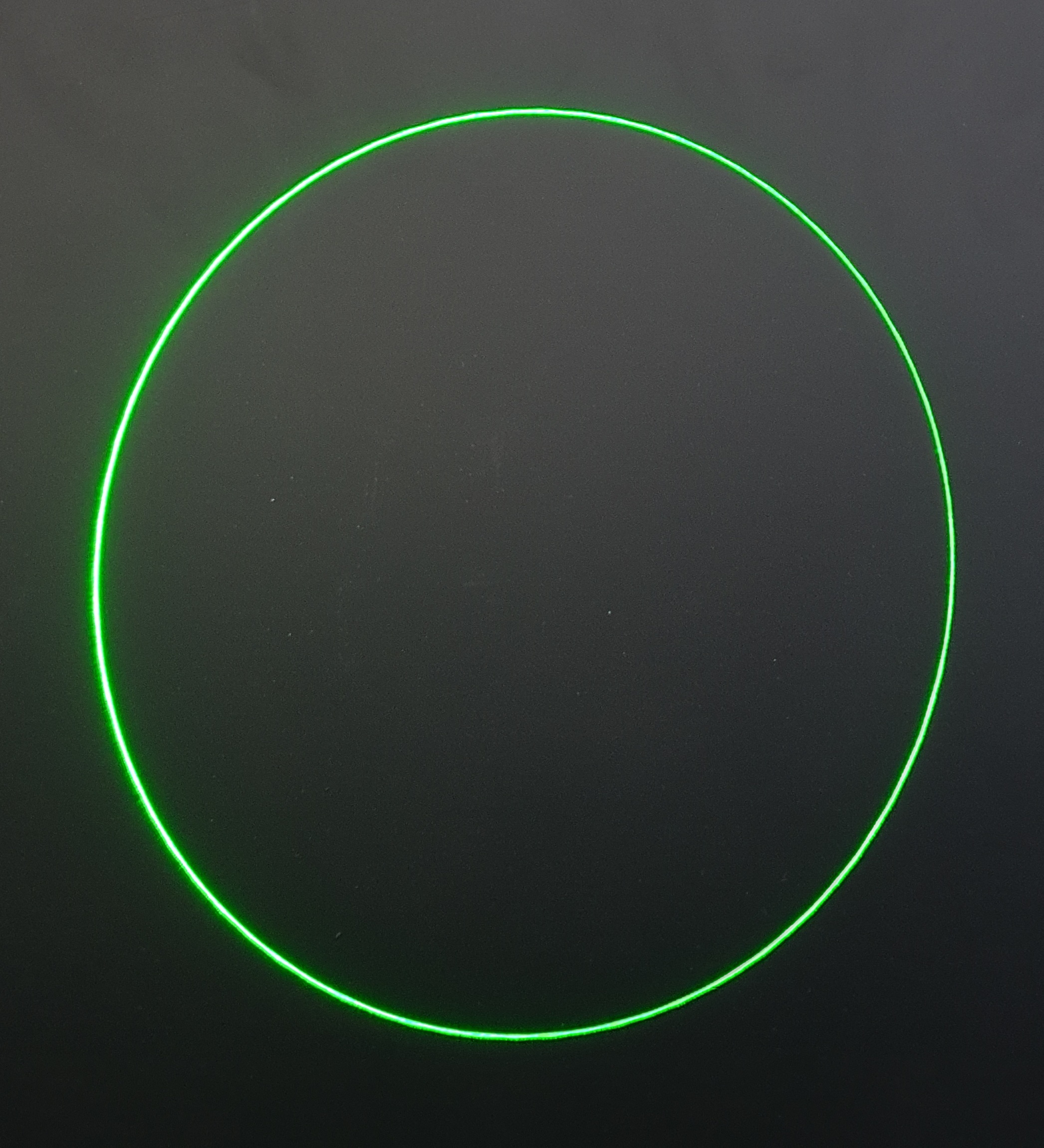

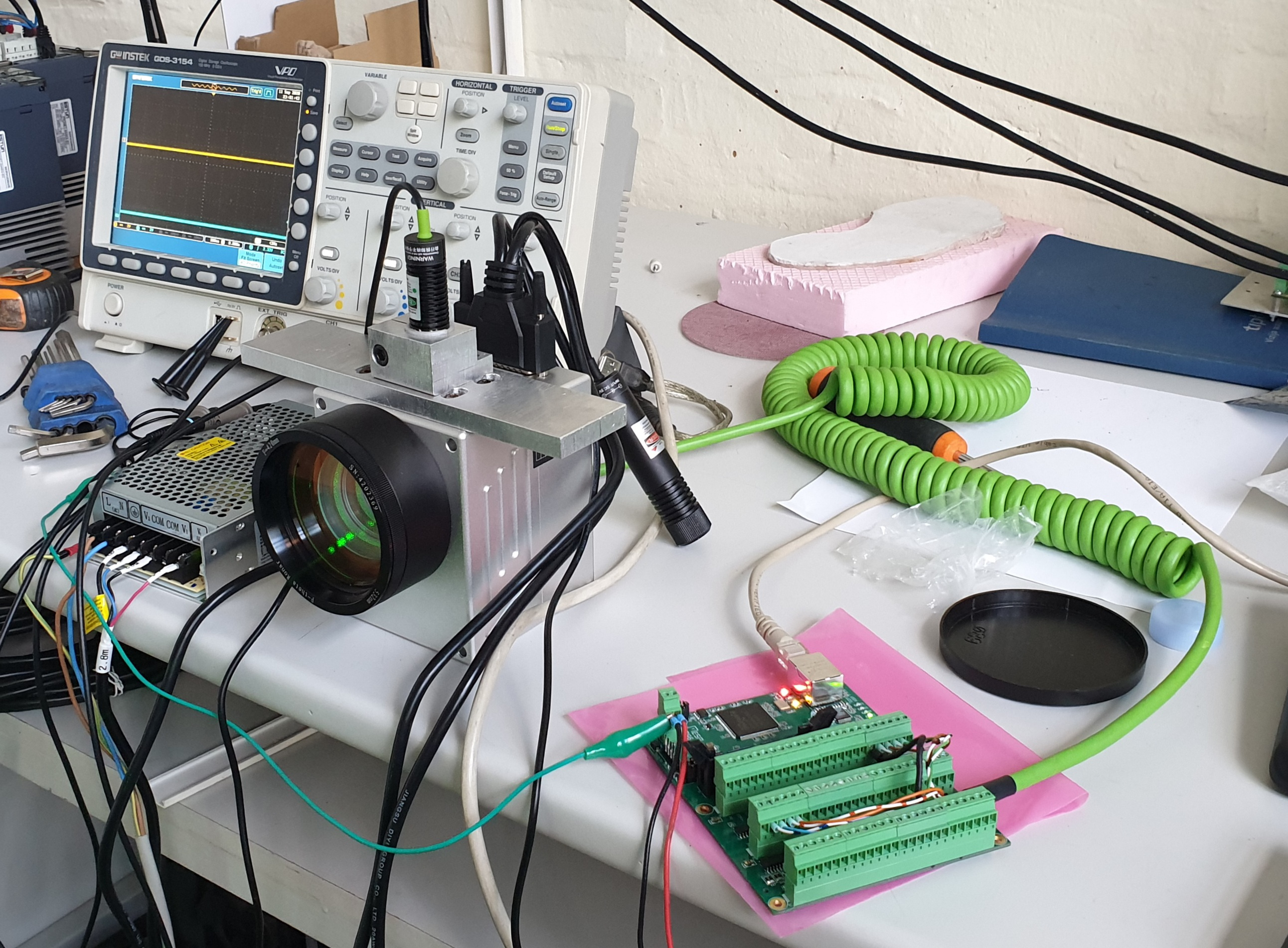

Just a quick report,
I managed to get it working and can definitely confirm that XY2-100 is working with LinuxCNC 2.9 / latest hostmot2! Very special thanks to PCW for all his help.
7i96 produces very stable 2MHZ clock, 100kHz sync, as well as x/y motor signals needed to control the galvo head.
Here is a picture of my testbed:
I made two simple tests in order to investigate the behavior of the galvo interface.

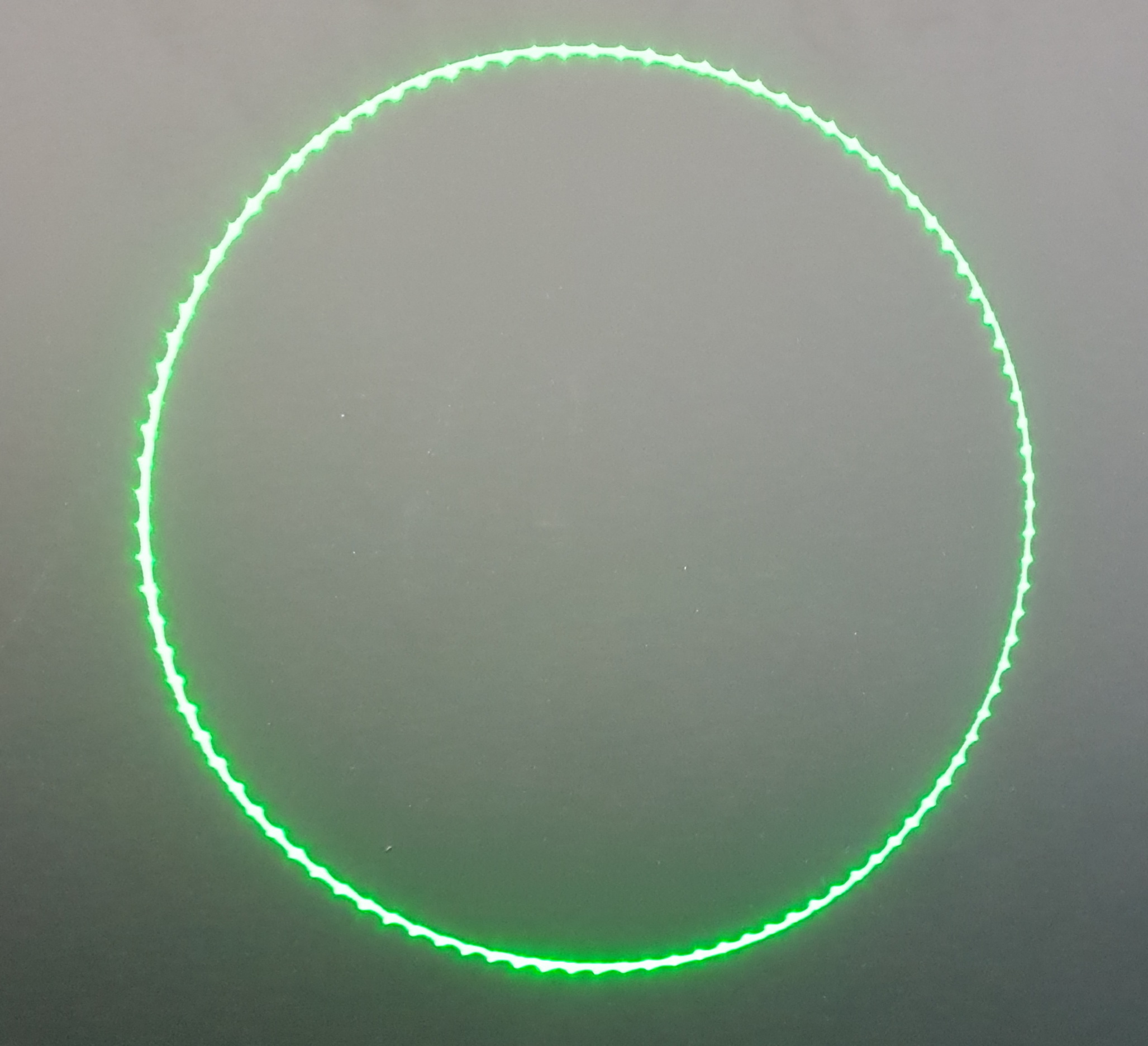

In the first test (7i96-xy2mod-test_circle_pos.hal), sine/cosine signals have been fed to the galvo controller directly as the position reference signals (hm2_7i96.0.xy2mod.00.posx-cmd/hm2_7i96.0.xy2mod.00.posy-cmd). This is much simpler compared to the example configuration provided by PCW in his reply . Results were not so great as the mirrors maintain their previous positions until the new reference position is sent (7i96-xy2mod-test_circle_pos.jpg). It was also not possible to get a nice non-distorded circle at siggen frequencies above 15Hz.
In the second test, sine/cosine signals have first been fed to the PID controllers, whose outputs have than been fed to the galvo controller as velocity references (hm2_7i96.0.xy2mod.00.velx-cmd/hm2_7i96.0.xy2mod.00.vely-cmd). PID gains where manually tuned to get minimal following errors. This approach yielded much better results. I was able to get almost perfect circle at siggen frequencies even above 30 HZ.
The only modification that needed to be made the PCW's example (hm2-pidstepper-master-pexy100.hal from 7i96_xy.zip) was to replace the linewith:
Regards,
T
setp hm2_[HOSTMOT2](BOARD).0.xy2mod.timer-number 1setp hm2_7i96.0.xy2mod.read-timer-number 1
setp hm2_7i96.0.xy2mod.write-timer-number 1Regards,
T

Yes, its expected that velocity mode will be used, since this will result in constant velocity
(linear) interpolation between waypoints. This interpolation runs at the serial update rate (100 KHz)
Actually you can go a step further and have parabolic interpolation by connecting the acceleration pins,
but I don't know if LinuxCNCs acceleration values are properly synchronized.
The separation of read and write times is to allow the write time to be less that a full cycle late
as you have now (by using a separate DPLL timer for write with some positive offset)
Note that if you leave the hm2_7i96.0.xy2mod.write-timer-number pin unset, the writes will happen
as soon as the 7I96 receives the write packet (therefore with minimum delay but more jitter)
This may be a better compromise
