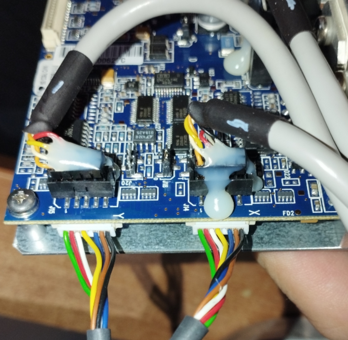

I have a galvo scanner without documentation.
How can verify if it is xy2-100.
Also how can identify what is each wire from 7 wires has for each axis?

Replied by PCW on topic LinuxCNC support for XY2-100 interface using xy2mod and hostmot2 firmware
I would expect a XY100 interface to have 8 or 9 wires total for both X and Y
X Data +
X Data -
Y Data +
Y Data -
Clock +
Clock -
Sync+
Sync -
Status
The 7 pin connections look more like an analog interface, maybe
directly to the coils

04 Dec 2023 14:27 - 04 Dec 2023 14:54 #287191
by vre
Replied by vre on topic LinuxCNC support for XY2-100 interface using xy2mod and hostmot2 firmware
Scanner has manufacturing year 2016 (analog scanners usually are before 2004)
The galvo driver pcb it is the same as this
www.ebay.com/itm/264285622376
seems to be made by novantaphotonics/cambridge technology (product code 1‐002‐3006170 )
novantaphotonics.com/wp-content/uploads/...tus-February-2022.pd
Label outside of scanner writes voltage +-15V.
The interface has 7 wires for X and 7 For Y (7 wires for each axis)
So can this be?
X Data + / X Data - / Clock + / Clock - / Sync+ /Sync - / Status
and
Y Data + / Y Data - / Clock + / Clock - / Sync+ / Sync - / Status
or
(without differential signals)
-15V / GND / +15V / X Data / Clock / Sync / Status
and
-15V / GND / +15V / Y Data / Clock / Sync / Status
So can this be?
and
or
and
Last edit: 04 Dec 2023 14:54 by vre.

04 Dec 2023 17:29 #287206
I don't think so, XY2-100 combines X and Y so that is not a match
The +-15V suggests an analog interface

I have send email to novantaphotonics for manual they answered me with the manual of galvo scanner.
It is analog..
Can use this galvo interface with linuxcnc ?
Which mesa card is suitable ?
It is analog..
