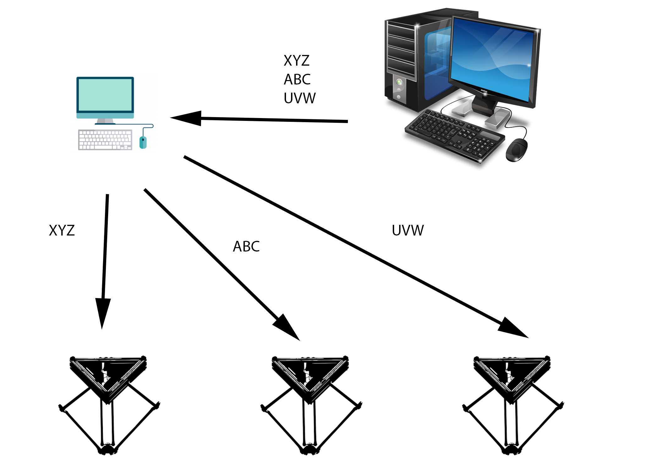

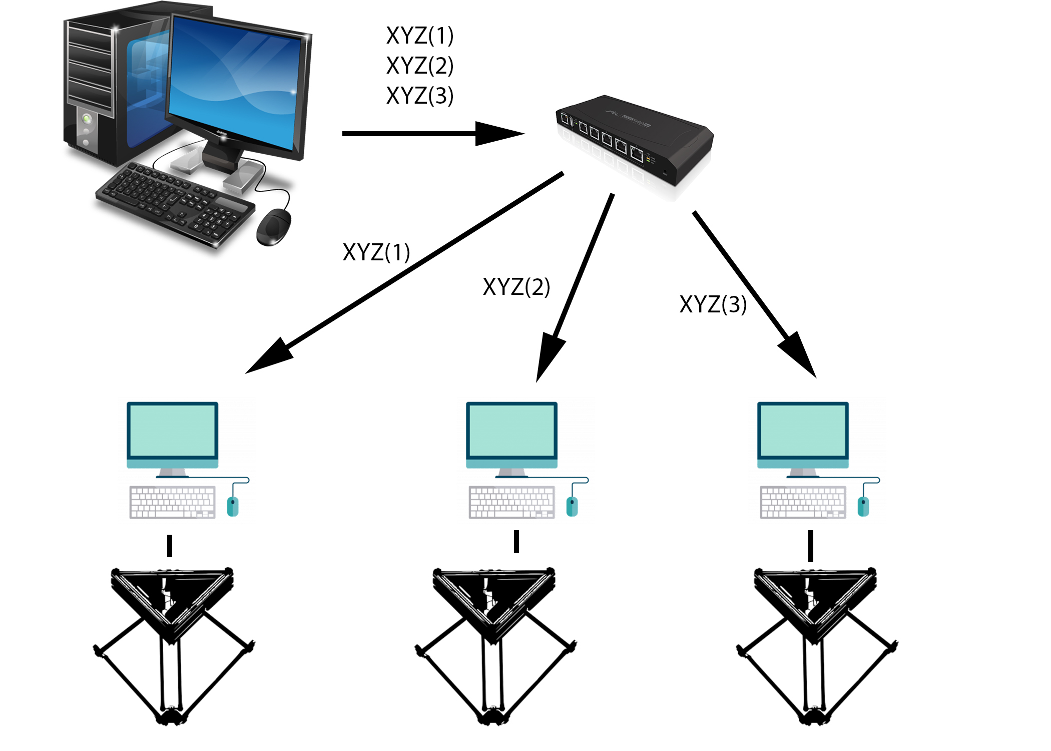

I am using standard g-code. Now I have one main computer that sends commands (Linuxcncrsh) to slave computer(robot) by classic Ethernet (pic1). I want linuxcnc with new modified kinematics (let's call it rotarydeltakins3) to work like picture2.
I don't need knowledge of ethercat sources and various CAD systems (Opencascade and etc). But to understand the source code of Linuxcnc is useful!

Now I can use one delta robot (XYZ) and the rest of the ABCUVW axes will be simple linear or angular.
I imagine that the * .ini file will look like this.
If there are simpler options how to achieve this, I am all in the attention

Until now i don't understand exactly what would be different to the existing lcnc setup.
If i look at picture 2. I imagine you want one single kinematics file that procudes the ouput of 3 kinematics file's?
Like ->
robot 1 xyz
robot 2 abc
robot 3 uvw
Or do you need a hal wrapper that clones gcode for the other 2 robots in the cascade?
Do do robot's work as clone's or can they be controlled independend? Or would you be it like that?
Like ->
robot 1 xyz
robot 2 abc
robot 3 uvw

Independend. Each robot moves differently.
- Grotius
- Posts: 2419
- Thank you received: 2349
30 Oct 2020 11:23 #187782
by Grotius
Replied by Grotius on topic Double or Triple Rotarydeltakins on Ethercat
Ahh clear.
If your 3 robots move independent, you don't want to use one g-code intepreter for 3 robots.
If one robot's has to be paused, you must pause the whole cascade.
So if you could hack lcnc to start up 3 times on one pc, you would be happy?
