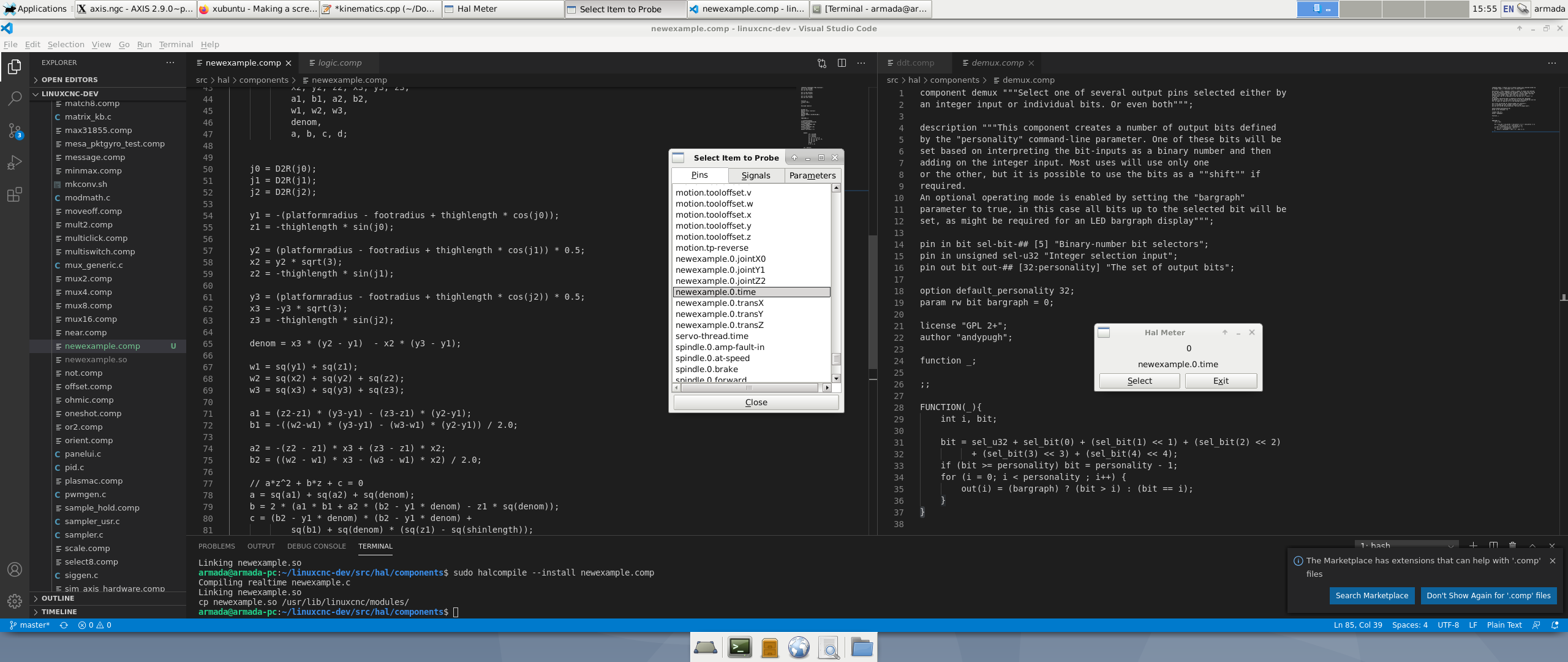

Can you tell me. This is the first time I’m doing this and therefore will be asking a bunch of stupid questions.
For begin, I did this file and compile. Am I acting in the right direction?
And what is the "time" variable?

Replied by Grotius on topic Double or Triple Rotarydeltakins on Ethercat
It's starting to look oke.
Try to get your static variables outside the function. Look at other components if it's possible.
Your robot arm lenghts could be done as float input from outside the component. This make's your component more dynamic.
If you want to know the time. You can do a compile to c code. Try that. The output is more difficult to read, but it give's you an idea what's actually happening behind the scene's.
At first sight. It looks oke. Nice work so far ! I am happy for you !
One thing i thought about.
You can actually make a component for 3 robots. Or make one component for one robot and load it 3 times with a variant name.
Loading multiple threat's can become an advantage if the xyzabcuvw mdi is chucked up in 3 seperate mdi commands. But first try it simple.

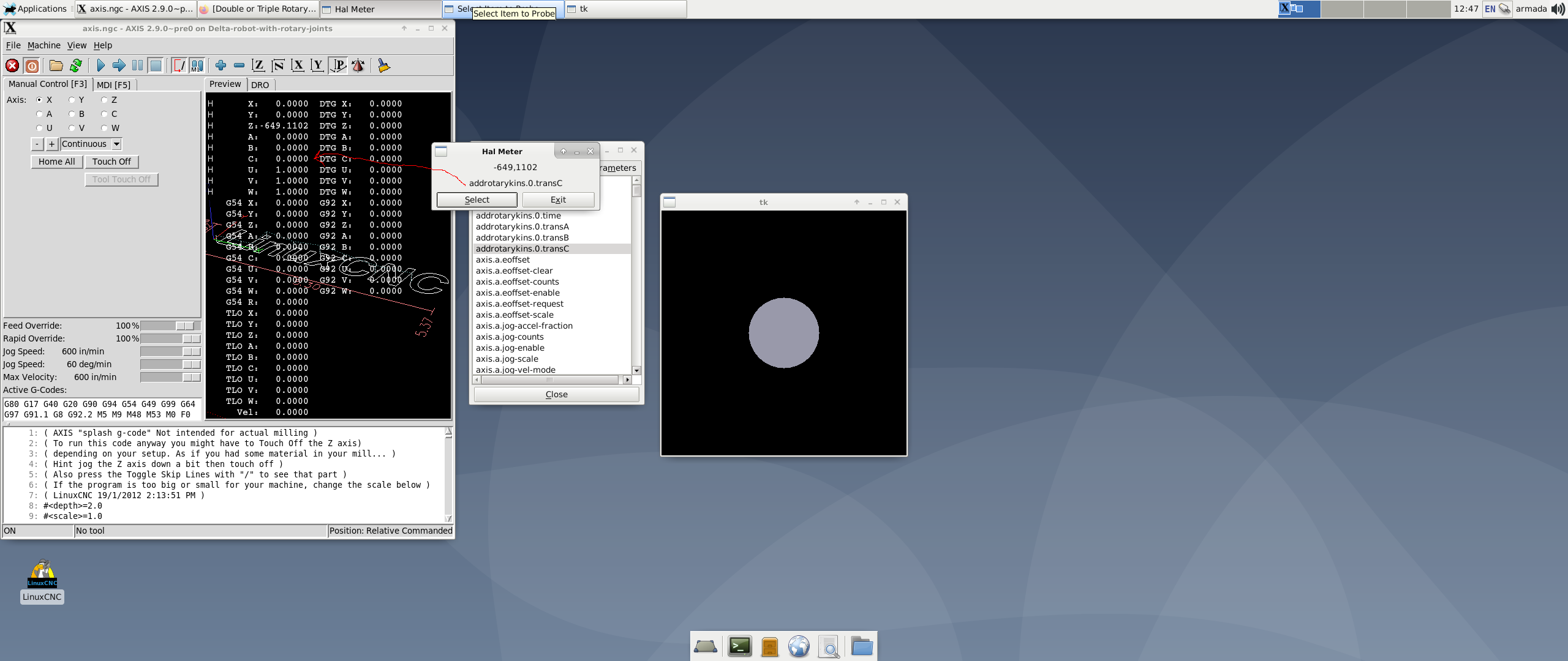

I can force data to be put into the "axis.a.pos-cmd" variable.
I can't do
axis.a.pos-cmd: = addrotarykins.0.transA.
Can I in *.comp how to refer to axis.a.pos-cmd bypassing the source code?
I can't do
I can't do
You only connect your comp in the postgui.hal file by the net commands. Comp's are loaded at last, after all hal files are loaded.
You can test you component with halshow to make a dummy connection. Then you can monitor your output and what is happening and if it's working at certain levels. Try this !
I can't do

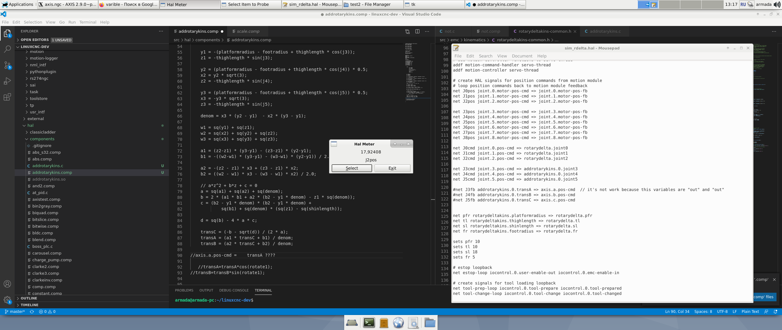

I don't quite understand why I need postgui.hal in this case.
I am getting the correct transA, transB and transC variables. But I cannot link them to axis.a.pos-cmd. Because the values axis.a.pos-cmd and * transA are output. i can't find a variable which is the input for axis.a.pos-cmd.
In rotarydeltakins this input varibles is rotarydelta.joint(0/1/2) and output is axis.(x/y/z).pos-cmd. And it works both ways,isn't it?

Your component output can be connected to the ethercat motor controller.
You have to look if you want to add the stepgen before or after the component.

How can I assign my variable to a linuxcnc variable?
by ethercat I send only joint position!

The component joint output is your ethercat joint position, these should be connected trough a net command.

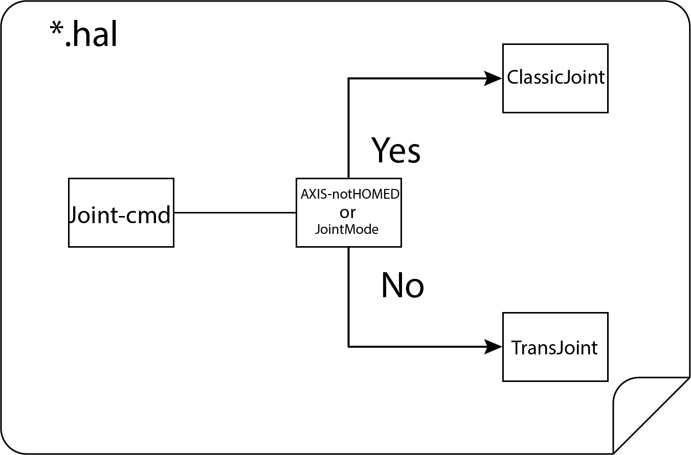

Good day.
I figured it out. I had to use the formulas from the inverted kinematics. Can you give any example of how I can use the "if" function or analog in a hal file? I want to make a condition that if the robot is not crazy -> work in classic joint
else work in transJoint.

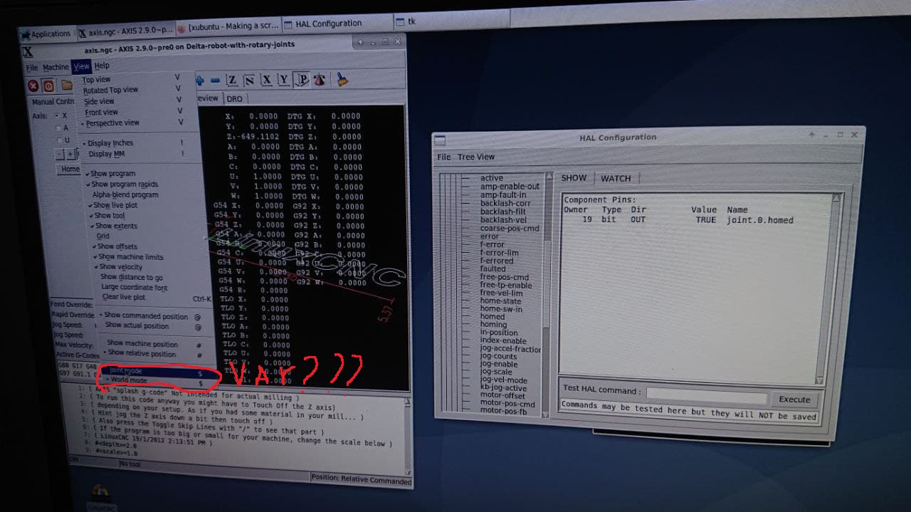

And Can you tell me if the variable in hal knows whether I'm working in World mode or Joint mode?
upd I find var halui.mode.is-joint)
PS Printscreen not work. I'm too lazy to figure it out
