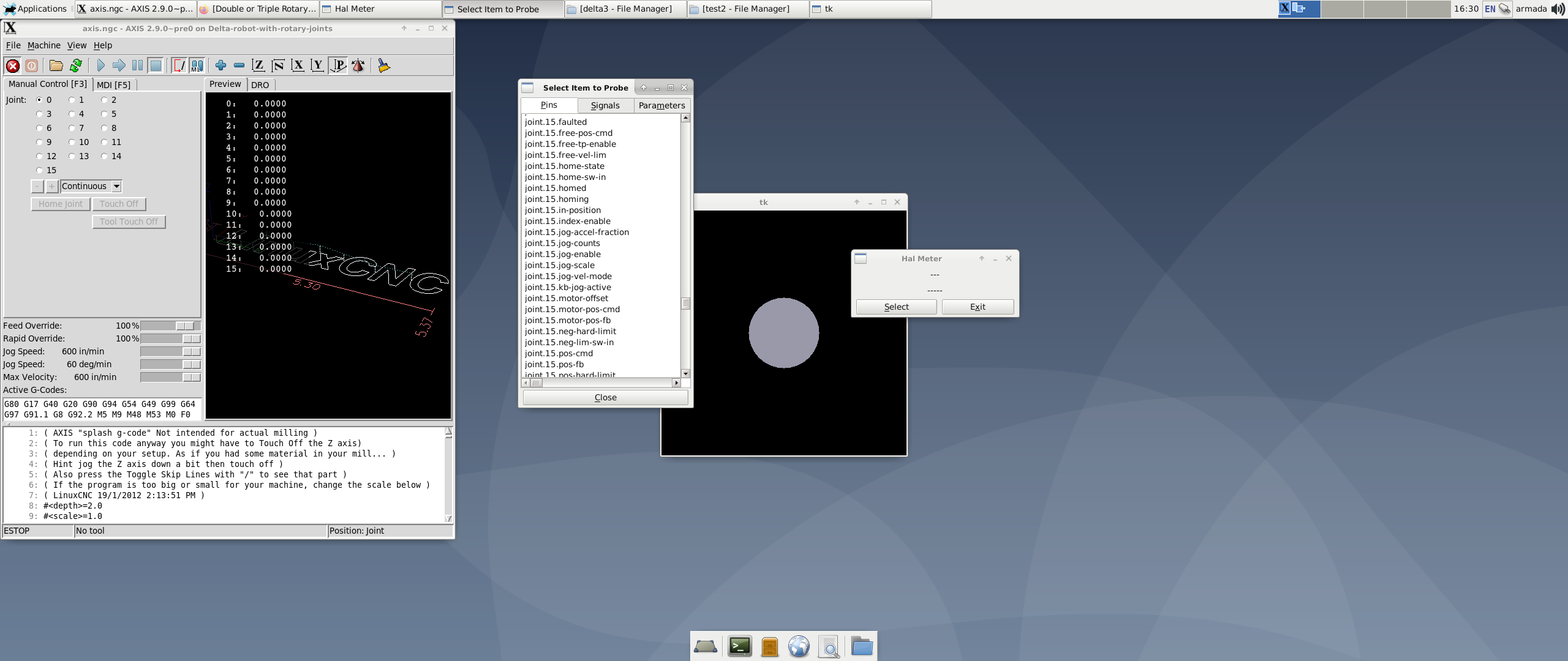

27 Nov 2020 13:26 - 27 Nov 2020 14:22 #190437
by TheRoslyak
Replied by TheRoslyak on topic Double or Triple Rotarydeltakins on Ethercat
I did it. It's work
The questions are as follows:
1 Now It works in linear move. Can I simulate circular movements or G64 in hal files?
2 I find 16 joint (0-15pcs). In theory, I could manage them. But RSH is not suitable for this, because there are no free letters:)
How can I use them independently? May be New HAL or any else?
3 In general, it would be nice. Make a new application based on Linuxcnc source. Why did you give up the idea of "STUXNET_Cascade". I still don't understand this new app or plugin for Linuxcnc.
PS I have a lot of ideas and solutions, but I will discuss. I'm waiting for a dialogue

27 Nov 2020 14:30 #190444
by Grotius
Replied by Grotius on topic Double or Triple Rotarydeltakins on Ethercat
@TheRoslyak,
I did it. It's work
Congratulations !!
1. IF your server pc is sending a mdi command like g1 it will do lineair. if the command is g2/g3 it will do circulair.
Sinds we use the basic lineair kinematics i think it will only interpolate the xyz for a circle g2/g3.
I think abcuvw will be executed as a g1. Splitting up mdi commands will only help if you load 3 seperate motion planners. But that's not allowed i think. G64 wiil also work for xyz. I don't know what it will do with the rest.
2. Can you look into the RSH source code? Maybe it's easy to add a few letters to it. With RSH you mean remote server trough telnet?
If you give me the filename+file-location i can take a look for you.
3.In general, it would be nice. Make a new application based on Linuxcnc source. Why did you give up the idea of "STUXNET_Cascade".
Haha. I don't give up this idea, there is more potential for this. On the forum there is a second example : an 2 headed lathe,
that can use this app too.
If you check this . This app has a automated kinematic chain solver, it's usable for robot's, gantry's etc.
It's designed to work with multi realtime threads for motion. It can read multiple gcode's.
At the moment i tested it with lcnc as single thread motion planner.
But in the near future i must integrate a non-lcnc motion planner. Then it has the power you operate a cascade of robots independently.

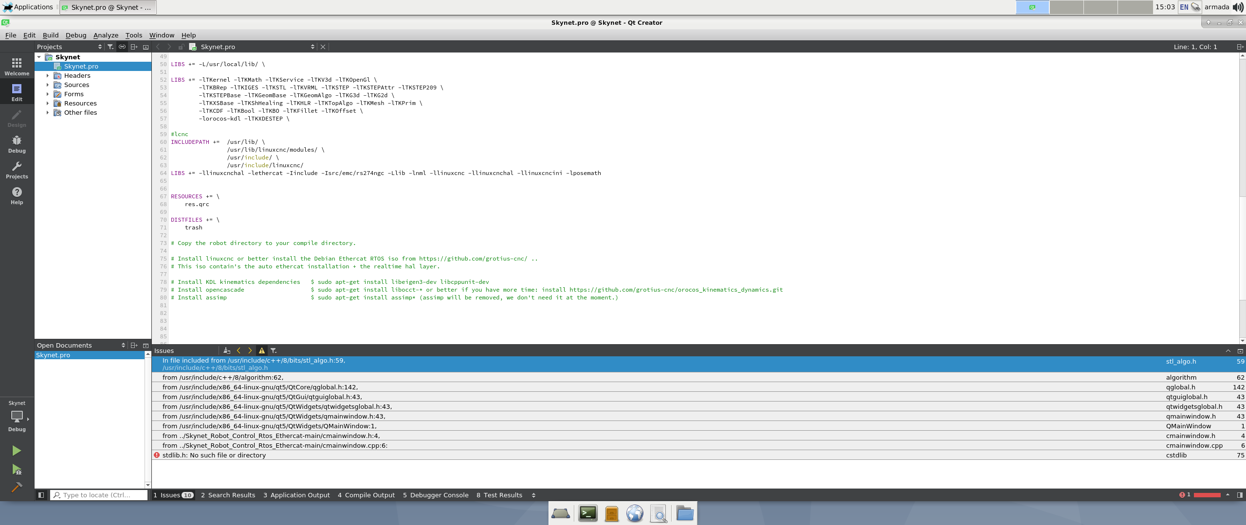

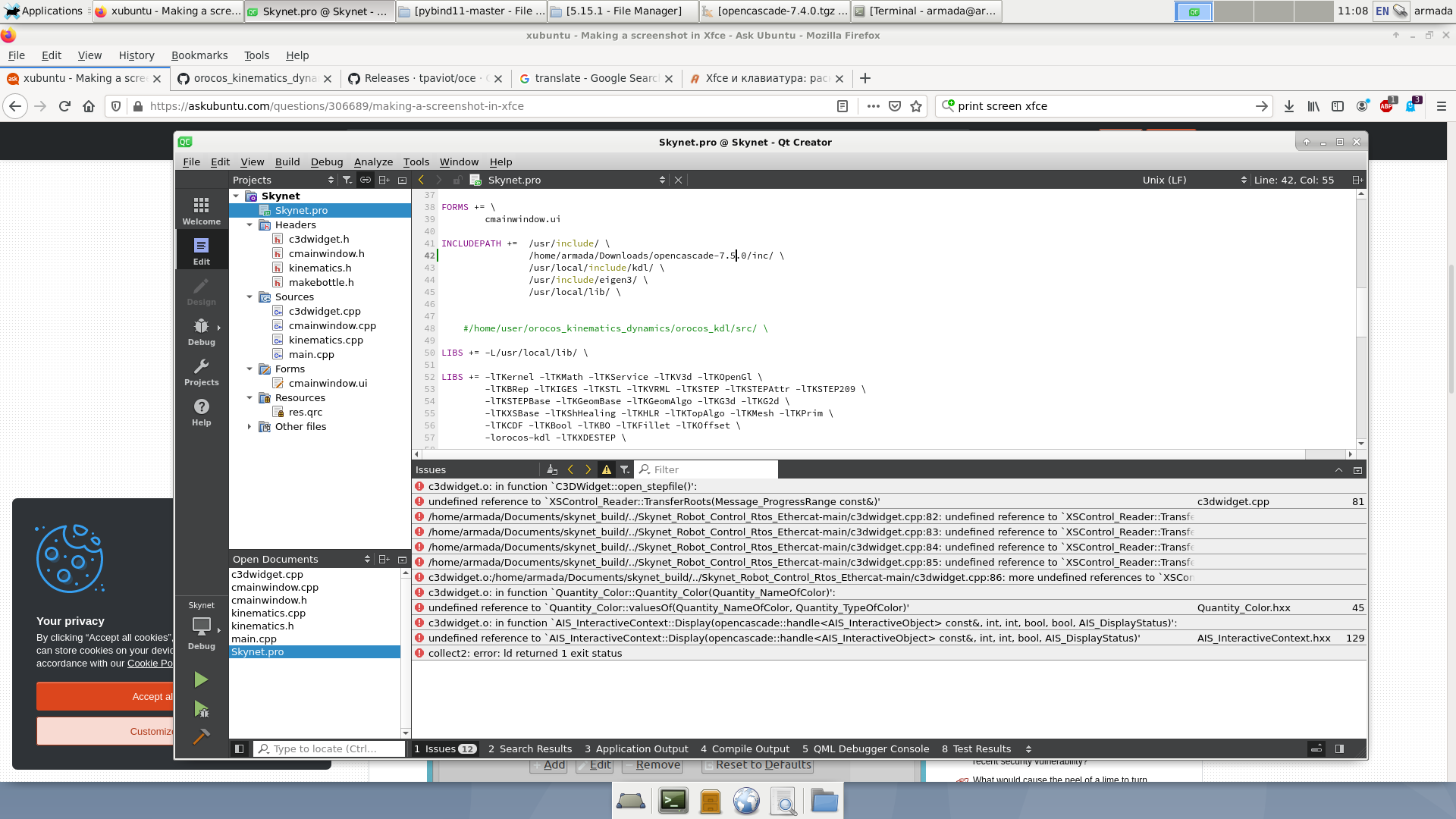

28 Nov 2020 19:01 - 30 Nov 2020 13:01 #190540
by TheRoslyak
In general, I think to forget about Linuxcnc. And start to make own application together.
Next week I will start exploring your application. There aren't many files there, yet
Could you prepare a tutorial for installation "Skynet" and corectly install qt creator (because I couldn't install correctly on Lunux
) and any else aps.
Upd What you need to install or do to set up the project correctly.
pic 1 When I used qt5. Can get advise? I think problem connect with gcc but I don't know how to fix
