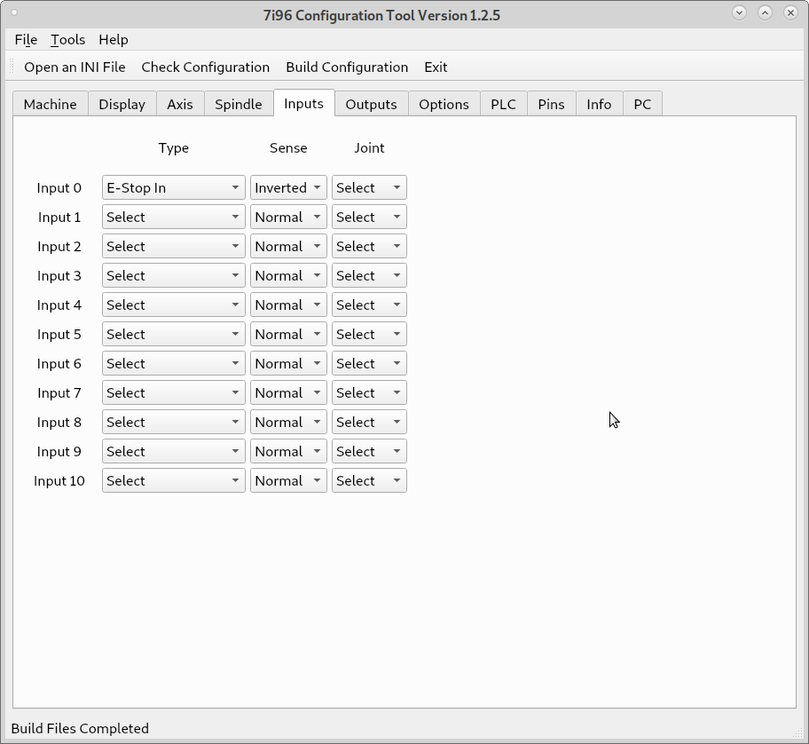

I've added stepgens, encoders and pwms by firmware selected and if a pwm is present enabled the spindle pwm.
Current version is 1.2.4

I just pushed a new deb with a couple of fixes and a better check for mesaflash and the correct version of python.
JT

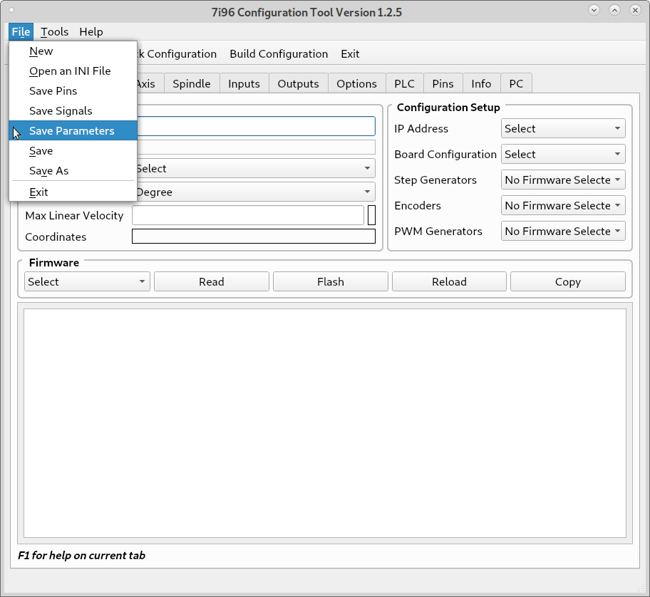

I've added menu items to get a list of pins, parameters and signals and save them in the configuration directory. Makes editing the hal files easier when you can copy and past pins and parameters. I'm also reworking the deb at the moment and should have all this uploaded today. The new version is 1.2.5.
JT
