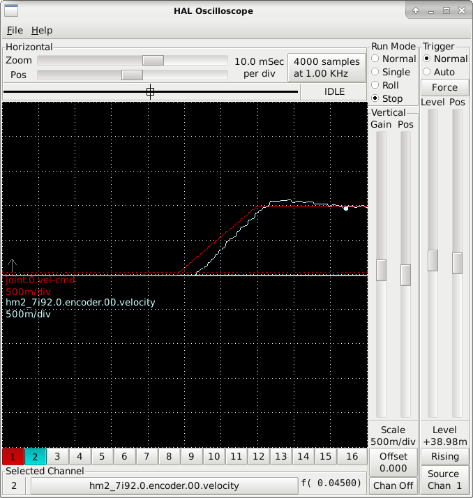

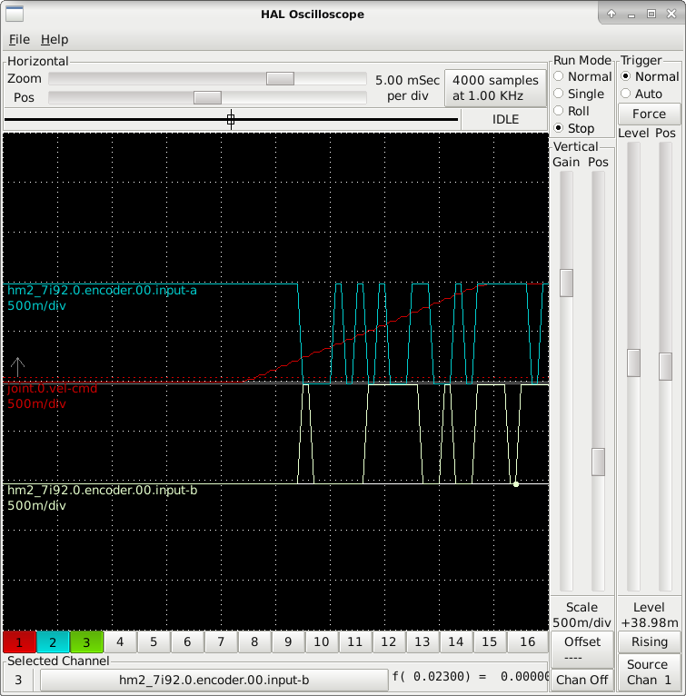

20 Feb 2021 23:27 #199571
by Michael
I hooked up the encoders in position mode and they still have a delay in response that can be seen in either of the attached pictures. If I use position mode will this also effect the ability to close the loop with linuxcnc and run consistently? If it does this only leave me the options to use different servos (+$$$) or to try a linear scale on each axis (+$$)
Replied by Michael on topic Running servos in position mode instead of analog
An interesting question is whether the 5 ms delay is present in position mode as well.
Connecting the encoders could answer this. This delay might cause issues with spindle
synced motion like rigid tapping.
This brings up a general observation, your errors are not huge, in fact you may have
never noticed them when machining and similar errors may also exist in step/dir
position mode.
A similar situation happens when people add linear encoders and discover all
the backlash and stick-slip errors that they had never noticed before.
Does the overcurrent alarm go away if you reduce the acceleration?
(200 IPS/S is likely beyond what the motors can do with a high inertial load)

20 Feb 2021 23:52 #199572
by jmelson
Replied by jmelson on topic Running servos in position mode instead of analog
I think a 5 ms delay between command and feedback from the encoder is going to make PID tuning pretty difficult. That's a 5 servo period delay.

21 Feb 2021 09:47 - 21 Feb 2021 09:50 #199588
by arvidb
Edit: I'm thinking in EtherCAT terms now, where the position is sent directly to the servo drives. If you use e.g. Mesa cards as stepgens to generate step/dir signals, then you're still running in a kind of velocity mode I guess? So you might still have problems.
Replied by arvidb on topic Running servos in position mode instead of analog
If you run position mode there should be no loop to close with LinuxCNC? Well, I guess rigid tapping could suffer a bit? Also you might need to increase following error tolerance somewhat.I hooked up the encoders in position mode and they still have a delay in response that can be seen in either of the attached pictures. If I use position mode will this also effect the ability to close the loop with linuxcnc and run consistently? If it does this only leave me the options to use different servos (+$$$) or to try a linear scale on each axis (+$$)
