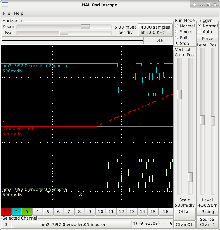

I was able to get the spindle encoder mounted onto the shaft of the z axis to see the difference in delays. The seconder encoder is a Heidenhain and I mounted it in a pretty crappy way since it was temporary, thei may have allowed for some slope in the setup but it still out performed the DMM in response time.
The top line is the DMM drive encoder output
The middle line is velocity command
The bottom line is heidenhain

Not to dig up an old thread but tommylight had mentioned this to me in another thread where he mentions a 5ms delay in the analog input of the DMM drive. From that halscope picture comparing the Heidenhain encoder feedback to the analog command there's about a 2ms delay between the analog command and the time the Heidenhain is read back with a movement. It looks like there's a 3ms delay in the difference between the Heidenhain and the DMM's encoder output.
So what I'm getting from that whole thing is the time from the analog command to the 7i92 being able to read any change is actually 2ms some of that is obviously a read/write delay but it looks like the major delay is actually the extra 3ms from the DMM's encoder output.
I'm guessing this is a bigger deal with analog velocity control on the servo vs S+D position control. I'd be curios to know this actually stacks up against some other servo setup in the same scenario.

Yes it became a pretty big deal as the servo drive would try and make up for this delay and which would result in the drive faulting out. They work fine in S+D but there is no feedback to the control.
I would like to eventually setup some basic ability for Linux to read the encoder feedback for the purposes of homing on index. I have also looked at trying Delta servos but the project has stalled recently. Hopefully this spring I can get it over the finish line and have a working system.

I did do that when I was swapping from velocity to position. I still have the encoders hooked up to a 7i77 as I would like to use the index signal at some point. The delay was still there. Not sure if I have a screenshot saved to the machine. Other projects have pulled me away from finishing that one.

DYN4 uses a 17bit encoder which is basically 131072 PPR. If you set it to 1000 PPR output then it has to actually figure out what and when to send to the encoder output. As I showed you in the other thread, the DMM guy sent me a scope pic of a 1ms delay, that sounds reasonable for an emulated output considering the motor actually has to start moving first.
For one, using halscope is not the greatest way to check this, it's easily done via an actual scope. For two you might ask how it compares to other servo drives of this class because if it's somewhere about the same then you have to ask "why can't my LinuxCNC setup handle this properly"

It's great he sent you a picture of a 1ms delay. But he told me the same thing. And when I asked why it's 5ms he could only point fingers at Linuxcnc but couldn't articulate any particular thing to look at that caused the delay.
Plenty of other setups use Linuxcnc and a 7i77 board but don't have this issue. I couldn't find a single example of someone using DMM with accurate encoder feedback. The only ones I found were using galil controllers and they used filters to remove the delays they were getting back from the encoder section.
And regardless of using a scope or not the servos would over current fault attempting to catch up to their commanded speed .I could never get them to run full speed in velocity mode with a closed loop.
You have to ask yourself "why is no one else having the same issue running Linuxcnc and servos in closed loop". Maybe the issue is with DMM servos not being well built.
