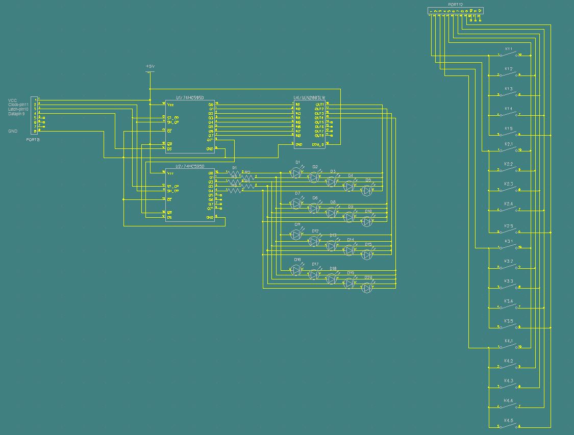

07 Feb 2021 10:58 #197906
by tecno
Replied by tecno on topic Add a second 7i73
This is what I have now on my 7i73
This is what I need = change from mode 1 to mode 2
1 MPG (2 inputs)
1 LCD 2x16 (7 pins ?)
2 11-pos switches analog (2 inputs)
1 E-stop (1 input)
following matrix schematics, 4 rows 5 columns keys and ditto LED's for each key
keys 4 inputs 5 outputs, Leds 3-pins
Looking forward to see if this can be done.
1 MPG (2 inputs)
1 E-stop (1 input)

- Posts: 11970
- Thank you received: 4079
08 Feb 2021 10:55 #197981
Replied by rodw on topic Add a second 7i73
Why don't you just get something like
this
It does all that you need. Wire into the Mesa MPG and add in the axis selection and scale selectors..
