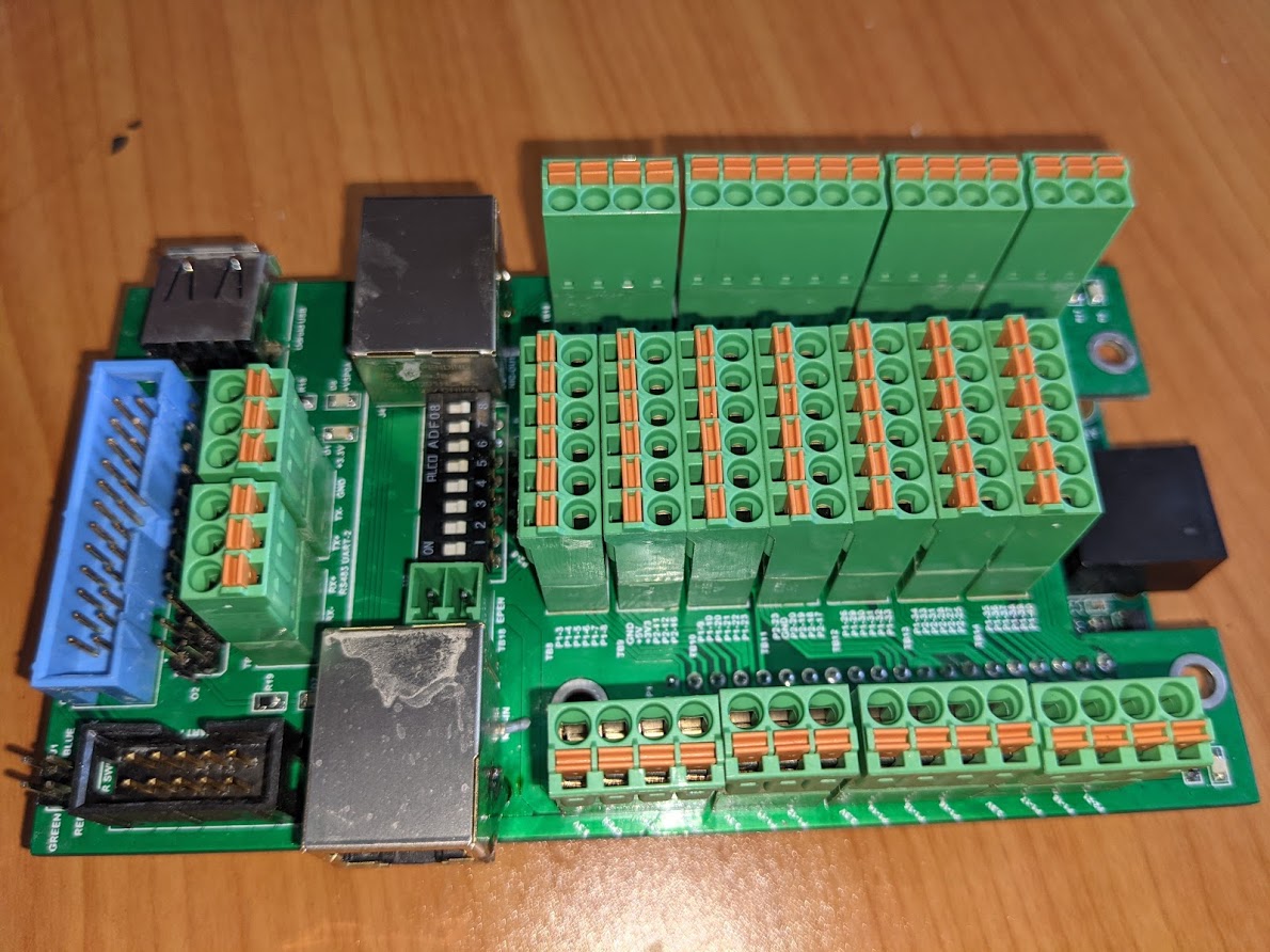

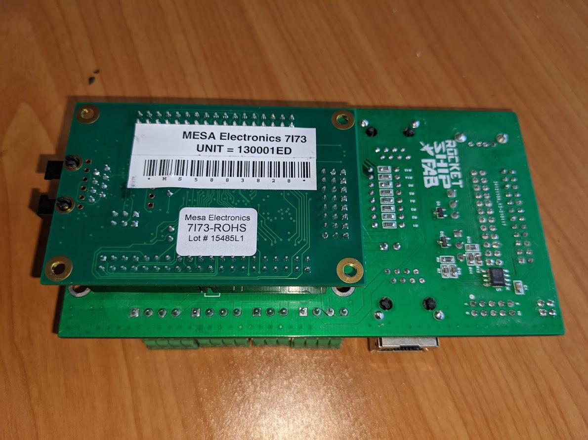

Replied by rodw on topic Add a second 7i73
Yes, I agree. I actually got my first prototype of a 7i73 shield soldered up today but it will be a while before I have all of the hardware to test it out fully.. It will live with the Odroid H2+PC which also plugs into the board.
The RJ45's are there to break out a couple of wires normally used for PoE from the 7i76e ethernet cable to carry the estop.
The board breaks out the Odroid UARTS into a RS485 and a normal DB9 to a header.
I'm hoping my pendant receiver will also hook to the 7i73 too.

nice breakout board
Replied by robertspark on topic Add a second 7i73
nice breakout board

Thanks Robert. And complete with an external estop signal too
nice breakout board
