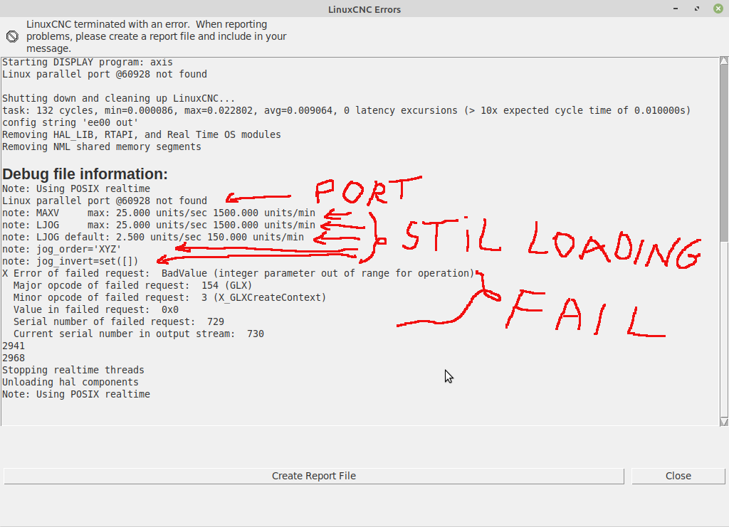

I have run a "blank" stepconfig wizard. Named "my-test".
In the wizard only the name changed, the rest the "basic" settings, then in the hall file the port address changed to "ef00"
The same result, the machine does not start up and displays the error screen.
Also the same with the second address "ee00".
attached "show_errors.txt" the report generated by this error message.
also "my-test.hal" and "my-test.hal"
"Schermafdruk op 2021-03-09 18-02-05.png" is a screenshot of this attempt
The errors you have noticed are probably related to my joy pad.
"myn-cnc.hal" and "myn-cnc.ini" are the files from my original configuration.

Looks like you accidentally pasted the error message into the hal file:
addf motion-command-handler servo-threadinux parallel port @57344 not found

I dont think so, the parallel port message is a just warning (and maybe unimportant)
It looks like the error that stooped LinuxCNC was graphics related

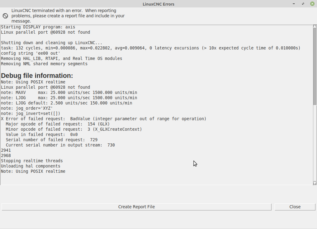

Of course it could, but then it seems to me to be a bug in linuxcnc because when the process is interrupted at startup, for graphical reasons and only the port is reported as an error.
And why is it not listed as a warning or note, but as an error.
For me the botomline remains why does the machine not boot, if this is for graphical reasons how do I fix that.
The graphics card is also a plugged-in version, as recommended.
On the system, other graphics applications, with a much higher resolution than that required by linuxcnc, will run fine.
When viewing the error report, you see
It is reported that the graphical environment is starting up, then the port error is determined and immediately afterwards the shutdown is done.
So the case is stopped not after starting the graphical environment but only after the port error has been determined.
I am a novice in linuxcnc and linux, but I am quite familiar with computers. I am open to explore both avenues.

10 Mar 2021 04:22 #201633
Replied by tommylight on topic Install parallel port
Blaming everything does not help you,
LinuxCNC versions 2.8 and above will start even if there is no parallel port in most cases and report not finding it, so move on to fixing the things that need to be fixed.
The errors related to graphic are due to GL extensions not working, most probably a very old graphic card or one that uses proprietary drivers.
What PC and graphic ?
