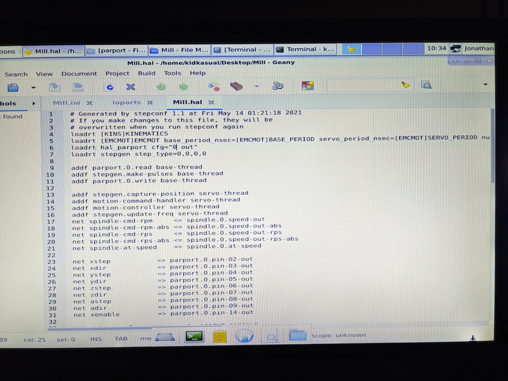

The best way to get help is to attach your Hal & ini files, any error logs/messages and any outputs of the commands you are using to find info about your card.
Supplying actual info is the best place to start.

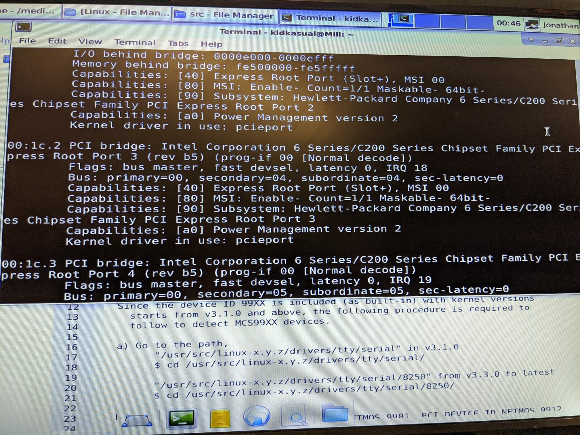

OK, first, I can't IMAGINE why you needed to install Windows 10 to install LinuxCNC.
If you actually plugged in a PCIe card with the motherboard powered on, you may have damaged the PCI bridge chip, which may be why you can't get it to work, now.
If that is not the story, you just unplugged the BOB and plugged back in with power on, then the PC should be OK, now you have replaced the parport card, so the only thing left is the BOB, which could have been damaged.
Linux compatibility has little to do with whether a parallel port will work with LinuxCNC. LinuxCNC does NOT use the generic device drivers for the parallel port, it uses built-in real time drivers.
Every PCI and PCIe card needs to enumerate its port address, and that can change any time any PCI or PCIe card is added or removed. You then have to find the port address for the parallel port card again and tell LinuxCNC what the address is in the .hal file.

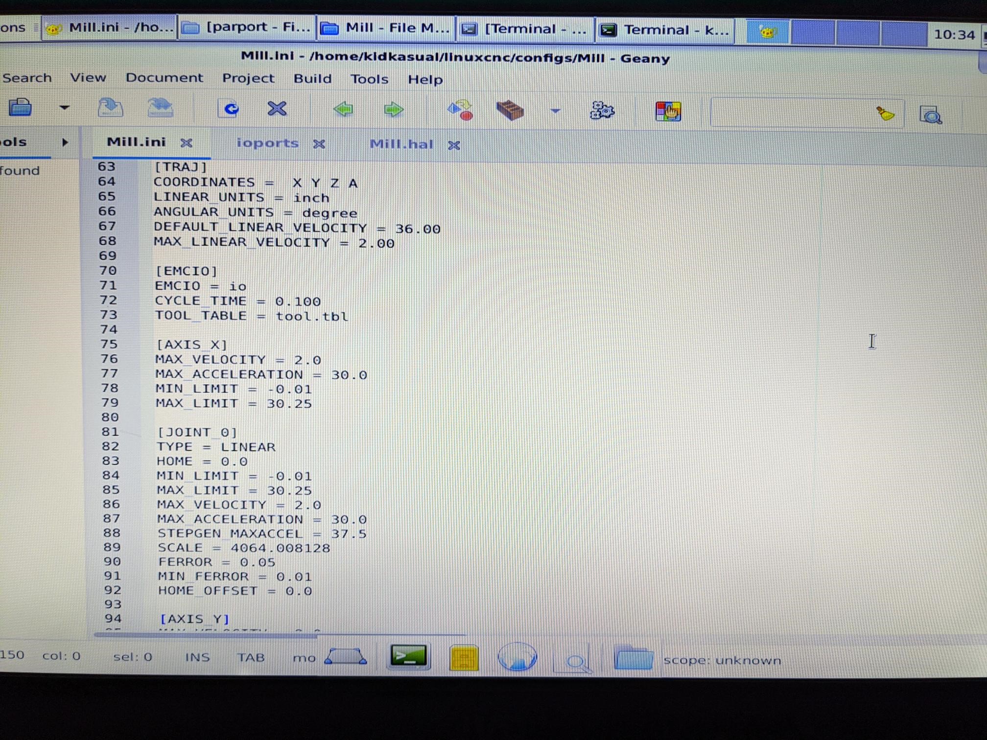

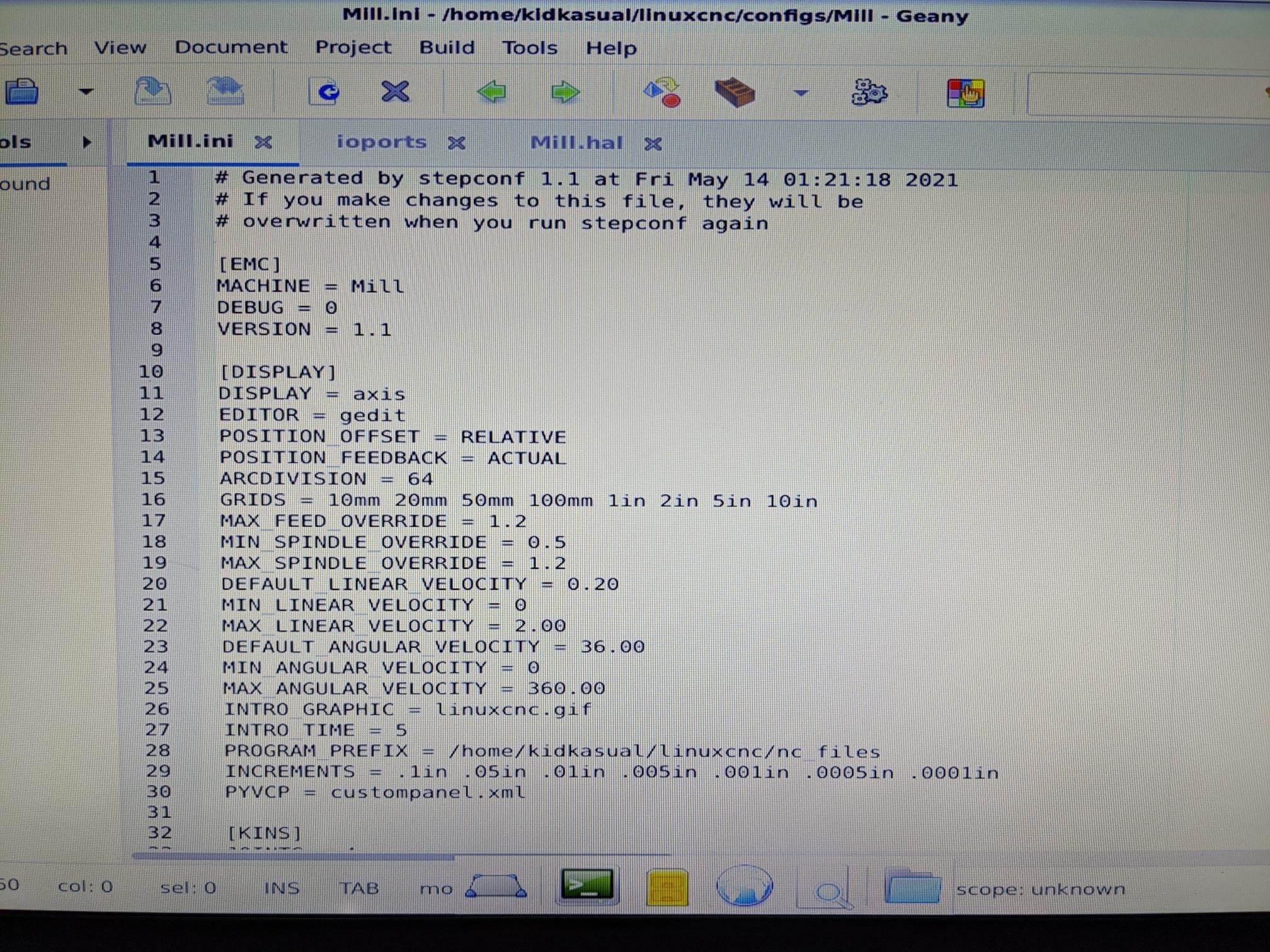

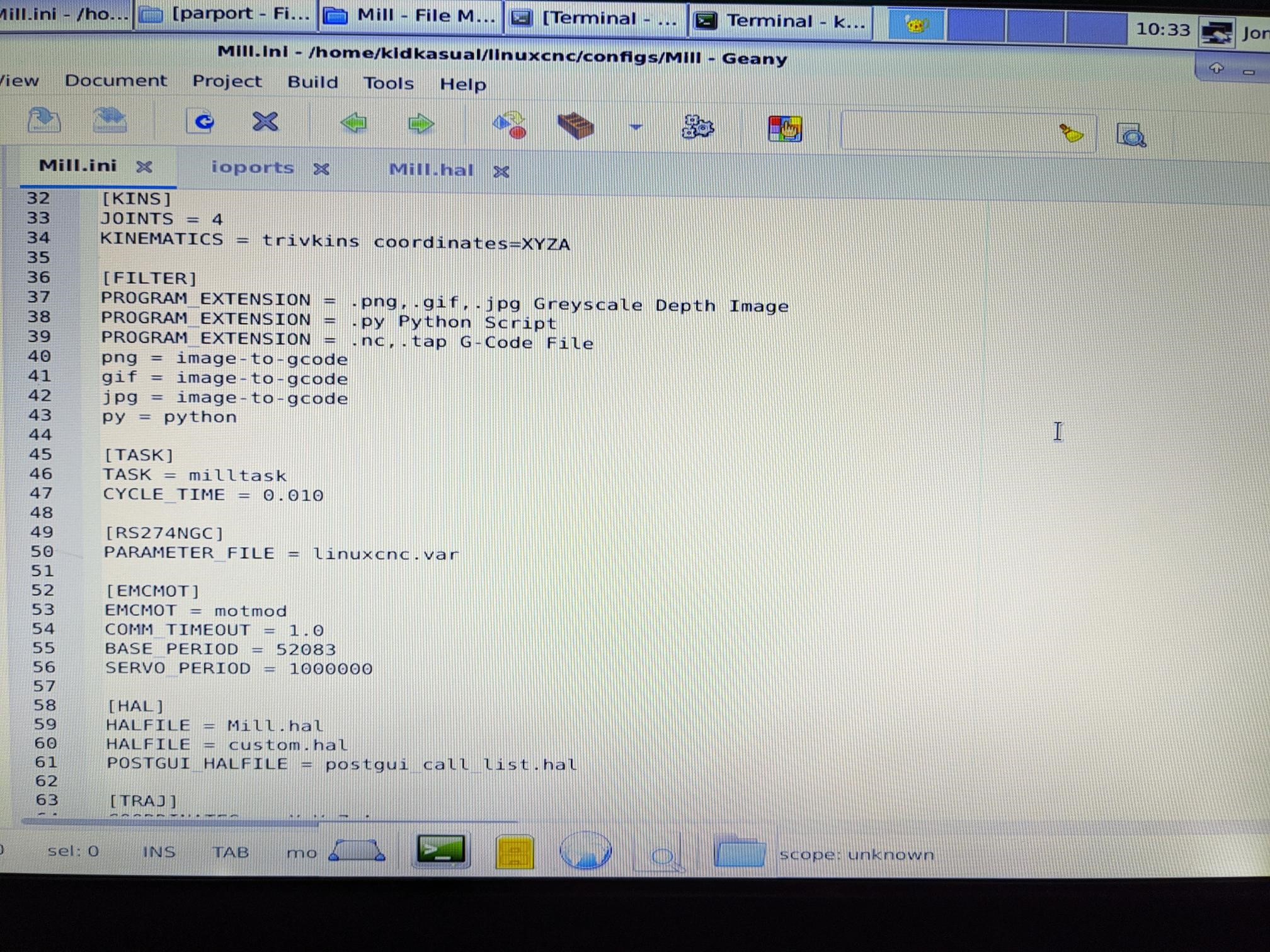

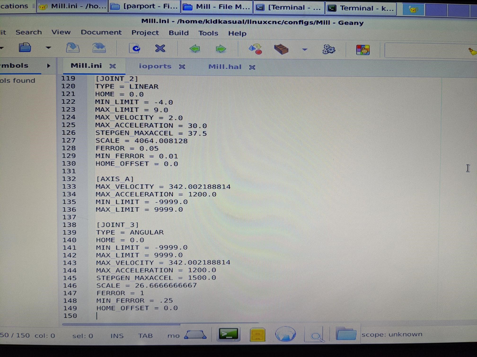

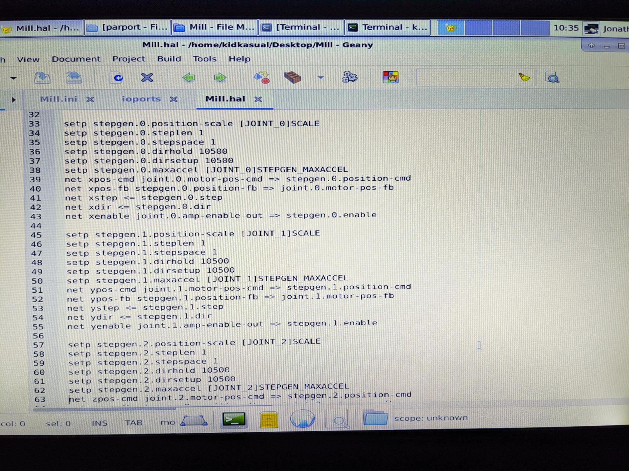

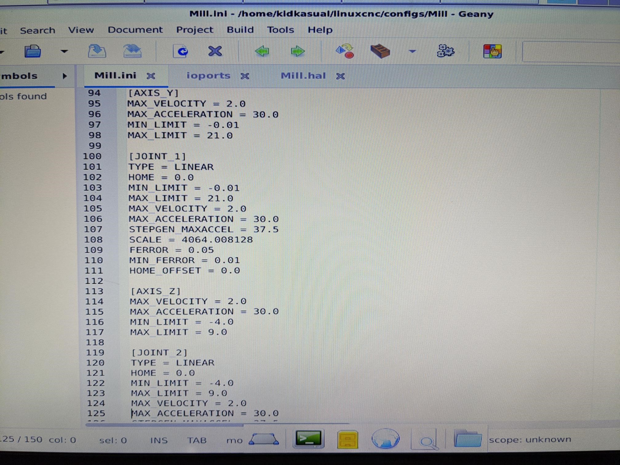

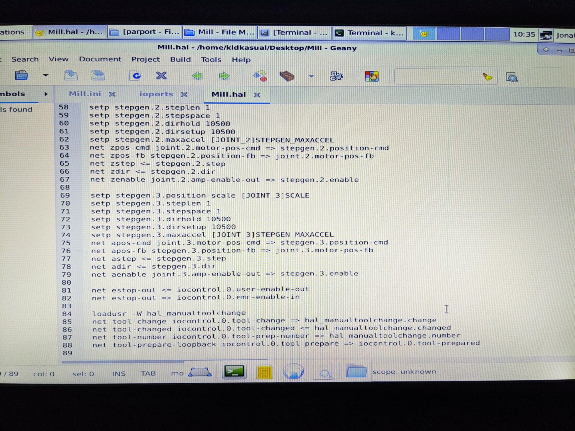

Thank you for the quick reply. Here are the pictures of the files. The first 3 are the HAL. The next 5 are the .ini. Sorry for so many pictures. The computer running Linux is not configured to any network so I cannot email the files. I will send another post with the cat /prco/ioports results after this one.
As for Windows 10, I didn't NEED to install it to run Linux, and honestly, it wasn't me. I was running Windows 7 and when the computer crashed, Best Buy rebooted it with Windows 10, so I just ran with it at that point (either that or they didn't want the liability of installing an unsupported system. My guess would probably be the latter...). I had to reinstall it with the 32 bit system 3 times after Mach 3 did IT'S thing..... yay. go Mach 3..... I understand Linux crashing a computer because it is user-defined open-source software. BE CAREFUL what you do.... But a Windows-based program crashing Windows from boot???.....Bravo....BRAAA--VV--OOOO...... That's a special kind of special..... On to better and more meaningful things....

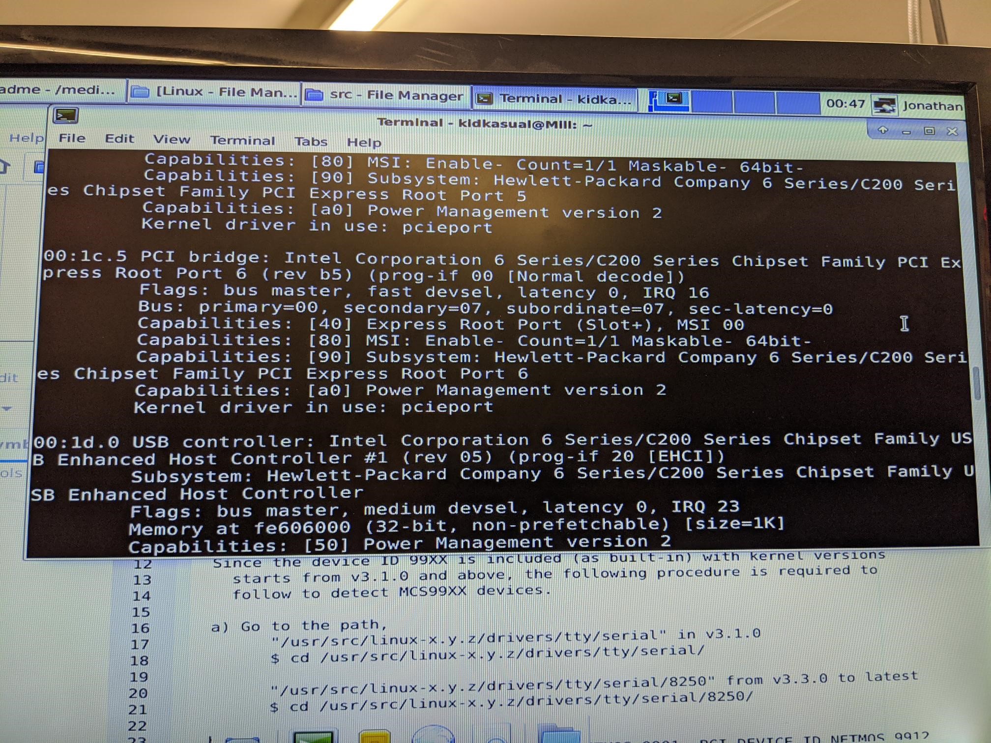

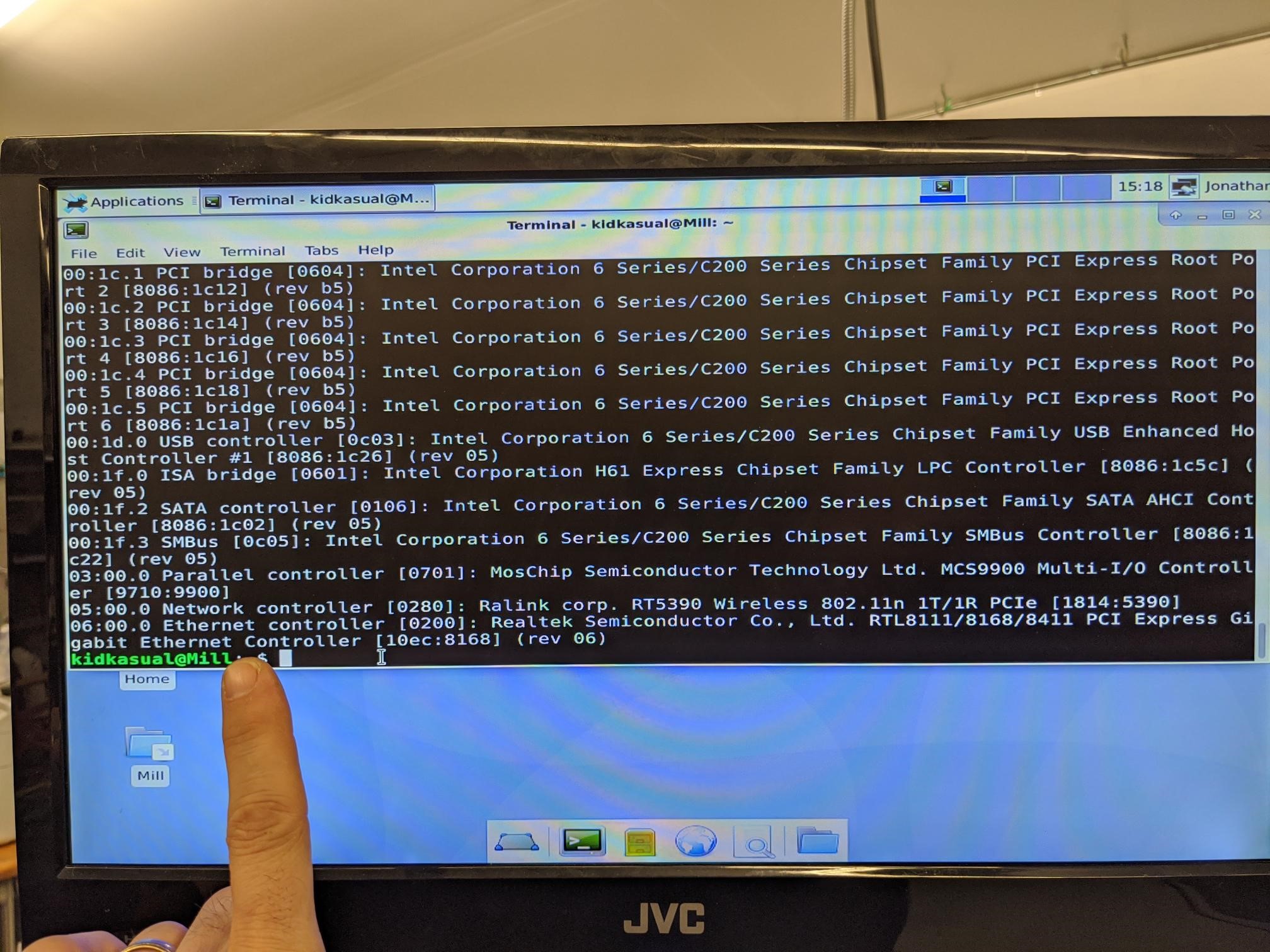

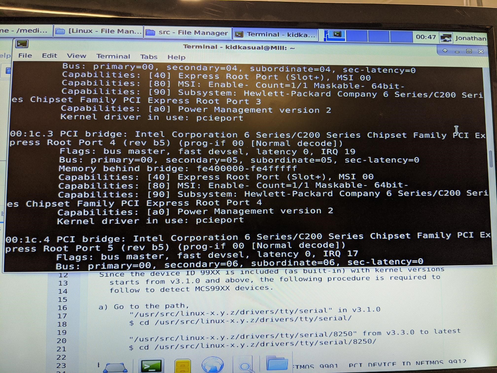

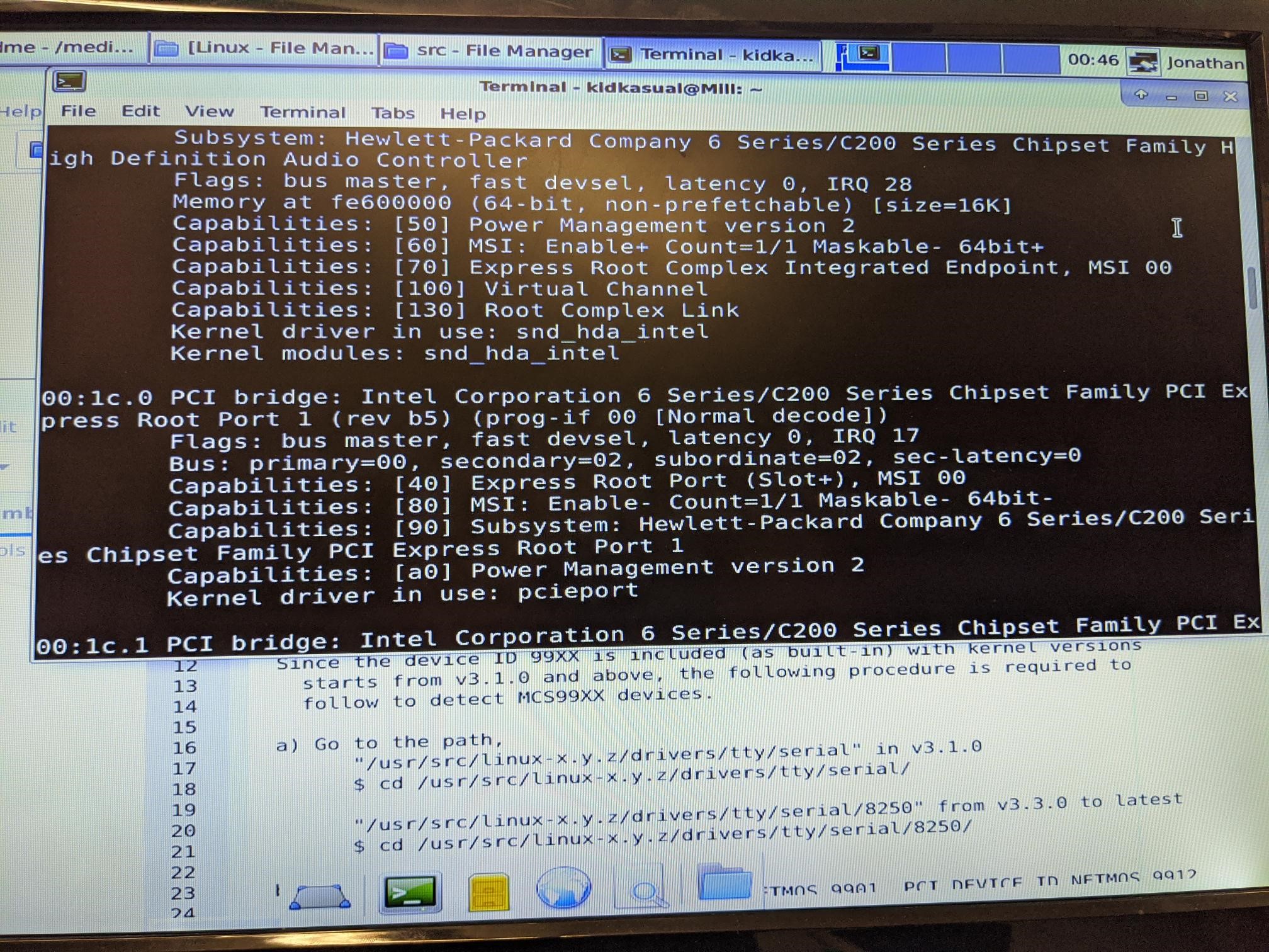

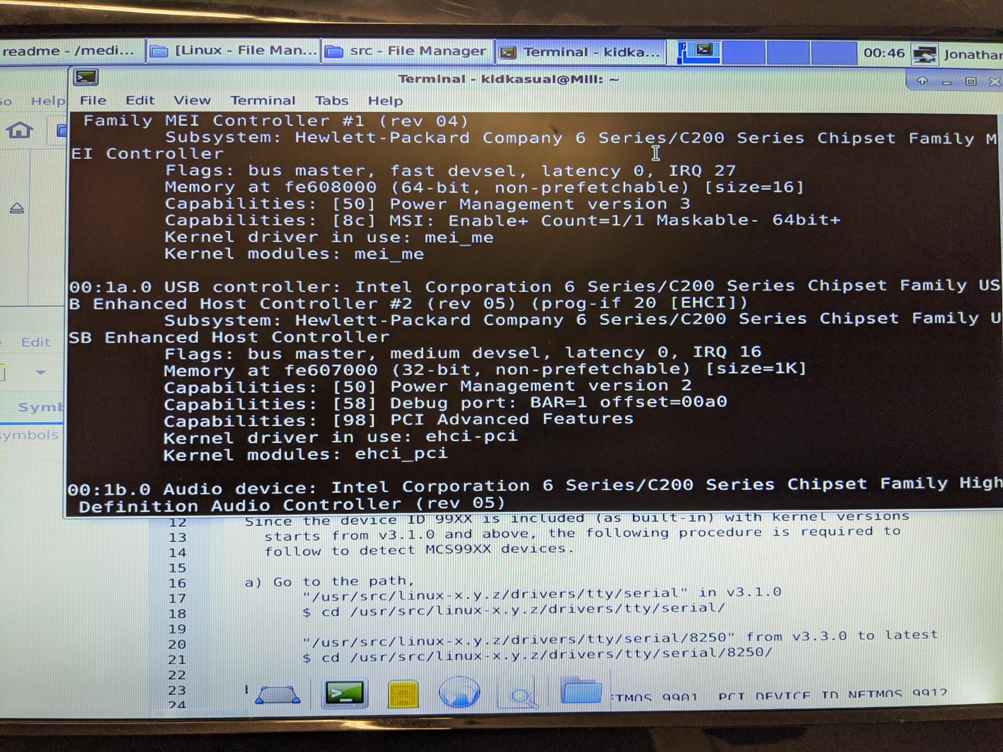

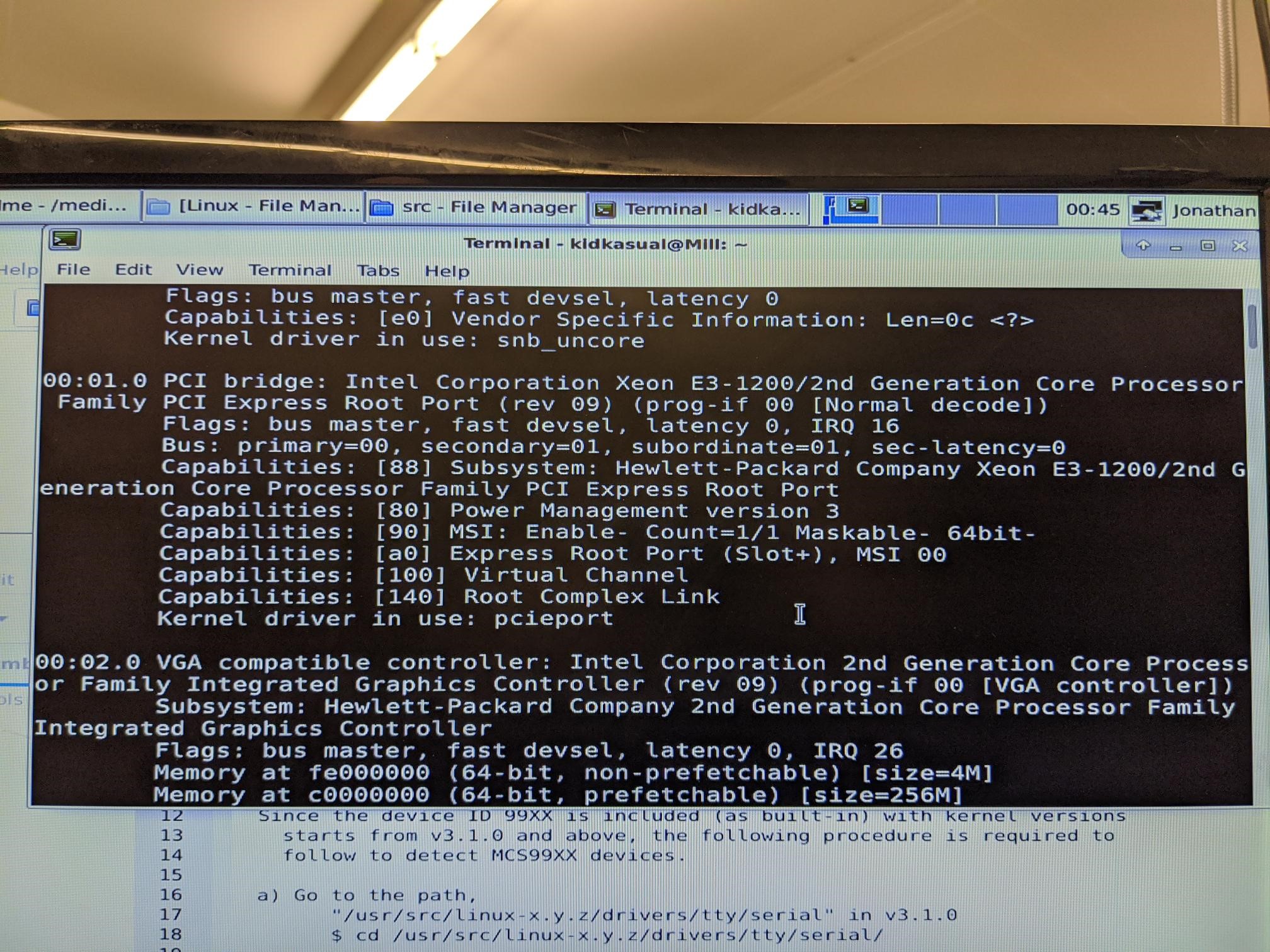

Ok, so here are the rest of the file pics. These are the results from various either sudo lspci -v or sudo cat /pro/ioports callouts in the command terminal. As you can see, The computer can CLEARLY see the parallel port and CLEARLY sees the PCIe adapter card, but there is no kernel module driving the parallel port. If you look at all of the PCI bridges, they are all being driven by the pcieport kernel, but there is no parport_pc kernel for the parport. That is where all of my issue is. I cannot get the computer to actually TALK TO the freaking parport....

pics. The last one is the sudo apt-get install pciutils results. Thank you for you help, guys. It is REALLY appriciated.

As Jon said Linuxcnc doesn’t use the generic parport driver.
To make life easier it is far better to attach the ini and Hal files, even it means transferring them to USB stick.
The output of most terminal commands can be redirected to a file. Then that file can be attached as well, it is far easier to read than pictures.
Plenty of resources on the net that will give better explanations.
Same as for transferring files via USB.
lspci > somefile.txtPlenty of resources on the net that will give better explanations.

OK you need to do lspci -v to get the register addresses for the port. You may have to put sudo in front of that and supply the password to get the addresses on some systems.
Then, you have to give that address in the loadrt hal_parport line in your .ini file.
I don't use hal_parport, so I don't know the exact syntax for that.

Ok, so here are the HAL, .ini, lspci -v output, and proc/ioports output files. Sorry again about the pictures. Still trying to learn the easy(er) way to do things. It has been quite the crash course in Python the last two weeks.... I have already tried multiple times to change the address in the HAL file. I have changed it to literally every single address I can find associated with anything parallel or PCI on a couple of different occasions, cycling through them one by one and trying to then open Axis GUI thereafter. That is why I made the previous comment about communication with the BOB and the relay powering low sometimes "depending on the settings". Then I would open Axis GUI and see what it did. Sometimes it would open Axis GUI but give me the "cannot find port XYZ12" error code in the bottom right corner of the GUI screen (XYZ12 representing the 5 digit number of the port it was trying to attach to), and sometimes it would just open the white error/debug screen and basically simply say that it could not find parport 0, and therefore wouldn't even open the Axis GUI. This is where I am stuck an cannot find any information to move further. I know the hardware is all there and is being seen, but when I tell Linux where to look, it still doesn't see anything -- even though it is CLEARLY THERE.......
