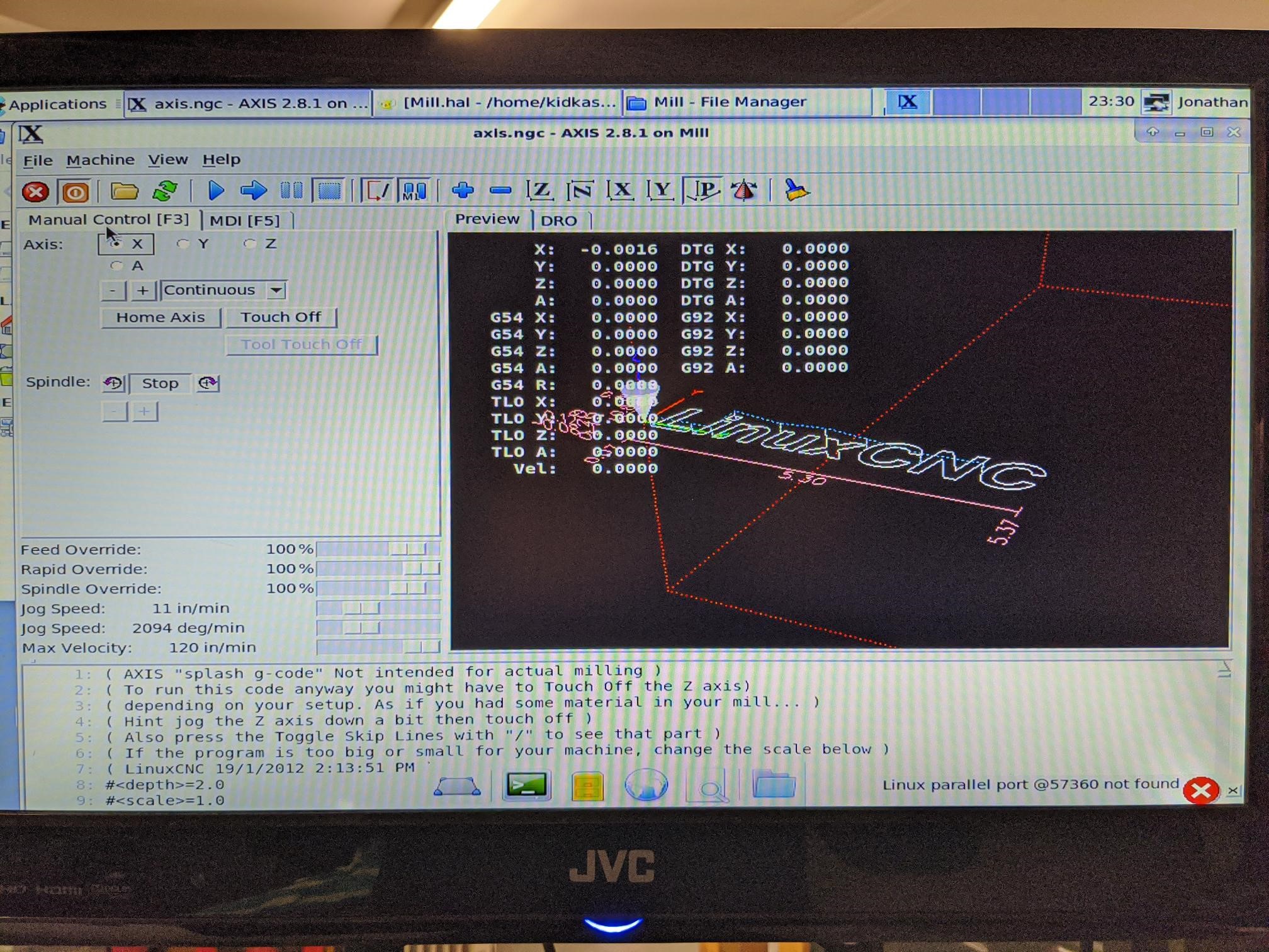

I will attach my HAL and ini files to this post for convenience, though they have been uploaded to this string at least twice already.
Across all of the computers I have tried this system on, they all generate the same error. Everything I can find online references the initialization of the RTAI kernel which, I assume, then allows the parport_pc driver kernel to control communication to/with the parallel port? That is not happening on any of my systems.
sudo cat /proc/ioports shows no kernel driver in use for the parallel port that Linux has the correct address for and can clearly see.

30 May 2021 20:43 #210737
Replied by andypugh on topic Linux will not recognize my BOB no matter WHAT I try to do
There is something wrong in the HAL file. The step-length and step-space are set to 1nS. This is normal in a config using the "reset" function of hal_parport, as it allows 1 step per base period rather than one step per two base periods.
But, your HAL does not have that. We can work out why later, but for the moment open the Mill-hal file in a text editor and swap all:to
I think that might be all that is wrong.
setp stepgen.N.steplen 1
setp stepgen.N.stepspace 1setp stepgen.N.steplen 5000
setp stepgen.N.stepspace 5000I think that might be all that is wrong.

I have changed the .steplen and .stepspace values from 1 to 5000 like you suggested and then tried to start the Axis GUI. I got the white ERROR/DEBUG screen and have attached the error output file. I noticed that in the DEBUG section, it again appears (to me) to be saying that the problem is with the parport_pc module. When I open a command terminal and type insmod parport_pc, nothing changes in Linux's ability to load the parport_pc module. Your next thought??

02 Jun 2021 19:00 - 02 Jun 2021 19:05 #211017
by jmelson
Replied by jmelson on topic Linux will not recognize my BOB no matter WHAT I try to do
Andy is in the UK. I think they do their memorial day on a different date.
parport_pc is the standard parport driver for printing from Linux. It is NOT a real time module, and should not be used in LinuxCNC. The correct module is hal_parport.
I don't know what you have done to your config to cause LinuxCNC to try to load parport_pc, but that is the wrong module. Ahh, I see you have :
loadrt parport_pc
That is your error, it CANNOT work like that, parport_pc has all the wrong software interface for what LinuxCNC wants it to do. Where did this mill.hal file come from?
You should have :
loadrt hal_parport cfg="0xnnnn" where nnnn is the parport address. I see you DO have this, so just REMOVE
loadrt parport_pc
Jon
loadrt parport_pc
You should have :
loadrt parport_pc
Jon

Oops.... Well, Happy Memorial Day Andy (whenever yours is) because the meaning is the same for everyone -- honor the troops and remember the sacrifice of fallen in our behalf.
To be perfectly honest with you John, with the exception of changing the parallel port address from 0 to e010 and making the changes that Andy just suggested to the step length and step space, those files are exactly as they were generated by the StepConf Wizard. I have not changed anything in them. I opened the StepConf Wizard and followed the prompts, and those were the files that it created.
I have removed the "loadrt parport_pc" from the HAL file and tried to open the Axis GUI. It allows me to open the GUI, but it is still giving me the "Linux parallel port @57360 not found" error in the bottom right of the display screen.

02 Jun 2021 23:23 #211037
by jmelson
The actual issue is that LinuxCNC needs to take control over a parport that WAS assigned to the OS, to avoid a conflict.
If the port requested in the hal file is NOT in use by the system, then you get this message. And, the message really doesn't mean what it says!
What it should say is something like "I asked Linux to give me exclusive control over the requested parallal port, but since Linux did NOT have control of the port, it would not give me control." Since NOBODY has control of the port, it is perfectly safe for LinuxCNC to just take control.
Jon
This error is spurious. I hope somebody takes it out, or reworks the code so it doesn't come out for no reason.
