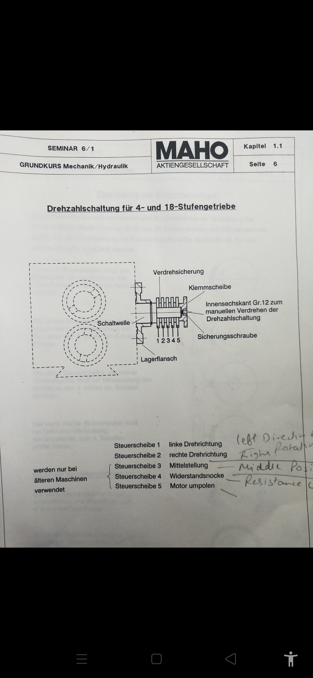

I have checked marks source code. His component uses the left_center switch too.
Are you shure the switches are not used? maybe on another page of the schematic?
If there has been an problem and the gearchange is stopped between gears, the control will not know the actual position of the gearstage....

number 5 "Motor umpolen" is the left-center switch.

No sir, i have checked it multiple times, no other page has any information on left centre switch. I'll wire it by my self i guess. Thanks for your help. I'll try to figure it out now.

I received 2 huge service manuals along with the machine. If you want, i can send you everything that you need. Mine is a maho mh 1000T. You also have the same machine? I have manuals for 1000T/E. I'll send you these 4 details that you asked in the morning. Let me know if you need anything else. Or it would be better if you could share your email.
So i tried to track left centre switch, it is not wired to maho relay board, I'll wire it in the morning and test it.

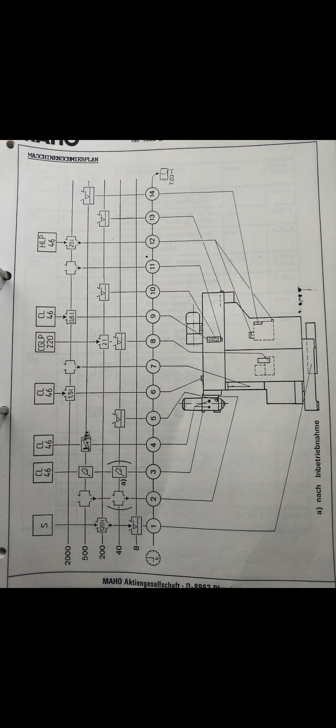

- Sourabh3
- Posts: 73
30 Aug 2021 14:12 #219171
by Sourabh3
Replied by Sourabh3 on topic Indramat 3trm2

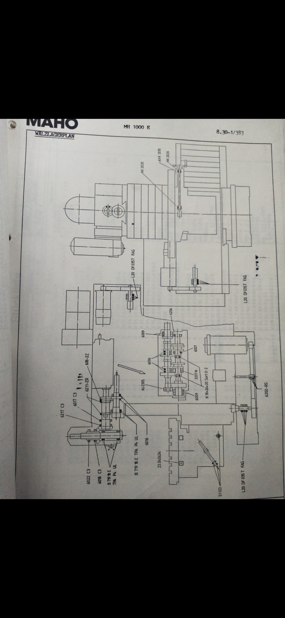

I don't understand German but i am trying to give my best. I have attached the photos which i think contains all the information that you ask. If i missed something, please let me know. I'll be more than happy to help. As I'm limited to share quantity of files please provide me your email.
