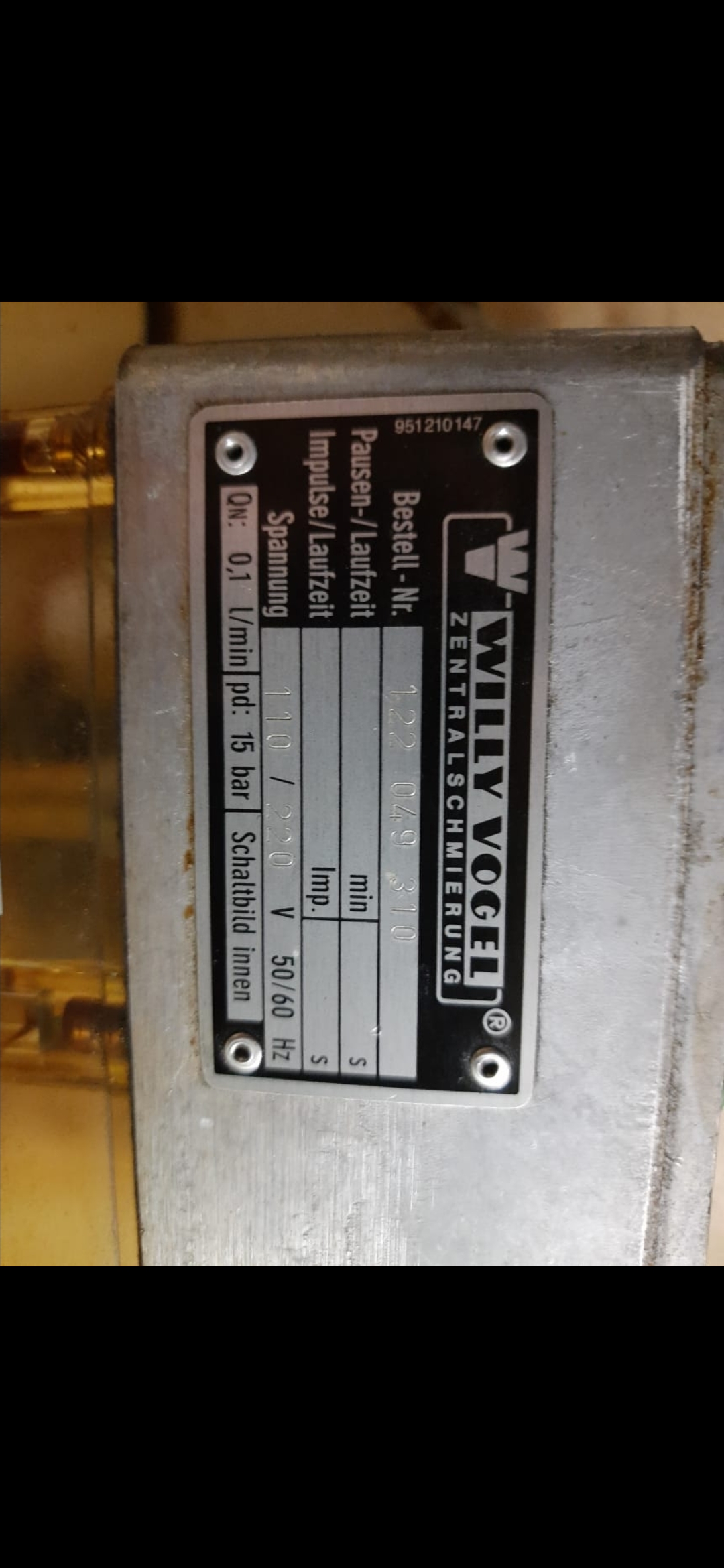

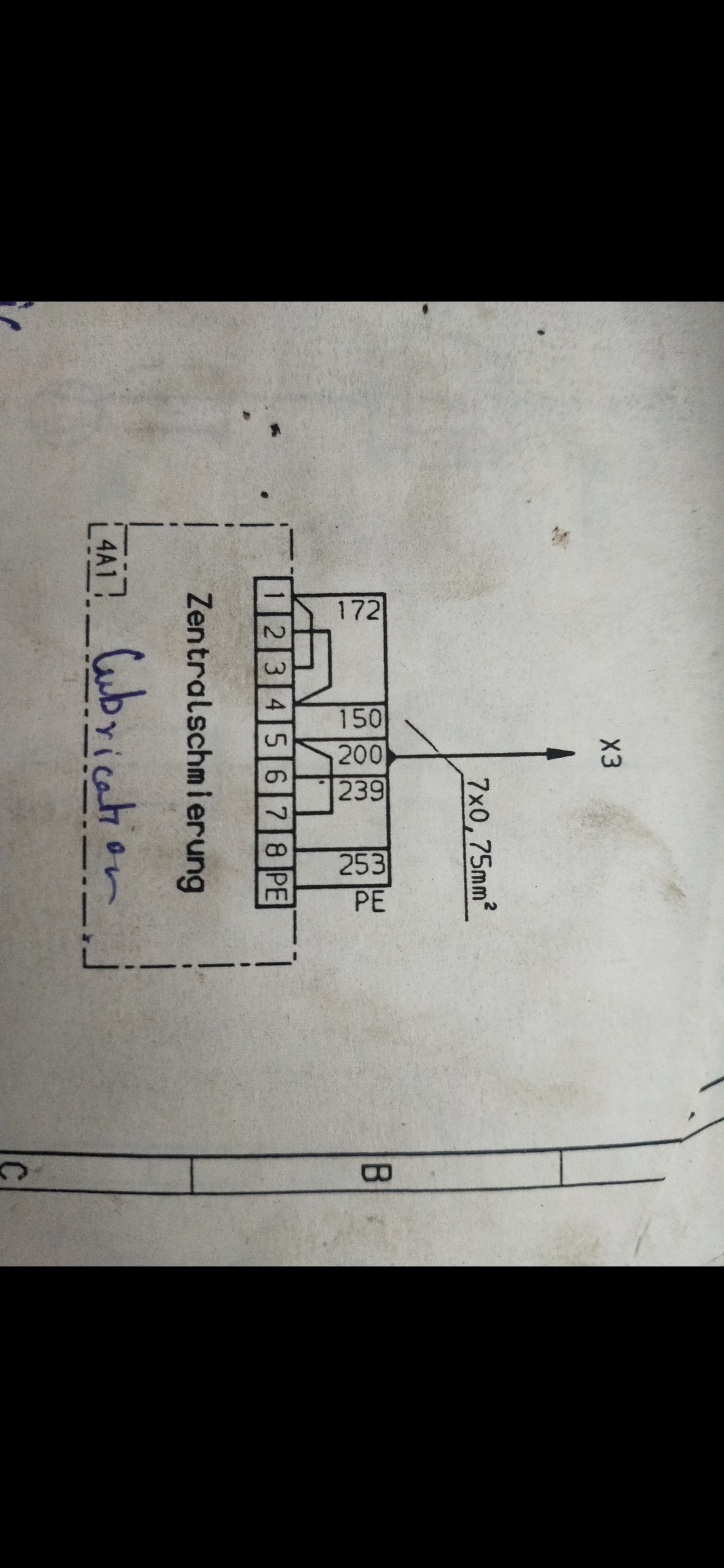

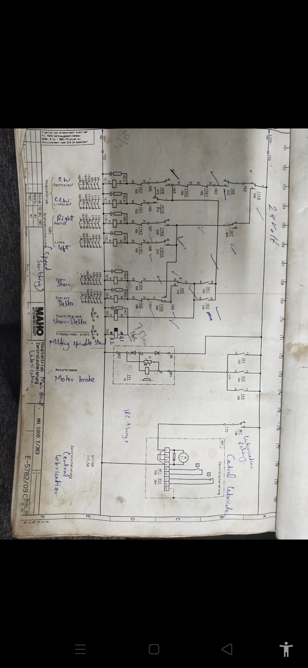

05 Sep 2021 14:41 - 06 Sep 2021 05:46 #219673
by Sourabh3
Replied by Sourabh3 on topic Indramat 3trm2
Sorry for the late reply mark, I've had some trouble at work. Here are the diagrams of the central lubrication system.

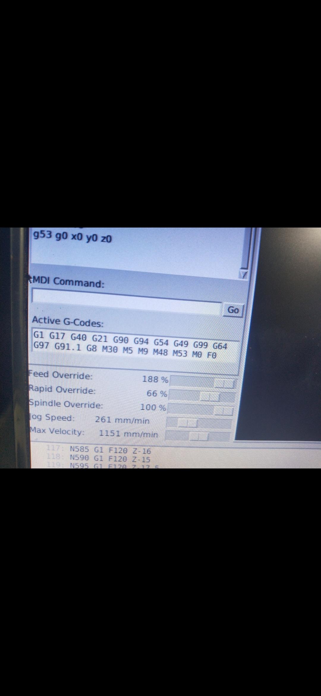

There is another thing that i want to discuss. Doesn't gmoccapy support G33 gcode? I saw a tab named as gcode in gmoccapy screen that stated a few gcodes(i guess the supported gcodes by gmoccapy) same i noticed in axis gui(I'm attaching pictures). And also i tried to run gmoccapy with G33 gcode and the machine didn't respond to it (became stationary) without generating any error. Can you tell me if it's possible to run G33 gcode and some basic gcodes on gmoccapy (G33).

06 Sep 2021 15:37 - 06 Sep 2021 15:39 #219767
by RotarySMP
Replied by RotarySMP on topic Indramat 3trm2
I am pretty sure the bigger Maho's have the lubrication tank low level switch as an inhibit. My little 400E doesn't. Looks like the switch V is an inhibit for the main spindle (probably the tank low level float switch), and P is the power switch to the lube unit used to command a squirt of way oil. My lube unit is self-contained and has no connection to the LinuxCNC controller. It has an internal timer relay, and gives a 5 sec squirt of oil at start up and then every 20 minutes.
On larger more complicated machines, the way oiling is often more complicated. For example if you are 3D contouring with a lot of short back and forth motion, there is a greater risk of galling a way. Since you have that P switch, you can easily connect that to LinuxCNC, and make the lubrication interval as simple (timer) or as complicated (distance ways have travelled, lines of code read etc) as you like. Search the forum, I am pretty sure a variety of solutions have been done on other machines.
Gmoccapy is only a GUI. The G codes which can be run are all which LinuxCNC supports. The section of the GUI you showed is a the list of currently active codes. For example, if you type a line with G00 you do not need to keep writing G0 on following lines. It stays in rapid mode, until you write a G1 (or G2, G3, G33 etc - any code from the same modal group). See here... Paragraph 11 and 13.
linuxcnc.org/docs/html/gcode/overview.ht...ds_and_machine_modes
G33 is supported, but you need a spindle encoder for LinuxCNC to sync the motion to. If you send a G33, without an encoder, it is probably waiting in an infinite loop for spindle motion to sync to. I have an encoder on the mini lathe spindle, and will use the one on the Schaublin, but have none on the Maho.
That is why I use the Tapmatic on the Maho. It is designed for manual machines. I just program a G1 plunging move with the feedrate of RPM x Metric pitch. Once the depth is reached, you need a rapid retract for a few mm to reverse it's gearbox (not needed on a through hole). Then I retract to about 10mm above the stock, with another G1 at a feedrate of RPM x metric pitch x 1.75, as the internal reversing gearbox of the tapmatic increases he rpm by 1.75 when it reverses.
