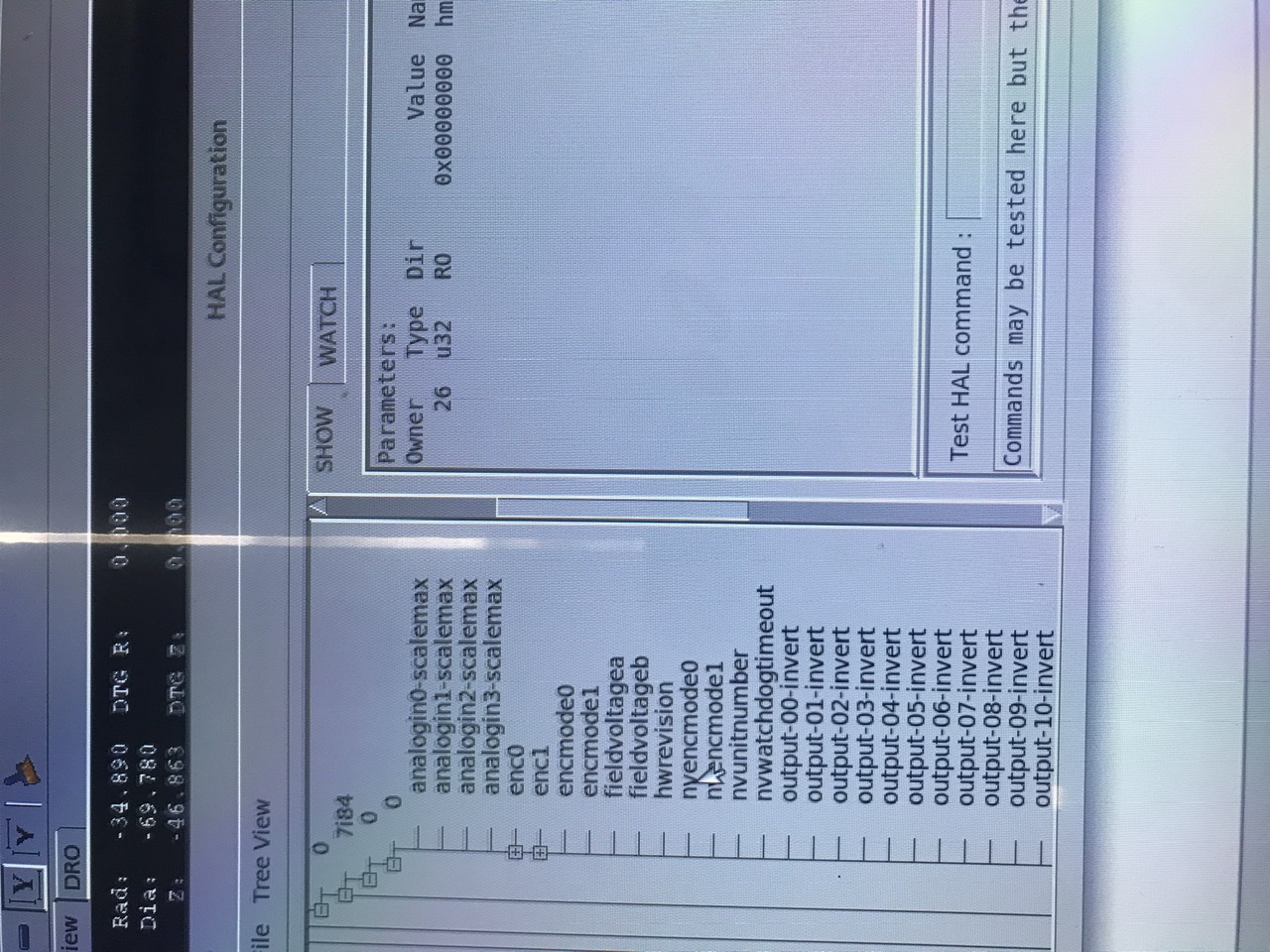

My mpg is 25 ppr and 7i84 serial cards are 100 ppr, so I need to modify something to change it to 4x.
I followed the man setsserial page, and it went without any errors (I think). I tried changing nvencmode0 to 4 and encmode to 4, one at a time, both of them RO on “show param”.

The parameter is read only.
I was surprised that it was not RW
(u32 ro) .7i84.0.1.nvencmode0
My encoder is 25PPR and it needs 4x
I will fire up ISE and see if I can find something there. But I am open to all ideas.
I even tried to restart using mesaflash.

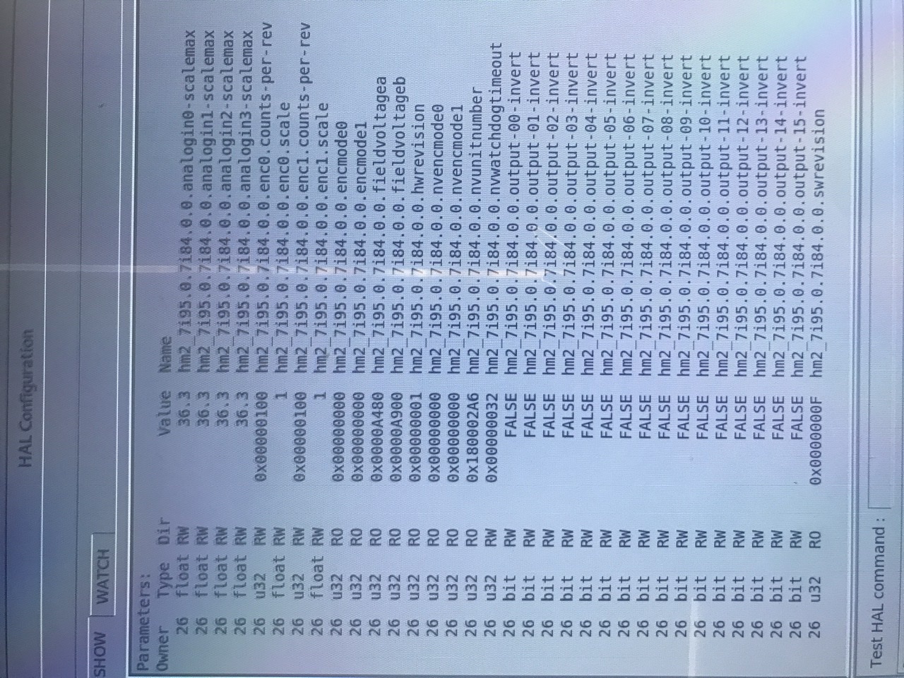

I have updated to R15. But it is still RO.
If you guys have any more ideas I am all ears.

Note that the 7I69, 7I76 and 7I84 firmware labeled R14 in that archive are actually R15
( so the same scripts can be used for all updates)
EDIT ok Looks the the 7I84 only got 1/2 updated I'll try and fix this today
