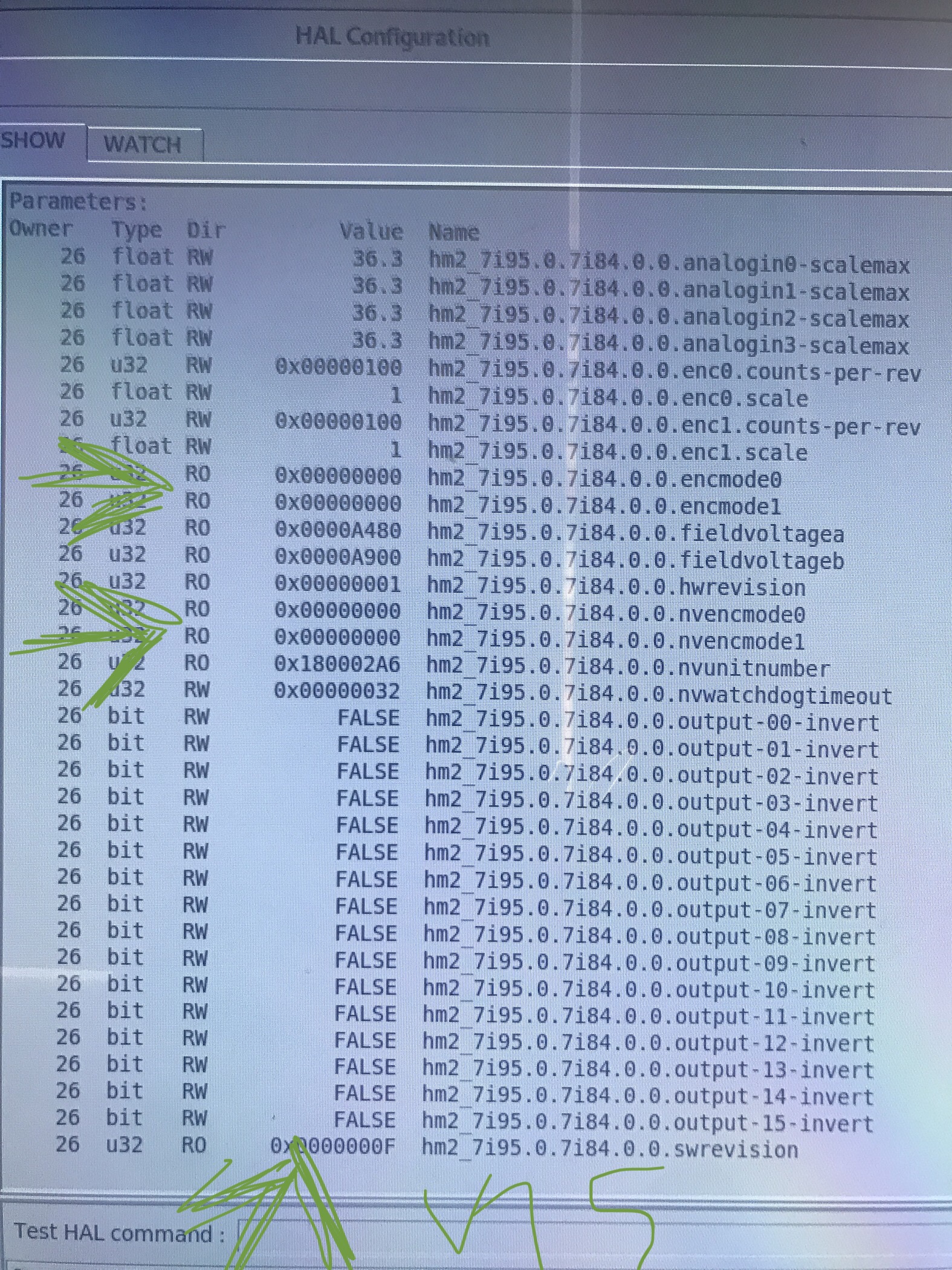

by HeronG
Replied by HeronG on topic (Solved) SetSSerial not holding the values (mesa 7i84)
Just tried all 3 of them. Flashed R15, r14, oldR14. None of them worked. “Read Only” . I will attach a picture.
Last edit: 24 Nov 2021 18:55 by HeronG.
24 Nov 2021 18:54 #227521
Replied by andypugh on topic (Solved) SetSSerial not holding the values (mesa 7i84)
It is certainly showing 15 as the swrevision, so it's updated.
Did you do a power-down restart, just to be sure?

24 Nov 2021 19:22 #227524
On my system I see:
So it does appear to be a 7i84-specific thing.

18 u32 RO 0x00000000 hm2_7i84.008a.encmode0
18 u32 RO 0x00000000 hm2_7i84.008a.encmode1
18 u32 RO 0x00000000 hm2_7i84.008a.nvencmode0
18 u32 RO 0x00000000 hm2_7i84.008a.nvencmode1So it does appear to be a 7i84-specific thing.

Replied by PCW on topic (Solved) SetSSerial not holding the values (mesa 7i84)
As I mentioned, there was an issue with the7I84 BIN files in sserial.tgz
If you re-fetch it, it should be fixed now:
MD5 (7I84R14.BIN) = 28ff2d63e79c8a2f0d65be5310d56764
MD5 (7I84R15.BIN) = 28ff2d63e79c8a2f0d65be5310d56764
The following user(s) said Thank You: HeronG
