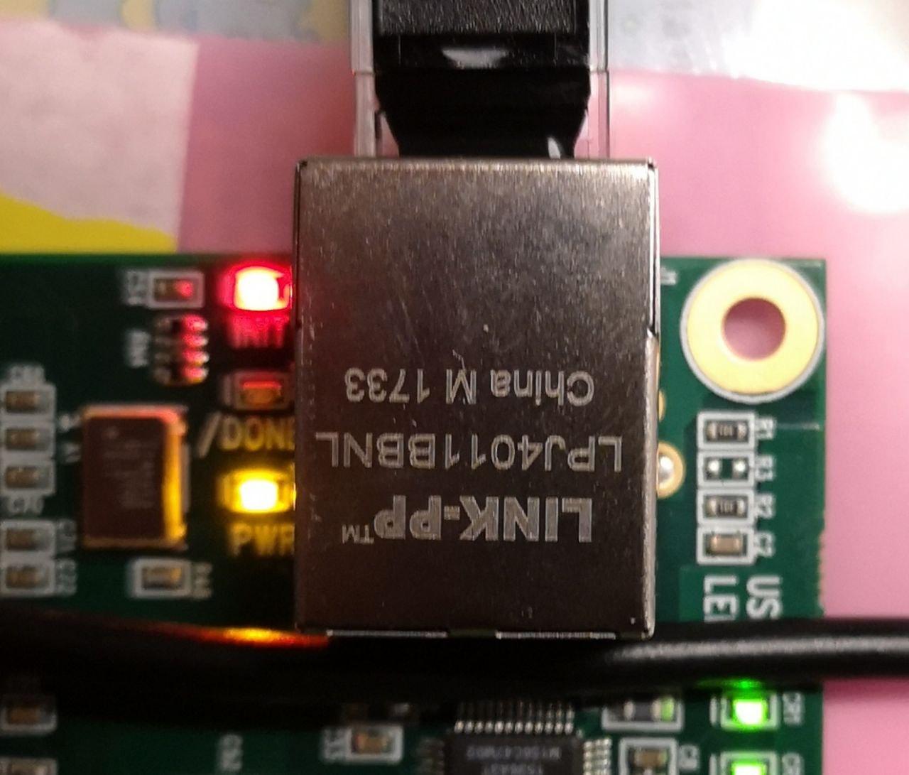

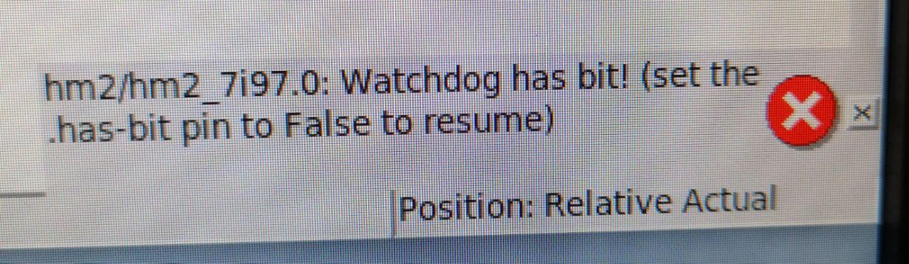

At this point I achieved to connect and read servo encoders.
When I open Linuxcnc some times I have a message "Watchdog has bit".
I've observed that when the (Linuxcnc windows) is small, it is more stable, but if I expand or maximize the windows the problems always come up.
And red light on the car turn on
Any idea why? Thanks.

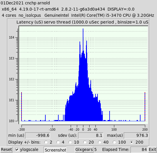

01 Dec 2021 22:22 #228156
by Arnold
HP Elite 8300 i5
What do you think?

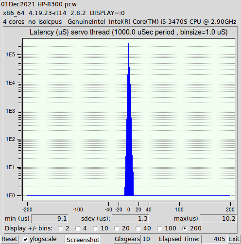

01 Dec 2021 23:30 - 01 Dec 2021 23:46 #228161
Replied by PCW on topic Mesa 7i97 Watchdog has bit!
Yes, that is unusably large latency
Have you gone through the BIOs settings and disabled all power management,
hyperthreading, Cstates > C1, AMT etc?
Also your CPU uses Intel MACS so you must disable IRQ coalescing
(this is described in the hm2_eth manual page)
Here is a similar CPU with all power management and AMT disabled:

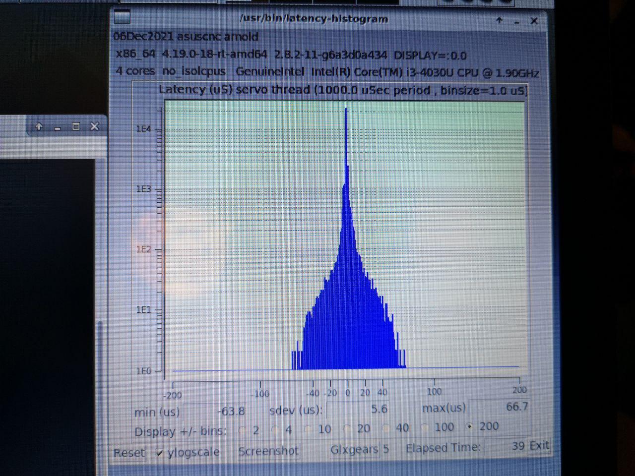

06 Dec 2021 22:45 #228473
by Arnold
I've been working on the hp elite 8300 without much luck. I've done the installation process multiple times with the same problem. I do not know if the bios security is causing such a malfunction, I tried everything with the same bad result.
I done the installation process right, that is easy and basic to do. I've done the same basic procedure on a Assus laptop i3, it never failed, never got a ( Using POSIX non-realtime ).
This is the result of a latency test on the laptop
It is usable?
I'm trying to have something to be able to make the 7i97 work and learn from this

06 Dec 2021 23:07 #228477
It may be usable but in general laptops have power management
that cannot be disabled and will often have large latency spikes
(say when you adjust the display brightness)
I don't actually see what BIOS settings could have to do with
Linux permissions, that really looks like an installation issue of some
kind on the 8300.
