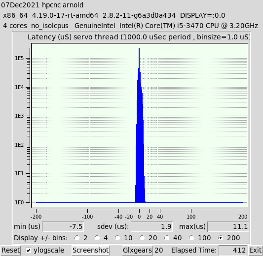

I want to thank to PCW and Tommylight for your support!
Linuxcnc was installed in a disk partition of a ssd, so there was linuxcnc and windows 10, each one in its own partition, but same disk.
I decided to replace the disk and make a new installation of linuxcnc using the whole disk space, no windows.
No more "Using Posix non-realtime". Here is the result
I really do not know the real cause of the problem, the only one thing left to try was installing only debian and not windows, and it solved the issue.
Yeah I will sleep like a baby

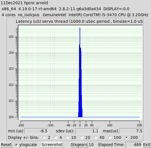

11 Dec 2021 19:38 #228886
by Arnold
Replied by Arnold on topic Mesa 7i97 Watchdog has bit!
Problem solved, thank very much PCW and Tommylight !

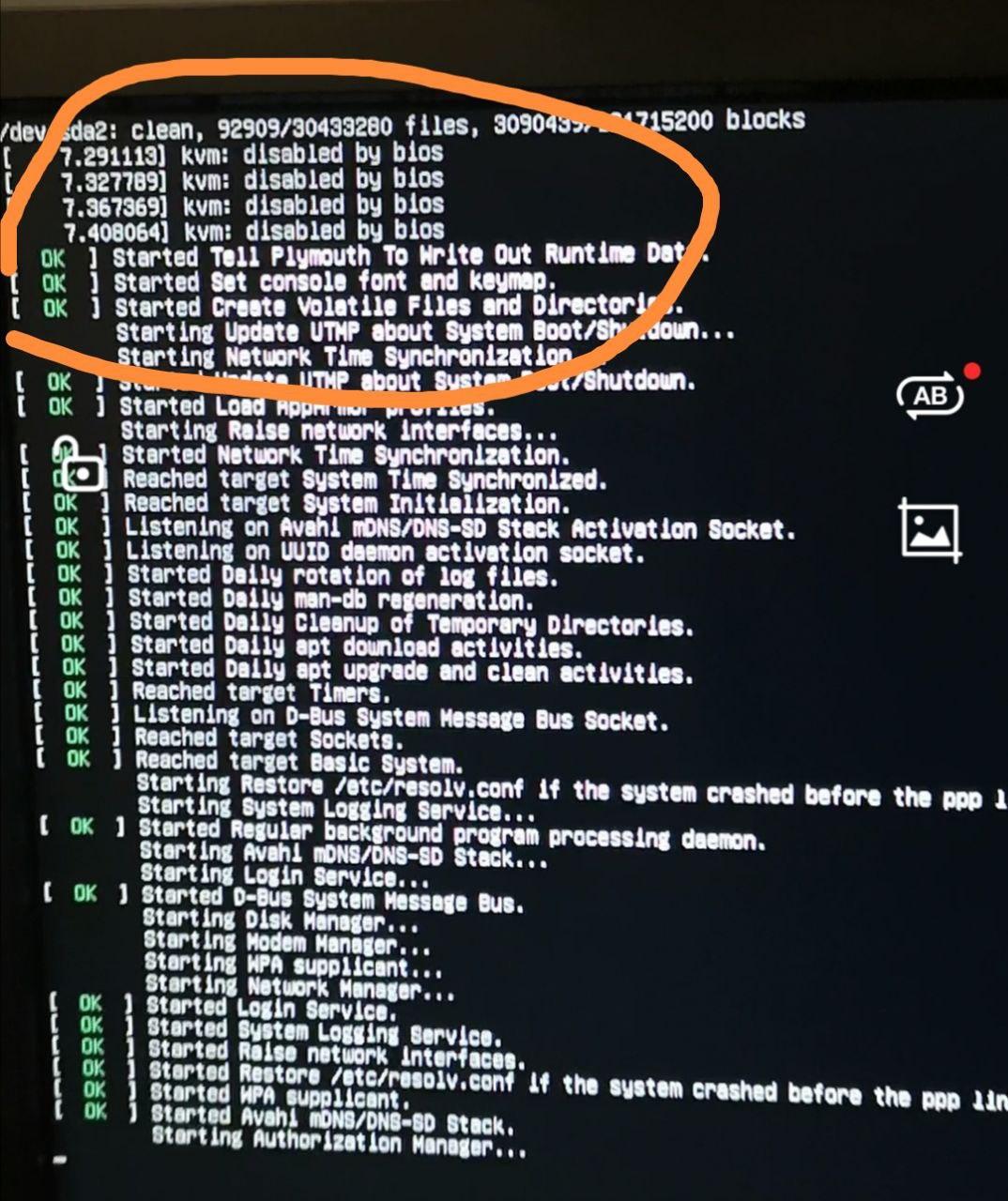

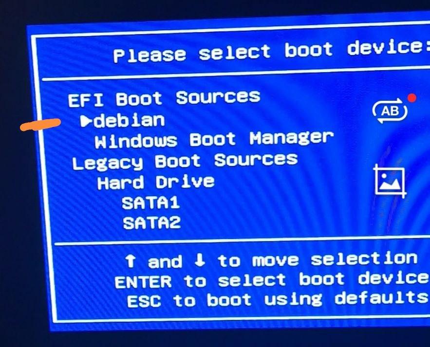

I have "some" idea about the source of the issue, it has been some permission that was not allowing loading linuxcnc fully
When I loaded linuxcnc through EFI mode, it gave some wird results:
"cannot gain I/O privileges - forgot 'sudo make setuid'?
Note: Using POSIX non-realtime"
Here you can see that BIOS restrict something

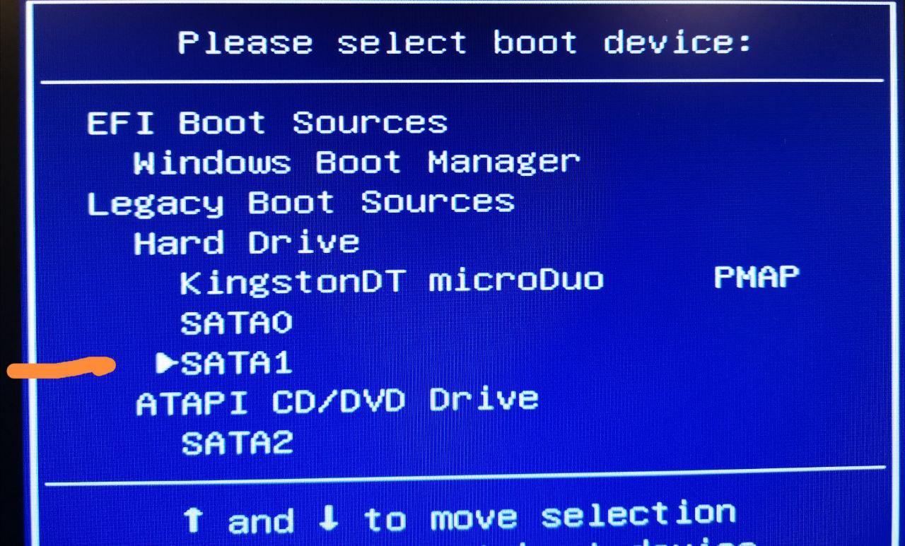

I made a new fresh installation on disk 1 and started from the disk (not EFI mode)
No more problems and working good
At this point the 7i97 is attached to servos and doing it very well, running without error and very nice, next thing is to see how can access to the I/O...
Watchdog doesn't bite anymore
