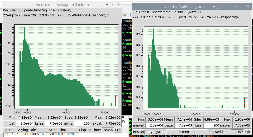

02 Dec 2022 16:47 - 02 Dec 2022 17:03 #258335 by muvideo
Hello, another inch forward for my implemetation:
  •   Lcnc master
  • the driver now can handle up to 4 boards, you'll need a gigabit ethernet switch. In theory many more boards could be handled, but honestly I'm not sure how useful is to increase this number, if someone wants to try just set
    #define MAX_CHAN 4 in Lcnc.c to the number you want
  • the ip address and port now are parameters at hal invocation, so no need to rebuild the driver to change ip and port, added also a "debug" parameter. Example:
    loadrt Lcnc ipaddr="192.168.2.50","192.168.2.51" ipport="1234","1235" debug=1
    "debug=1" will add some verbose output and a series of pins that report the time in ns that each part of the code is taking, of these T1 and T6 correspond to two calls to eb_send function, and are the most time consuming.
  • A raspberry pi 4 seem capable to handle two colorlight boards at 1ms Thread with sufficient stability.
  • stepgen step and direction timings are now expressed in ns instead of us.
  • In the attachment the timing I'm seeing with 2 colorlight 5a-75b boards, on the left the one with 14 outputs 11 inputs 6 stepgens 6 encoders 6 pwm, on the right the one with 26 outputs 23 inputs 6 pwm. Seem that also the fpga configuration is having an impact on timing. Some sporadic task overrun are still there.
Ciao!
Fabio

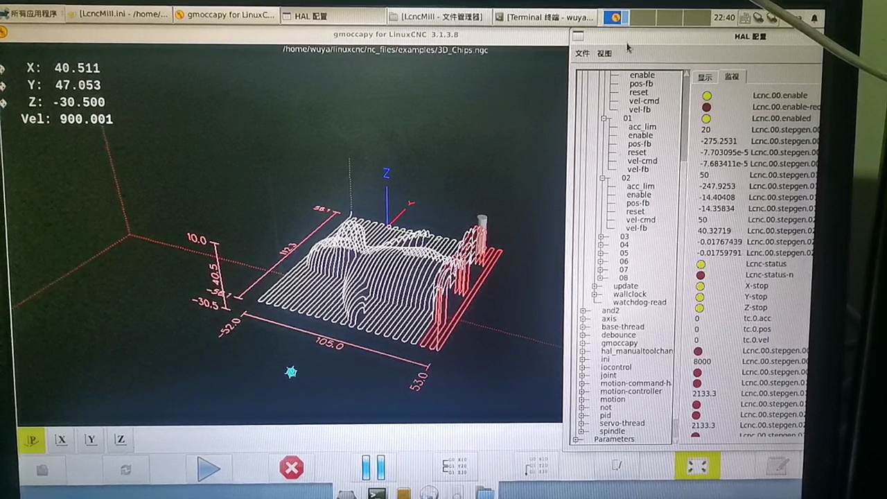

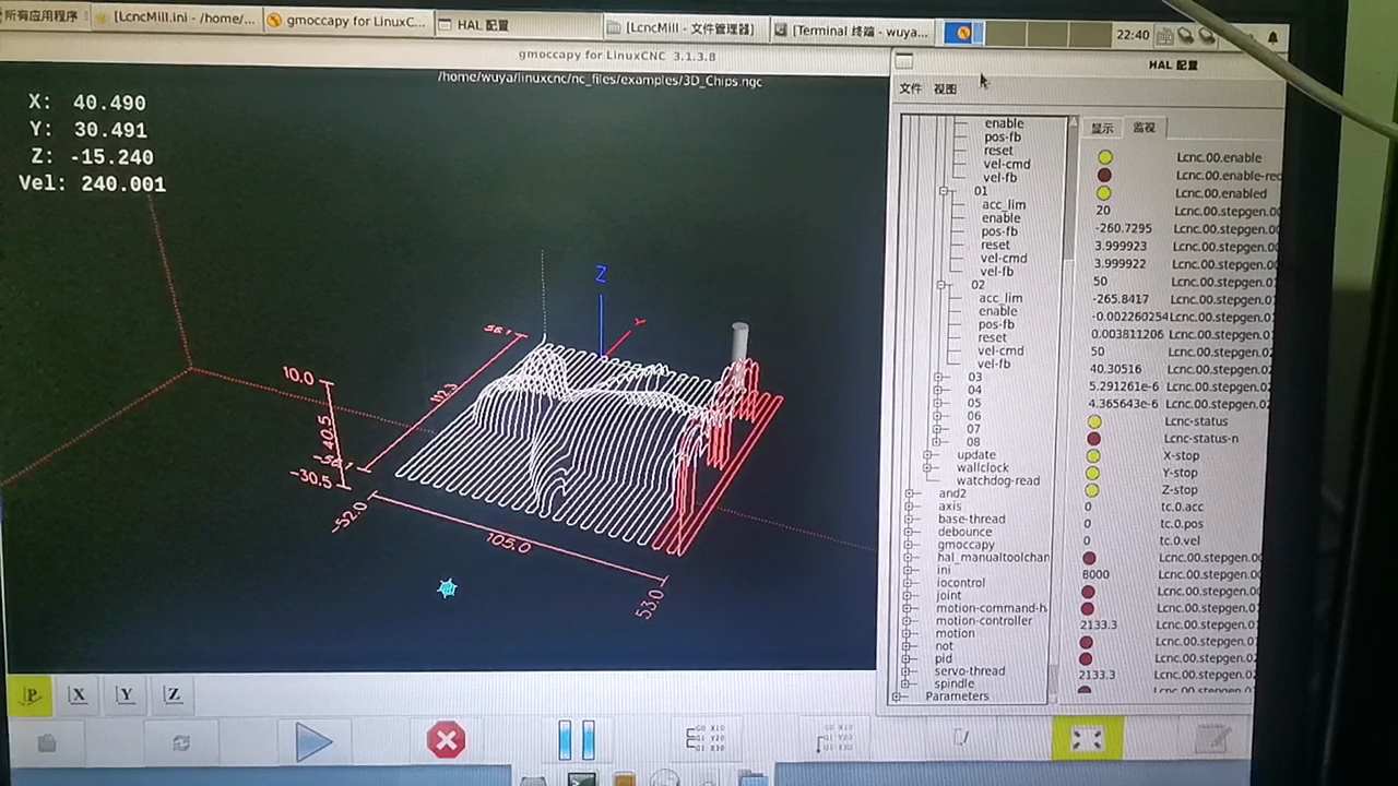

04 Dec 2022 15:57 - 04 Dec 2022 16:02 #258513 by wuyatom
My v7.1 board is not enabled
Last edit: 04 Dec 2022 16:02 by wuyatom.
