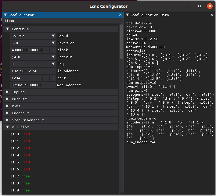

- muvideo
- Posts: 62
- Thank you received: 30
16 Dec 2022 11:26 #259628
by muvideo
Replied by muvideo on topic ColorCNC Colorlight 5A-75E/5A-75B as FPGA controller board
Hello, in my last commits there are two small updates to make easier the firmware generation and management:
- ini files for storing and retrieving the configuration: perupherals, pinout, harware details
- GUI configurator utility, I was tired of editing endless lists of pins, this will make easier the board configuration (you'll need dearpygui library in python for this)
- Lcnc on github
The following user(s) said Thank You: tommylight, TOLP2
