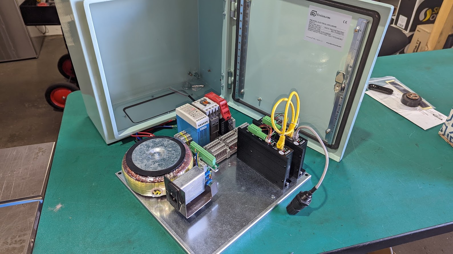

I waved a wire in the wrong place over a gecko G251X which it didn't like and replaced it with  4 x Longs Motors DM542A drivers for a similar cost. Aside from the footprint, I could not see any performance difference. (Longs Motors drives have an elephant on them)
I think if you go with Gecko, your choice should be dictated by the voltage you will run your motors at. If you are going to use 48V use the G251X and you will get good results. If you want to run 70 volts or so, go to the G214V
I think it was on Gecko's site I read that the total amperage of the motors can be about 40% higher than the power supply output. You therefore only need about 8.5 amps. I've always used that rule when sizing a power supply.
The Spaceship was originally going to use all NEMA 23s and I had a 7 amp power supply which would have been fine but I then decided to use 2 x NEMA 34's and upgraded to a 10 amp power supply..
I think when you get up to 70 volts, its harder to find a suitable SMPS ( 2 x 36 V SMPS in series is one option) so you see more people use  toroid transformers. If you combine these with a AC compatible driver, there is no need for a DC rectification circuit so you get a much more compact layout and fewer failure points. This is where the spaceship is now. 2 x 32 volt torids outputting 64v AC in series (cos that was what I could get) to 3 amp and 6 amp Lam Technologies drivers)
So in summary if you have the budget, go for a 70-72 volt system, otherwise with  NEMA 23's 48V is fine.
By way of inspiration, here is a photo of an Ethercat stepper system I am working on at the moment using AC compatible drivers.
The toroid is one I had custom built 60 volt AC output with 240v and 110v Mains input. The drives can handle 80v AC input. The enclosure is 400mm x 400mm and the base board is 330 x 330mm so its a bit of a challenge to get everyting to fit. I put the toroid on the opposite side of the drivers so it can't heat up the drivers..
