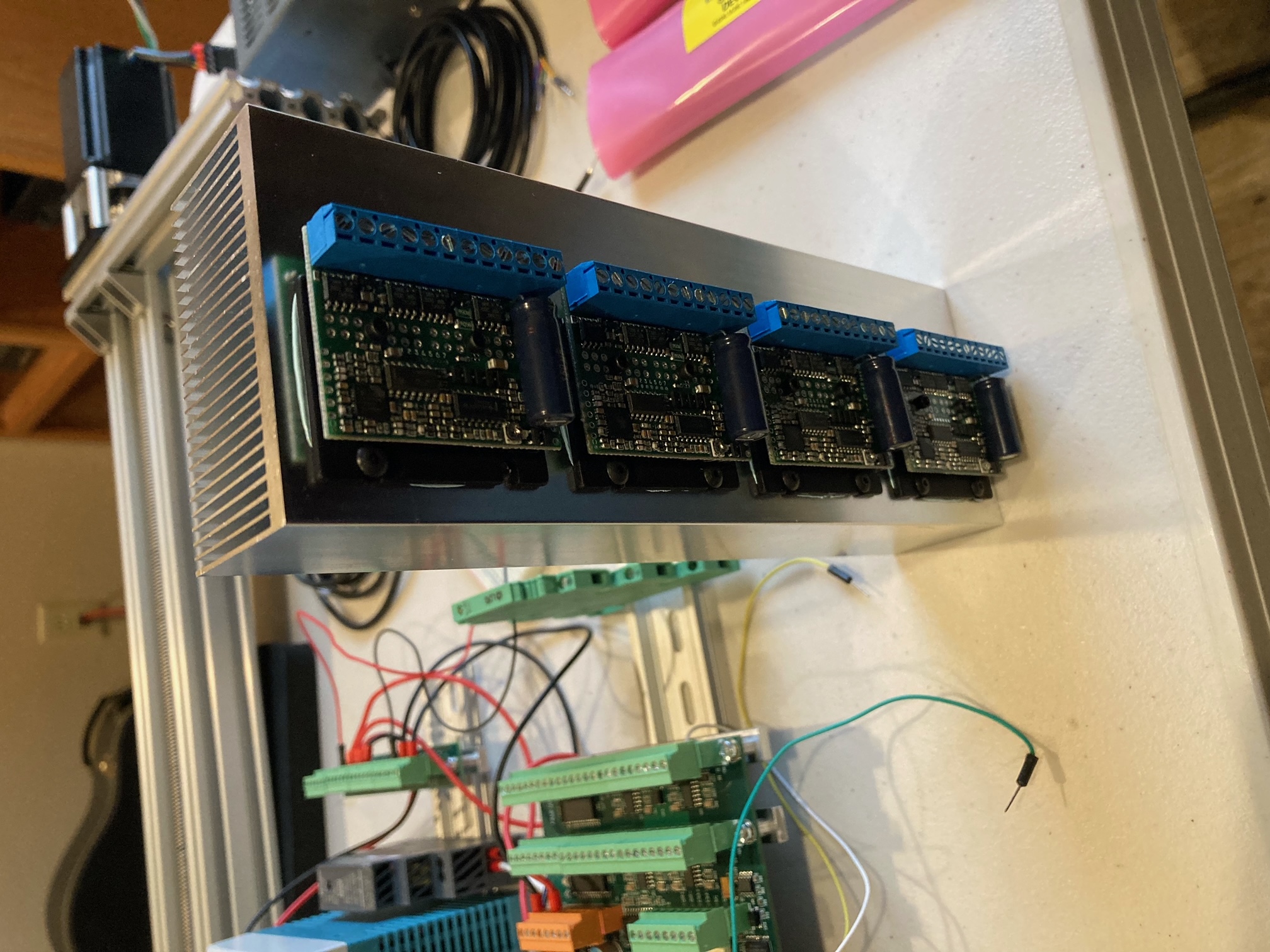

24 Dec 2021 16:26 - 24 Dec 2021 16:28 #229902
by dlv
Replied by dlv on topic Seeking advice about stepper drivers and power choices
For now yeah I'll use the Geckos. Tommy you are right they are fixed at 1:10 step divider. Another "con" to add to the list but I'll live with it for now.
Rod here's my answer to the heatsink question on the G251. All mine came with was that mounting plate which maybe qualifies as a heatsink? It gets pretty dang hot driving a 3A motor so I found this heatsink on Amazon for about $20. I think it'll suffice mounted vertically in the enclosure. If further cooling is needed I'll mount a couple box fans on the fin side.

- Posts: 21980
- Thank you received: 7480
24 Dec 2021 18:04 #229910
Replied by tommylight on topic Seeking advice about stepper drivers and power choices
Looks neat !
