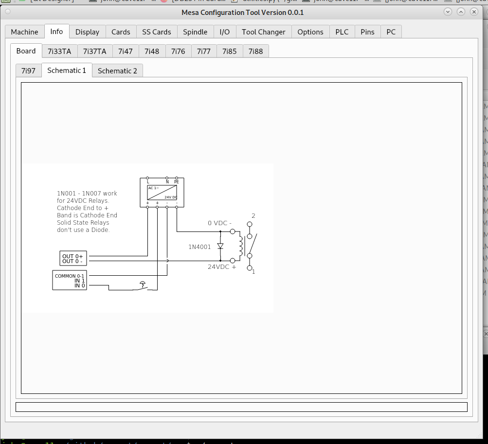

Replied by PCW on topic Wiring basics 7i97
The drawing has the relay polarized incorrectly
The coil pin that connects to OUT- is RELAY+
This coil pin should have the cathode (band) end of the flyback diode
I would verify that you have the flyback diode installed correctly
by using a current limited 24V supply, so you do not destroy the 7I97 output
if you have the diode installed backwards

27 Mar 2022 22:21 #238492
by Kylizer
Replied by Kylizer on topic Wiring basics 7i97
ok see the thing is that I am not necessarily trying to directly energize is. I still have the anilam servo board from the old setup and i am just trying to engage that relay because it will enable power to the amplifiers. I mean I hoped it would anyway.

27 Mar 2022 22:58 - 27 Mar 2022 23:00 #238493
by BigJohnT
Looks like I need to add some basic wiring diagrams to my Mesa Configuration Tool... the one that configures a lot of cards... yet to be released... well it's out there.
JT
Replied by BigJohnT on topic Wiring basics 7i97
That drawing the relay is wired backwards, output - to relay +, relay - to 0vdc.Looks right. Be sure to add a flyback diode across the relay contacts.
JT
Last edit: 27 Mar 2022 23:00 by BigJohnT.

27 Mar 2022 23:00 #238494
by Kylizer
ok and this is to a solid state relay btw

27 Mar 2022 23:06 #238495
by BigJohnT
JT
Peter is a 1N4007 a good choice for a flyback diode?The drawing has the relay polarized incorrectly
JT

27 Mar 2022 23:13 #238496
Yes IN4001 --> IN4007 are fine for 24V relays
(The OP just stated that the relay is a SSR so it needs no flyback diode)

28 Mar 2022 22:44 #238560
by BigJohnT
The Mesa Configuration Tool is
here
if you want take a preview as it is a fresh work in progress.
JT
