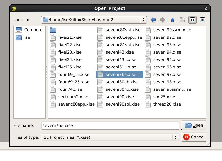

30 Apr 2022 20:46 #241734
by robertspark
Replied by robertspark on topic Mesa + 7i76e + xilinix bitfile creation
Anyone looking for a bit of a guide on this
The be fair the wiki is actually right / sort of (it doesn't expand on what exactly to do and I'd not done it for a 18 months or so... so I forgot!) + it doesn't deal with ethernet mesa cards (but the principle is really the same!)
wiki.linuxcnc.org/cgi-bin/wiki.pl?Editing_MESA_Bitfiles
Basically download and install the current xilinx ISE 14.7
www.xilinx.com/support/download/index.ht...ols/archive-ise.html
you will need to sign up / register etc to download the file.
Note it is very large (15gb) and will take a while.
It basically sets up a virtual environment (on windows)
download the mesa firmware file from the mesa site (I have a the 7i76e + 7i92 so that is was I set up)
www.mesanet.com/software/parallel/hostmot2.zip
then use notepad / notepad++ or geany (basically a text editor) and just review the *.vhd PIN files to find one that is close to your needs, and create a copy of it for you to edit.
eg... for the 7i76e this is the basic file
PIN_7I76E_51.vhd
for my needs (I was in need of a few PWM pins to control a laser and a few mesa SPINx1 boards) I used
PIN_7I76x1_5abobD_51.vhd
basically copy and rename it.
I chose "PIN_7I76xROB.vhd" {choose whatever works for you!}
open the file and edit the header and footer and change it from
"package PIN_7i76x1_5abobD_51 is"
to
"package PIN_7i76xROB is"
{also change the footer too!}

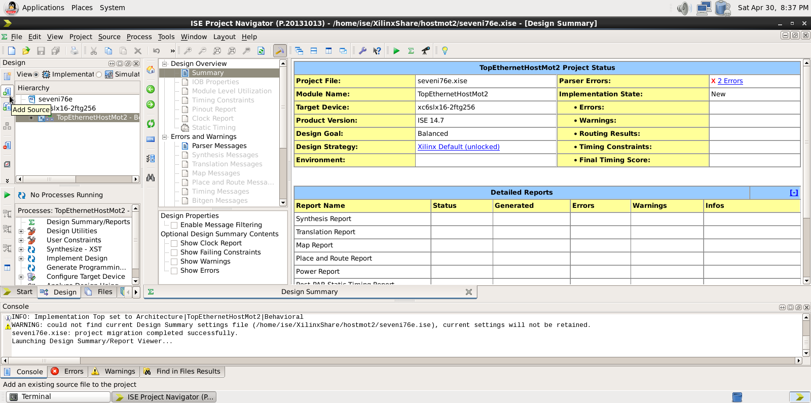

At this point I'd suggest checking that xilinx complies the file ok...
you will need to start up xilinx Project Navigator and browse to the firmware folder.
open the *.xise file that relates to your hardware (7i76e in my case)
you will need to add the newly created *.vhd file to the project.
it's the second button down on the LHS in the project bar (Add Source)
Add the file you created by coping and renaming as per above.
{I'll continue this over a few posts}
