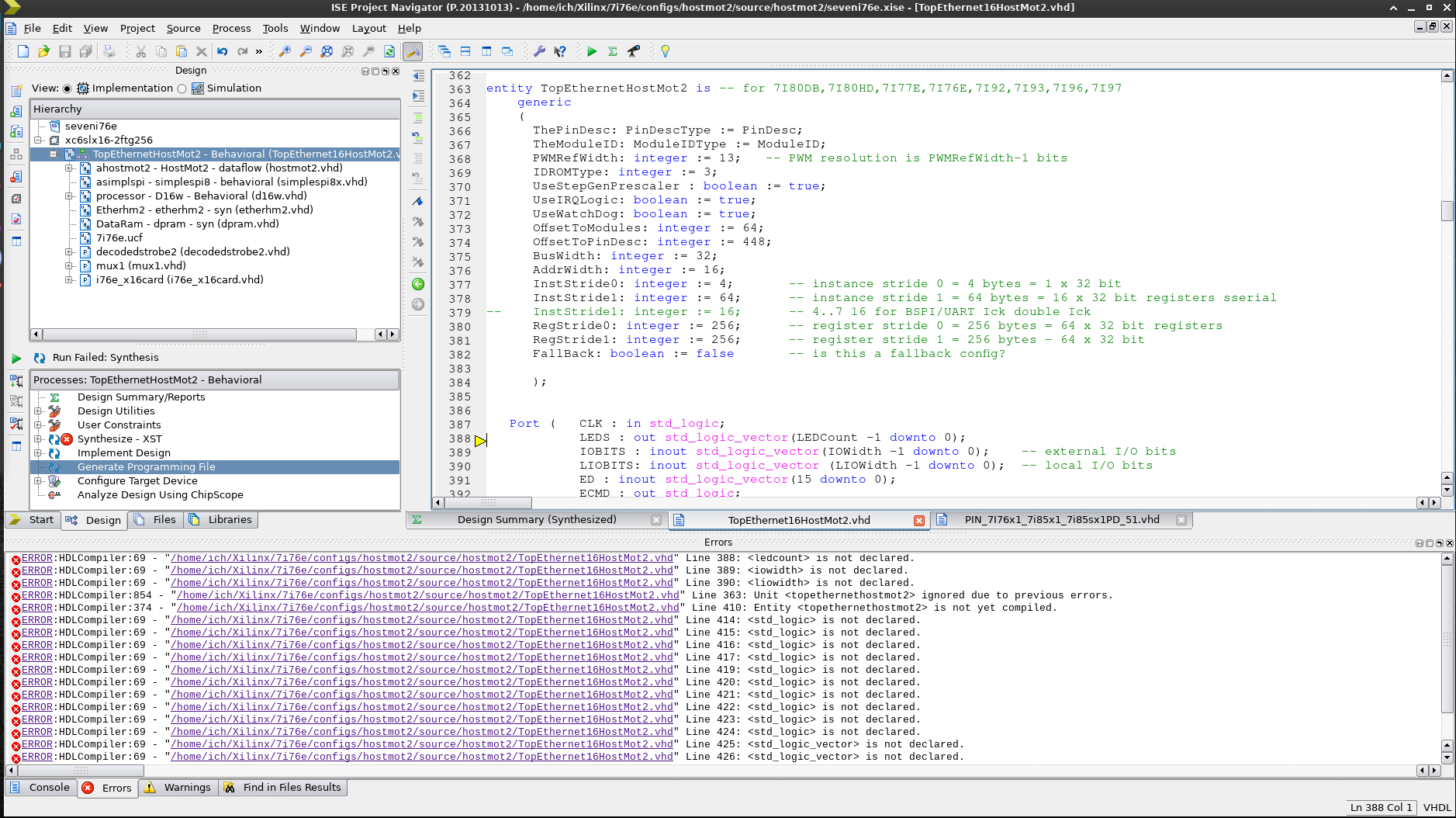

I also play around, but i get some errors. Does someone know how to fix it?
- Posts: 18100
- Thank you received: 5326
05 Aug 2023 17:19 #277026
Replied by PCW on topic Mesa + 7i76e + xilinix bitfile creation
That error means you do not have a pinout file selected (uncommented)
or if you have a new one selected, it has not been added to the project.

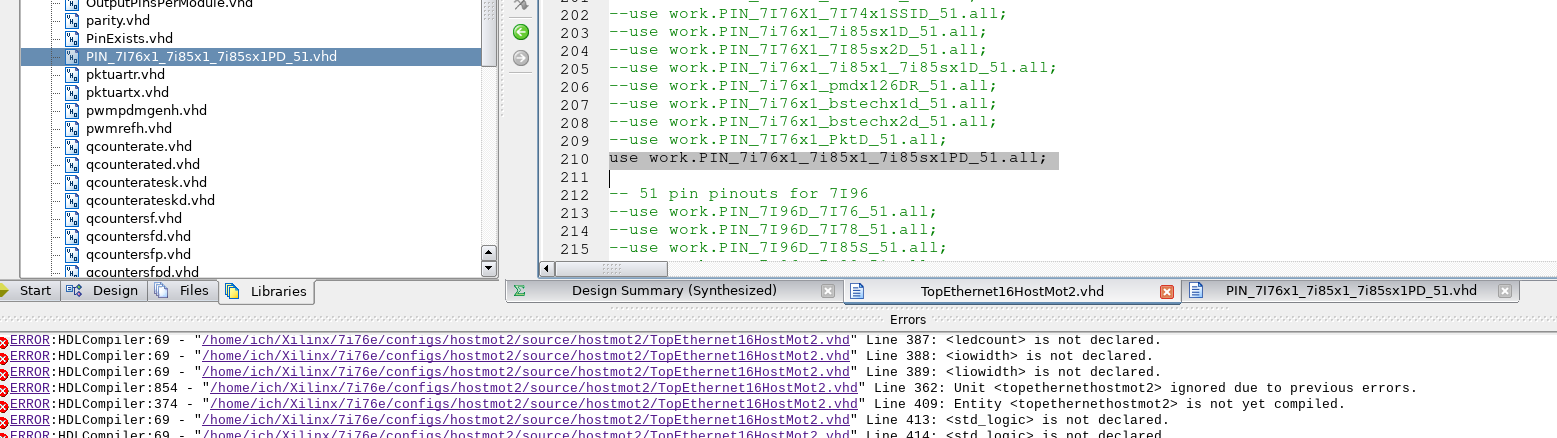

I had the file PIN_7i76x1_7i85x1_7i85sx1PD_51.all uncommented and added to the source. Is there some other file missing?
If File not in source i got error
ERROR:HDLCompiler:104 - "/home/ich/Xilinx/7i76e/configs/hostmot2/source/hostmot2/TopEthernet16HostMot2.vhd" Line 210: Cannot find <pin_7i76x1_7i85x1_7i85sx1pd_51> in library <work>. Please ensure that the library was compiled, and that a library and a use clause are present in the VHDL file.Please Log in or Create an account to join the conversation.

Do you have a card type selected?
- chris@cnc
- Posts: 529
- Thank you received: 140
05 Aug 2023 19:41 #277044
by chris@cnc
Replied by chris@cnc on topic Mesa + 7i76e + xilinix bitfile creation
Thank you, i forgot select one card type.
