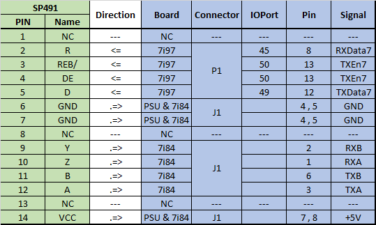

My second doubt is regarding the wiring between SP491 chip and both boards. I've compiled this table with pin mapping. I also attached a table with nomenclature equivalence. There are 3 different nomenclatures used to name RS-485/422 pins among datasheets. Very confusing.
Tomorrow I’ll post schematics and pictures so it will be easier to understand what I've wired so far.
Bruno

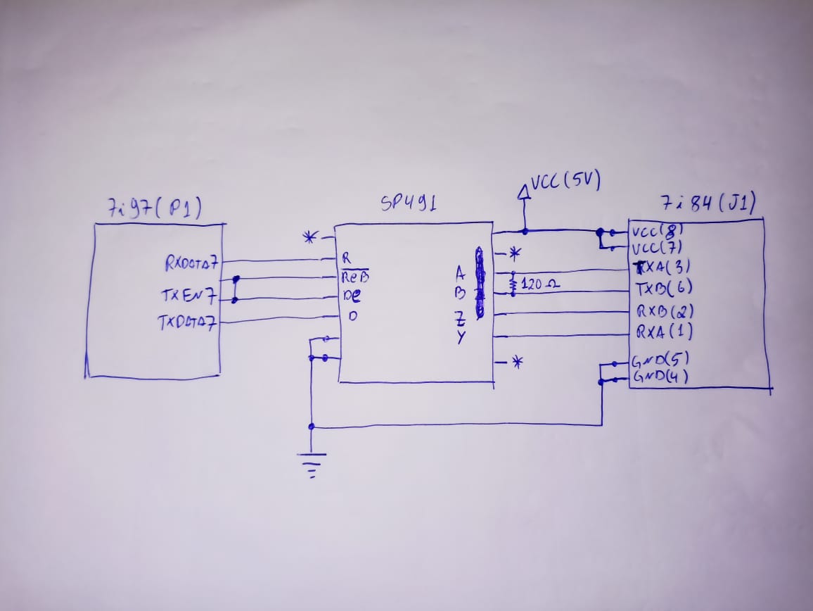

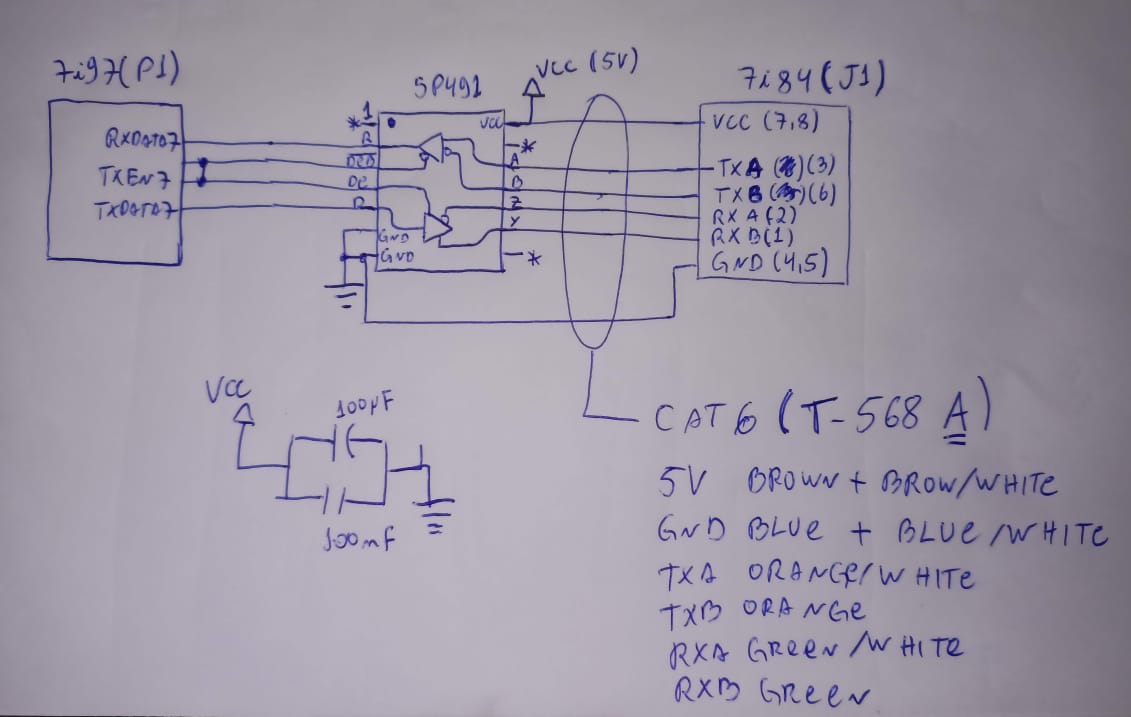

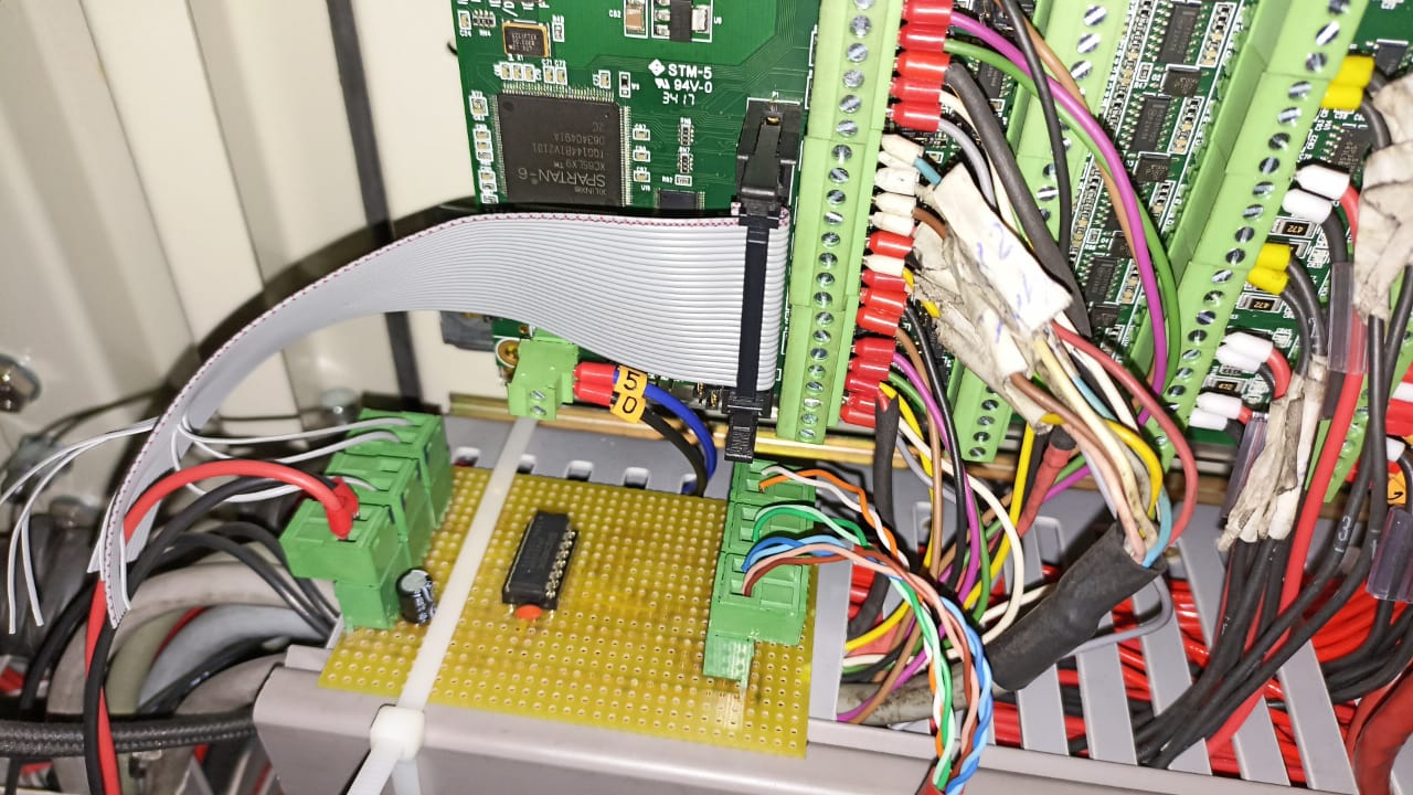

These are the schematics of the circuit I’ve build.
I haven’t added any terminating resistor so far! I was willing to test without them. Next step will be to add a 120 ohms resistor between A/B and Z/Y. Is there any other resistor required? I was thinking of something like 1k for Rpu and Rpd (according to image attached) but it is just a desperate guess.
I also attached a picture of the board.
Can any one guess what is wrong with my approach?
Thanks in advance!
Bruno

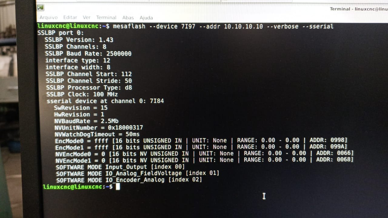

There was a mistake in the wiring. The atached table is correct now.
I have also added a 120 ohms terminating resistor between A and B. I compared to 7i97 rs485 output and there is 120 ohm resistance only between A and B.
I still won't appear in --sserial (--sserial output atached).
I wonder if PCW has any idea about what could possibly be wrong. I'll attempt to call Mesa and try to talk to someone. Maybe it is just some dumb mistake.
Thanks in advance!
Bruno

Tie /REB low and DE high
(dont use TXEN)
(dont use TXEN)

- ContinenteCNC
- Posts: 97
- Thank you received: 44
07 May 2022 21:41 #242269
by ContinenteCNC
Replied by ContinenteCNC on topic Expanding 7i97 Smart Serial Ports using SP491 chip
Great point!
It might be the one mistake!
What about the terminating resistors? I just added one 120 ohms in between A and B. Is it required to add another one in Y Z line?
I will try it out tomorrow again. I hope it works!
Thanks Peter!!
Thanks Peter!!
