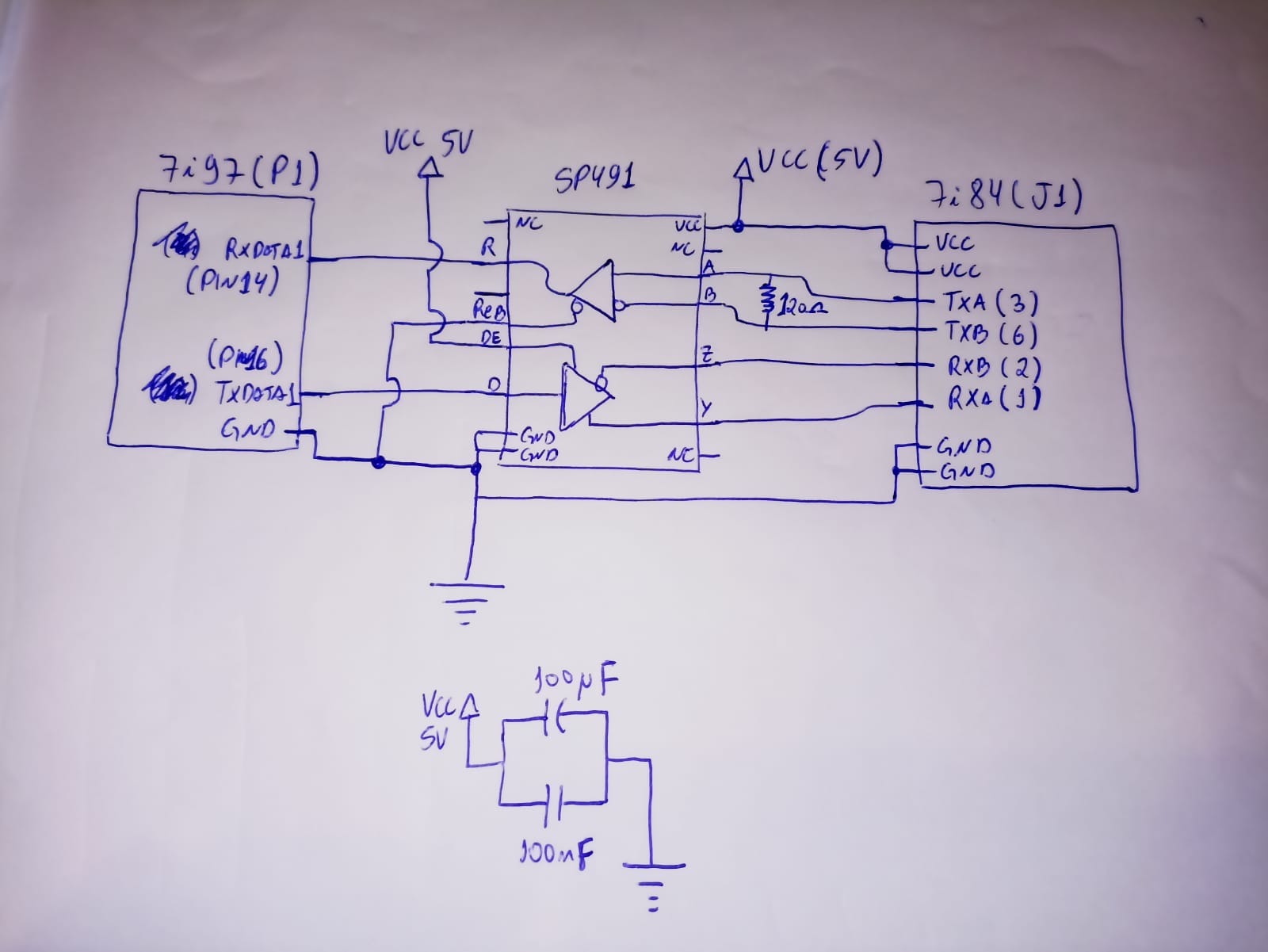

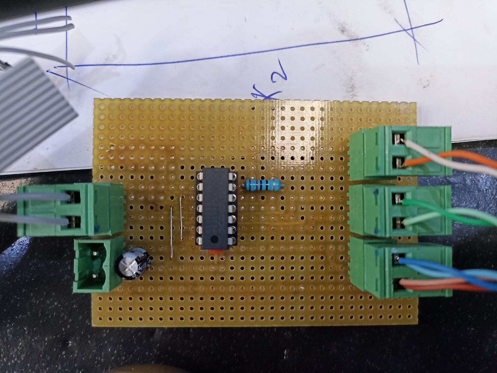

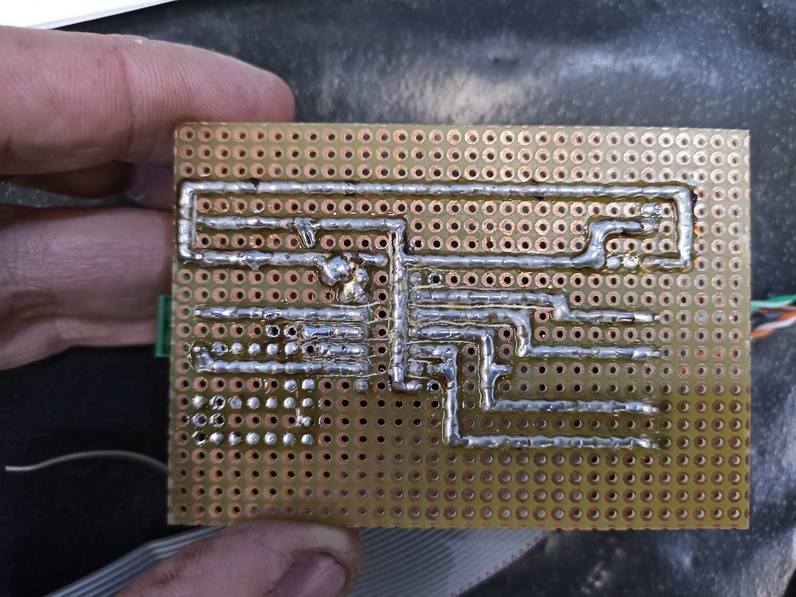

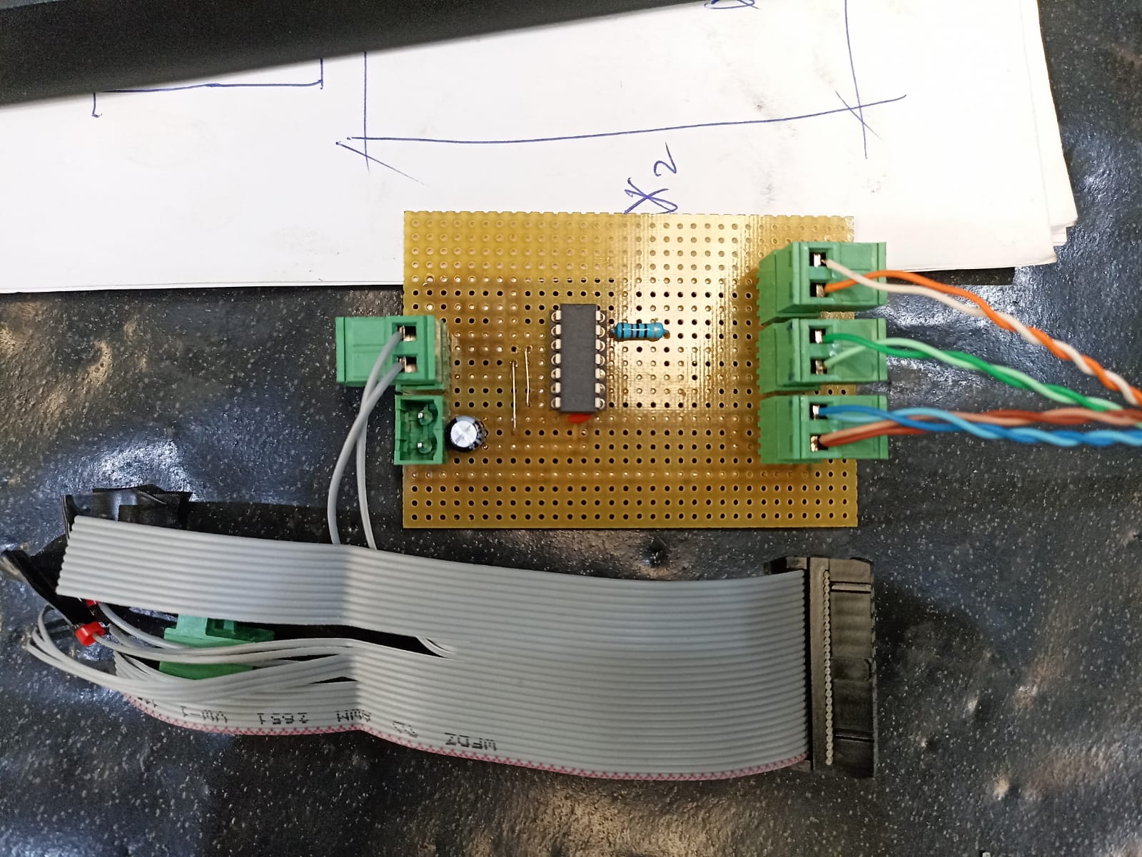

Unfortunately, it still won’t work. Only the first 7i84 show up on --sserial. The second one won't make a sound.
I tied REB and DE as you said. At first, I tried with a 10k resistor, it didn’t work. Then I tried with a jumper, didn’t work as well.
I can’t see what could be wrong.
There are a couple of pictures of the board attached, maybe someone could spot a mistake.

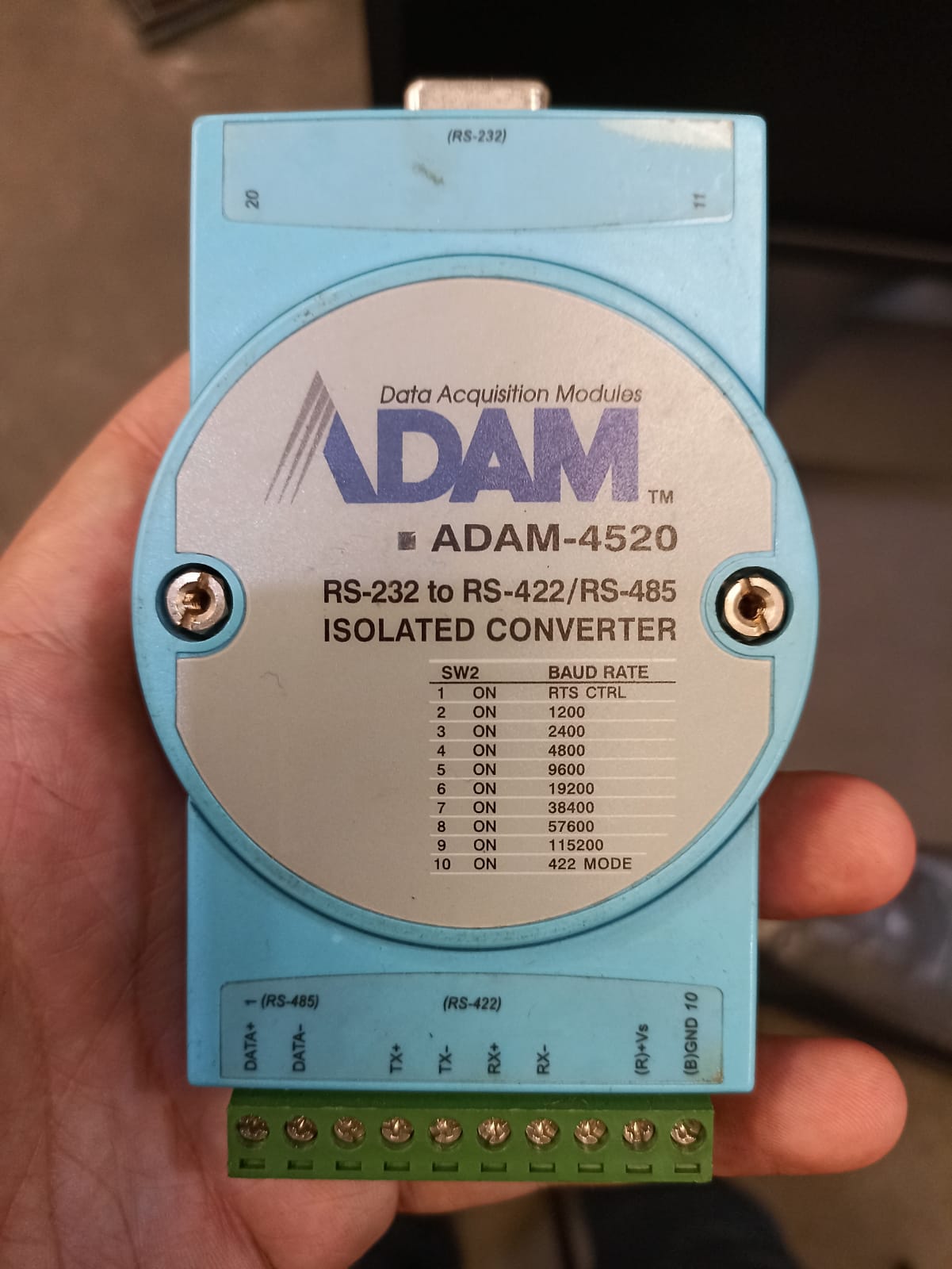

If it doesn’t work by the end of next week we will be abandoning this approach a moving to a modbus I/O expansion card instead.

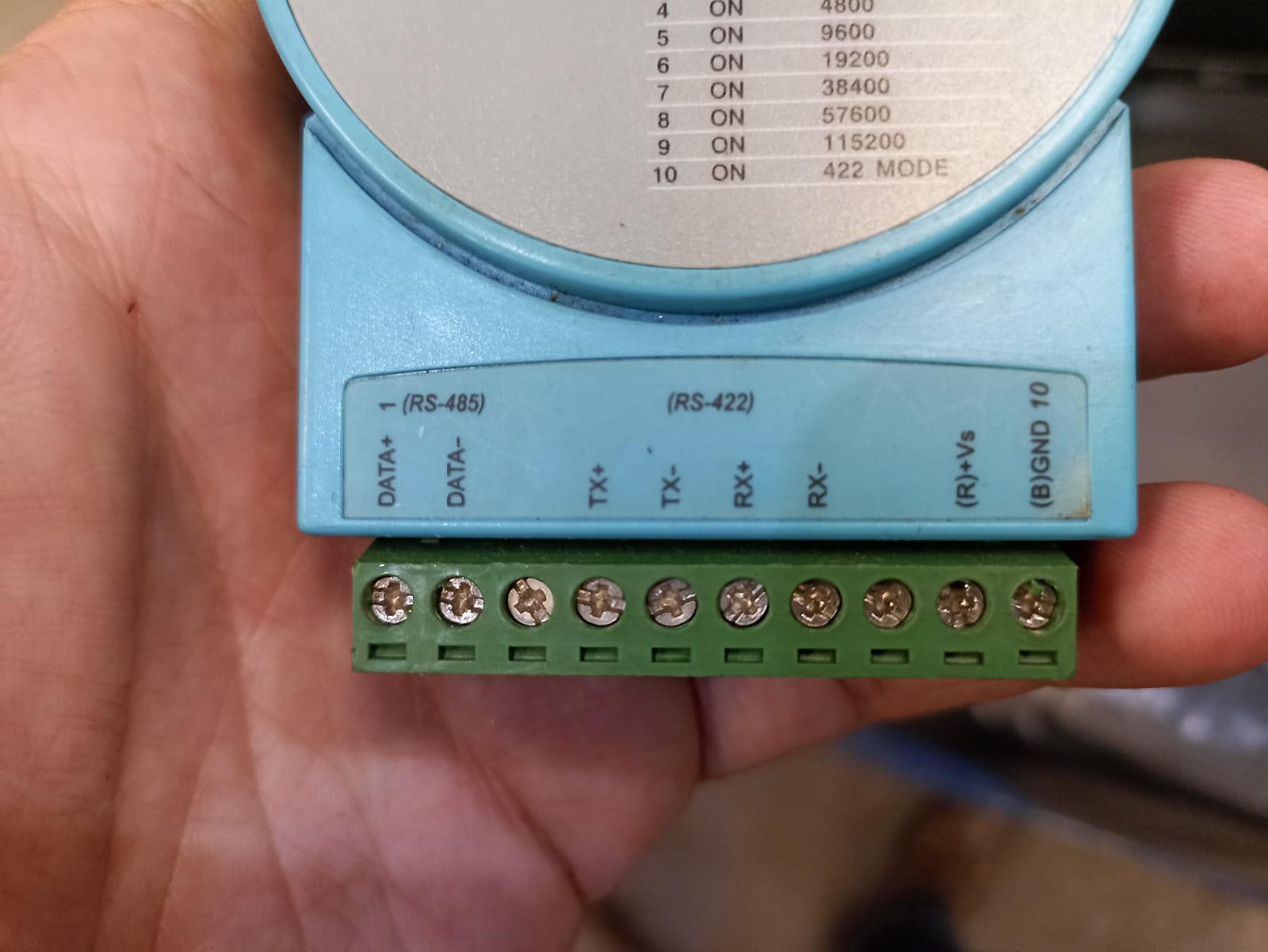

We thought about using one of this Adam RS232 to RS422 converters. They are also 4 wire full duplex, but the baud rate is not enough. Max is 115200 kbs. Mesa is 2.5 mbs.
I welcome any suggestion

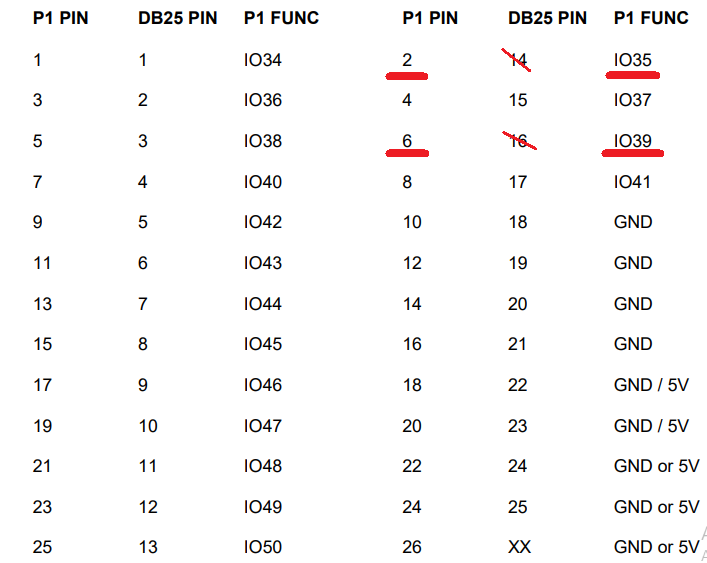

Are you sure you have the P1 connections right?
You are showing DB-25 pins, the HDR26 pins would be
RX1 --> 2
TX1 --> 6
RX1 --> 2
TX1 --> 6

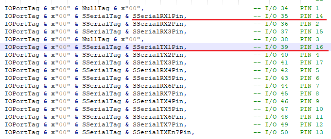

OMG, you’re so right! Shame on me!
I didn’t know there was such db25 adaptor… anyway.
I was following the vhd file pin mapping, now it all makes sense. I should have used the IO to P1 pin mapping in 7i97 manual.
Thank you! I’ll be trying it out tomorrow.
I’m confident it will work now!
Bruno

The latest version of mesaflash shows both the header and DB25 pins:
