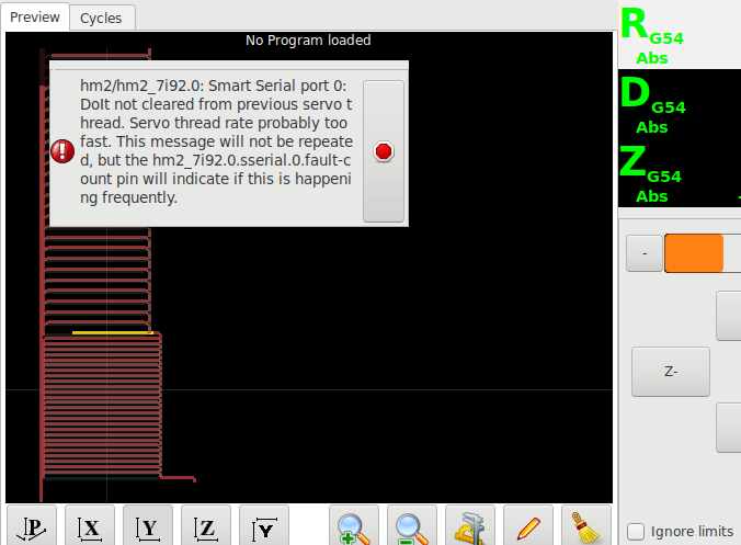

I also keep getting this error.
The computer is an HP8300, the fanduct is installed.
The latency test during installation was inconspicuous.
forum.linuxcnc.org/media/kunena/attachme...01-18at22.57.15.jpeg

Things to check:
-5V power supply
-servo period should be 1000000 (1 Million) in the ini file
-Network cable
-any of the 7i92 pins wired to a high load
-interference from VFD

Check all tmax values to see where the error lies:
( when LinuxCNC is running )
halcmd show param *.tmax
To interpret these values, the CPU frequency and the servo thread
period are also needed.

thanks
I will check the tmax values as soon as I am at the machine.
can it be due to an unsuitable cable between 7i77 and 7i73?
there was already a thin-wire shielded 24-pole cable in the machine.
with this I connected the 7i73 to the 7i77.
Only 8 wires of this cable were used for the serial connection, the other wires are unused,
But it runs parallel with the cables to the servo motors of X and Z.
The 7i73 still drives some control lamps, but with an uln2003 chip.
Maybe the 5V supply of 7i73 is too weak?

servo thread 1000000

What is the CPU speed?

OK so the timings look OK
Does your system have a Intel Ethernet chip?
What are your ping times if you ping the 7I92?

Is there a terminal command with which I can display my network chip?
ping 192.168.1.121
PING 192.168.1.121 (192.168.1.121) 56(84) bytes of data.
64 bytes from 192.168.1.121: icmp_seq=1 ttl=64 time=0.392 ms
64 bytes from 192.168.1.121: icmp_seq=2 ttl=64 time=0.240 ms
64 bytes from 192.168.1.121: icmp_seq=3 ttl=64 time=0.165 ms
64 bytes from 192.168.1.121: icmp_seq=4 ttl=64 time=0.221 ms
64 bytes from 192.168.1.121: icmp_seq=5 ttl=64 time=0.139 ms
64 bytes from 192.168.1.121: icmp_seq=6 ttl=64 time=0.226 ms
64 bytes from 192.168.1.121: icmp_seq=7 ttl=64 time=0.166 ms
64 bytes from 192.168.1.121: icmp_seq=8 ttl=64 time=0.120 ms
64 bytes from 192.168.1.121: icmp_seq=9 ttl=64 time=0.175 ms
64 bytes from 192.168.1.121: icmp_seq=10 ttl=64 time=0.281 ms
64 bytes from 192.168.1.121: icmp_seq=11 ttl=64 time=0.360 ms
64 bytes from 192.168.1.121: icmp_seq=12 ttl=64 time=0.116 ms
64 bytes from 192.168.1.121: icmp_seq=13 ttl=64 time=0.321 ms
64 bytes from 192.168.1.121: icmp_seq=14 ttl=64 time=0.385 ms
64 bytes from 192.168.1.121: icmp_seq=15 ttl=64 time=0.280 ms
64 bytes from 192.168.1.121: icmp_seq=16 ttl=64 time=0.289 ms
64 bytes from 192.168.1.121: icmp_seq=17 ttl=64 time=0.324 ms
64 bytes from 192.168.1.121: icmp_seq=18 ttl=64 time=0.336 ms
- Posts: 18103
- Thank you received: 5326
22 Jun 2022 12:55 #245593
Replied by PCW on topic Mesa 7i92 Dolt not cleared
Those ping times look pretty bad...
You might try:
dmesg | grep -i eth
You might try:
dmesg | grep -i eth
Time to create page: 0.345 seconds
