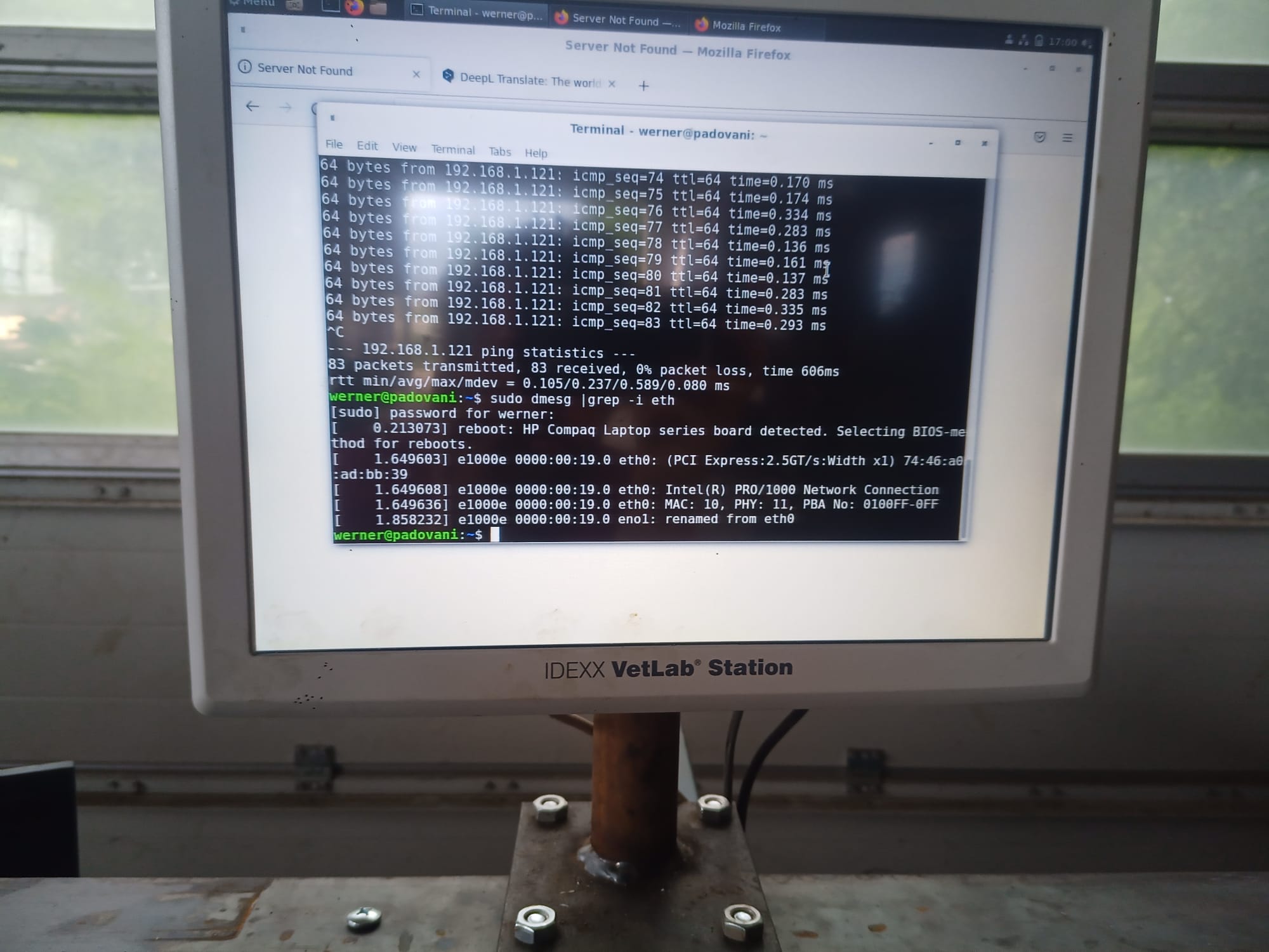

Mesa 7i92 Dolt not cleared

OK for Intel Ethernet chips, you must disable RX IRQ coalescing
This is typically done in the interfaces file
man hm2_eth
for instructions
Also you can try this temporary fix:
sudo ethtool -C eno1 rx-usecs 0
and then try the ping test / LinuxCNC again
(this fix will only last until you reboot)
man hm2_eth
for instructions

23 Jun 2022 06:44 #245655
by DoWerna
Replied by DoWerna on topic Mesa 7i92 Dolt not cleared
i added
auto eno1
iface eno1 inet static
address 192.168.1.1
hardware-irq-coalesce-rx-usecs 0
to /etc/network/interfaces
seems to work
the values are better now
ping 192.168.1.121

--- 192.168.1.121 ping statistics ---
19 packets transmitted, 19 received, 0% packet loss, time 452ms
rtt min/avg/max/mdev = 0.093/0.137/0.169/0.022 ms
are they ok now?
