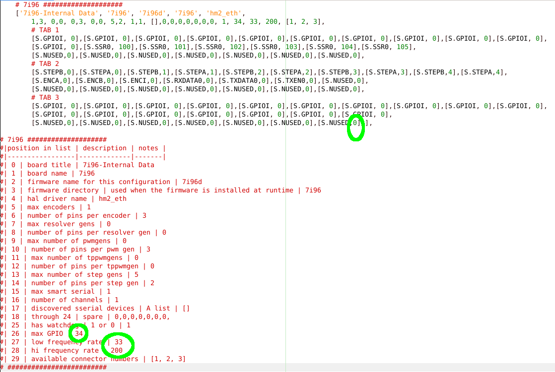

12 Jul 2022 08:43 #247126
by zz912
Replied by zz912 on topic Can I use 7i96s with LCNC 2.8
I am studying how adding cards to pncconf works. I decided to decode the 7i96 card.
File /home/zdenek/linuxcnc/linuxcnc-2.8/src/emc/usr_intf/pncconf/private_data.py:
I don't know where the data comes from to verify if it will be the same for the 7i96s.
max GPIO
low frequency rate
hi frequency rate
I couldn't decode the number behind the pin name in the list of component. I only found it called "logical number"
If InM and OutM can be controlled as GPIOs, I can't find a reason why 7i96s can't be added to pncconf 2.8 . The only thing that won't work are the InM improvements over the GPIO. Which would be acceptable to me.
max GPIO
low frequency rate
hi frequency rate

12 Jul 2022 20:42 #247183
Replied by PCW on topic Can I use 7i96s with LCNC 2.8
The GPIO (SB 51) and clocklow (SB 100) data are not correct for the 7I96
(so are probably not terribly important)
