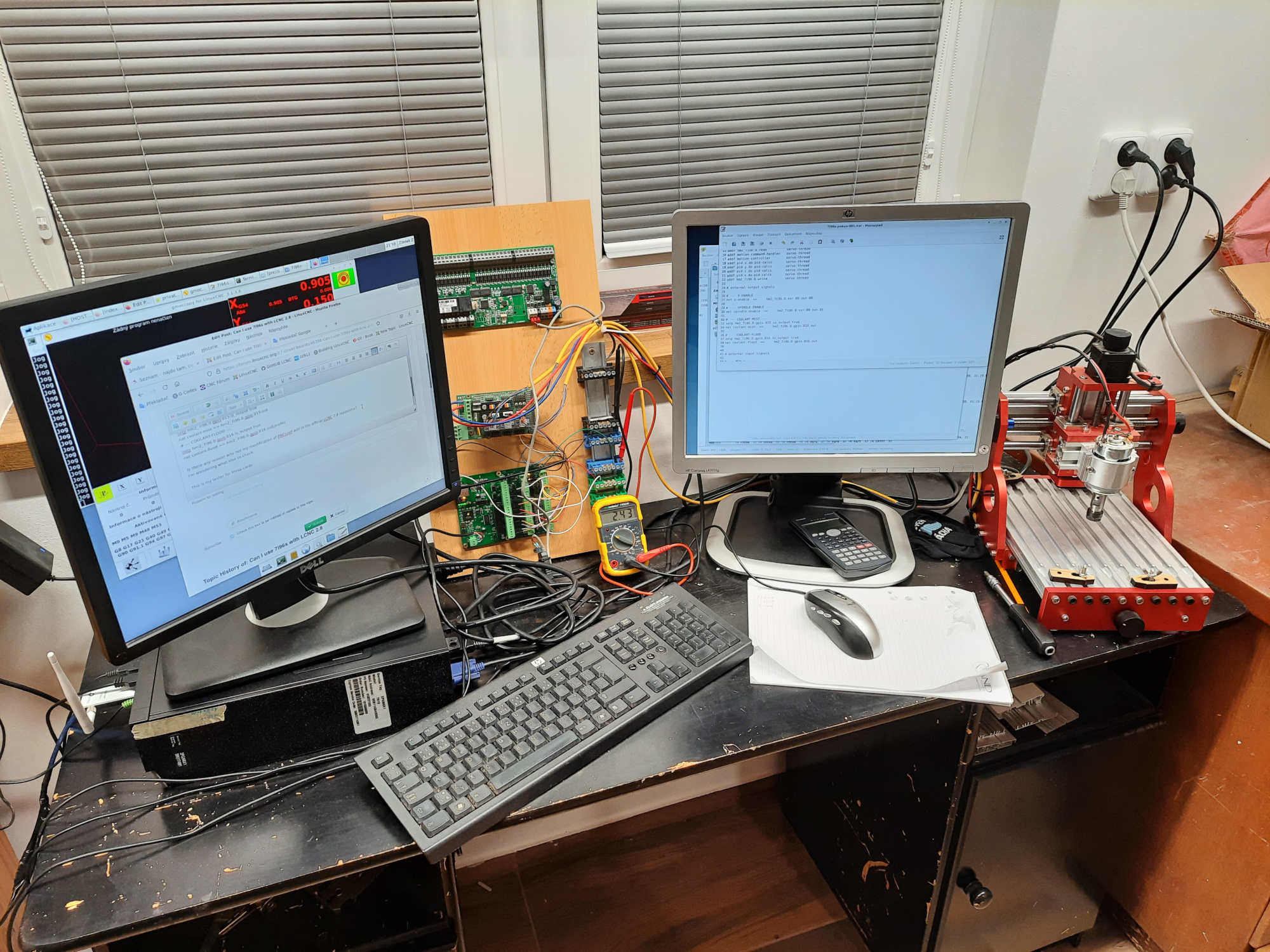

15 Jul 2022 07:52 - 18 Jul 2022 20:01 #247356
by zz912
Replied by zz912 on topic Can I use 7i96s with LCNC 2.8
I added card 7i96s to PNCconf LCNC 2.8
Analog output - works
InM - works
OutM - works - looks like:
I'm wondering what else to check.
I would like to add this modification to the official LCNC 2.8 repository. Is there any reason why not?
This is my Mesa card tester:
InM - works
# --- COOLANT-MIST ---
setp hm2_7i96.0.gpio.015.is_output true
net coolant-mist => hm2_7i96.0.gpio.015.out
# --- COOLANT-FLOOD ---
setp hm2_7i96.0.gpio.016.is_output true
net coolant-flood => hm2_7i96.0.gpio.016.outI'm wondering what else to check.
Last edit: 18 Jul 2022 20:01 by zz912.
