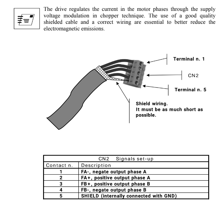

The video shows use of a cable for servos with an additional ground conductor. In the case of a 4 wire stepper system, some quality stepper drives require the shield to be terminated at the drive as this diagram from the manual of a Lam Technologies DS1076A shows.
Ref: www.lamtechnologies.com/Product.aspx?lng=EN&idp=DS1076

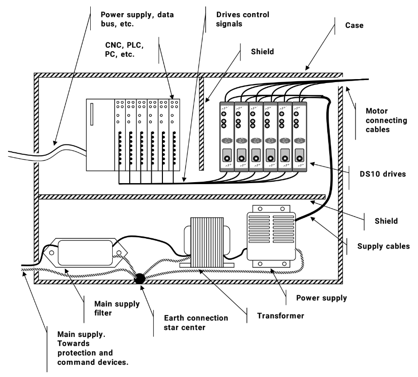

Elsewhere, they suggest the cable pass through the cabinet intact (eg. via a cable grommet)

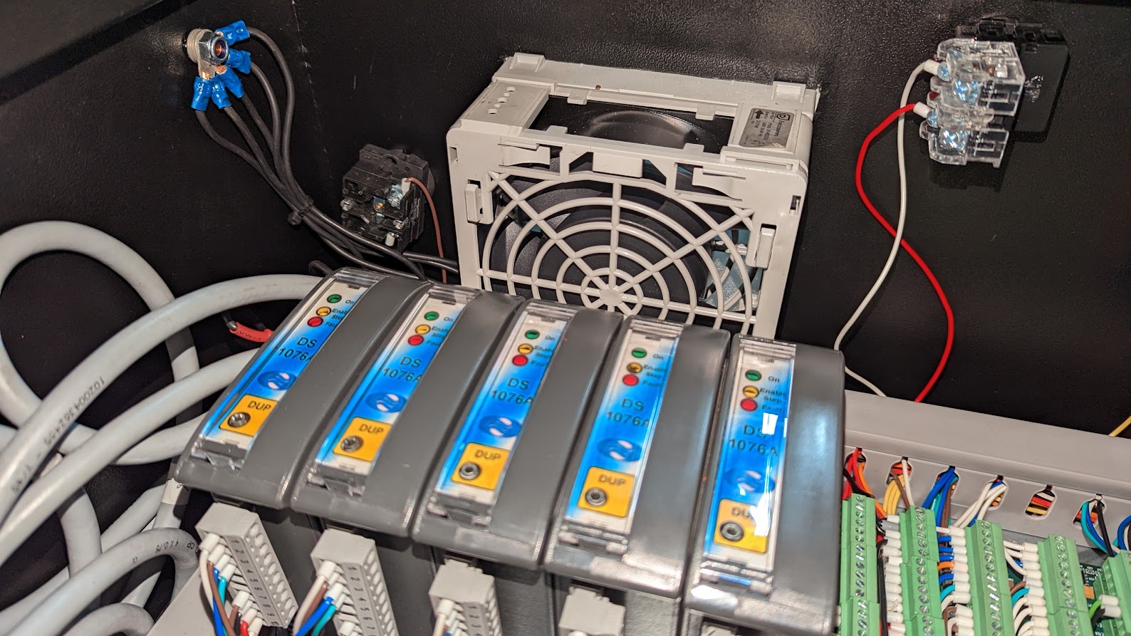

When I've used these drivers, I've also terminated the shield to a copper grounding post on the enclosusre as shown here.

So from my post above, I am still confused somewhat but it seems one thing that both Siemens and Lam have in common is not to use any connectors where the cables enter the cabinet. Elsewhere in the Lam manual it shows:
I guess use of a grounding clamps could be used instead of my pigtails to frame ground.
So best practice for both steppers and servos is not to do any soldering. Yippee! :)

Since the drives look to be insulated from the cabinet's grounded mount plate, connecting the shield with a clamp to the plate won't do you any good as I understand it. You are probably best off just following the instructions in the manual, paying close attention to the "it must be as much short at possible" part. :)
I don't see anything about EMC compliance in the publicly available documentation for those drives. Maybe it's in the User Manual that's behind a registration wall? *doh* Maybe these drives aren't designed to meet any specific EMC standard and controlling EMI is just an afterthought? Or maybe they are controlling the rise times of the motor driver FETs to not produce high frequency EMI in the first place (at the expense of more heat) and have calculated that the pigtail connection of the shield is enough. Who knows?

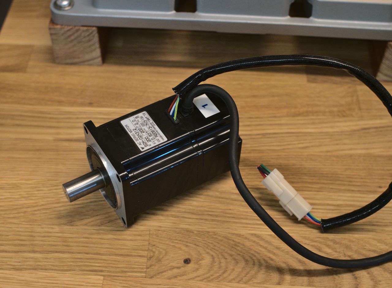

Yeah I have similarly been scratching my head about how to connect the shield to these old servos:
But after reading about how the shield is the return path of common mode noise between motor frame and drive, I think a good solution is to attach the incoming cable shield with a P-clip to the aluminium plate that the motor will be mounted to. That should provide a low impedance path from the motor frame to the shield. I hope. At least that's the best idea I've been able to come up with!
