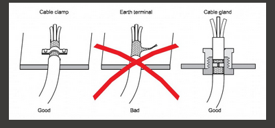

The document by hypertherm you linked is certainly valid and should be followed. But in my opinion it doesn't cover how to connect the braided shielding of a cable to ground and that was the question I was referring to.
So to recap my input, it is not recommended to attach a wire to the cable shielding and run that to a ground post.
This is another example from www.focusondrives.com/more-about-grounding-and-shielding/

I think my learning from this thread is the cable should be passed though using a simple cable grommet (no soldering ), the insulation should be pared back and a cable ground clamp applied. The cable should continue direct to the driver. If required by the motor driver, a short pigtail should be used to connect the shield at this point. Seems like an extra shield clamp should be applied near the driver too. Did I get that right?
At the motor connection, if it does not have custom cable connectors, I will continue to use the QC connectors (no soldering). They seem to work fine for 1.5mm cables and there are larger ones available if you need higher current. I use 4 pin housings but housings with more pins are available.
I might add this increases the size of the cabinet required fairly substantially, I struggled for room in a 500 x 500 mm cabinet. Using ground clamps would probably add another 200 mm in one dimension.

If you want to learn something from this thread I think it should be to see the shield as another conductor between the drive and the motor frame - except this conductor should have low impedance for high frequency signals, which necessitates wide 360° connections at both ends (and an otherwise unbroken shield).

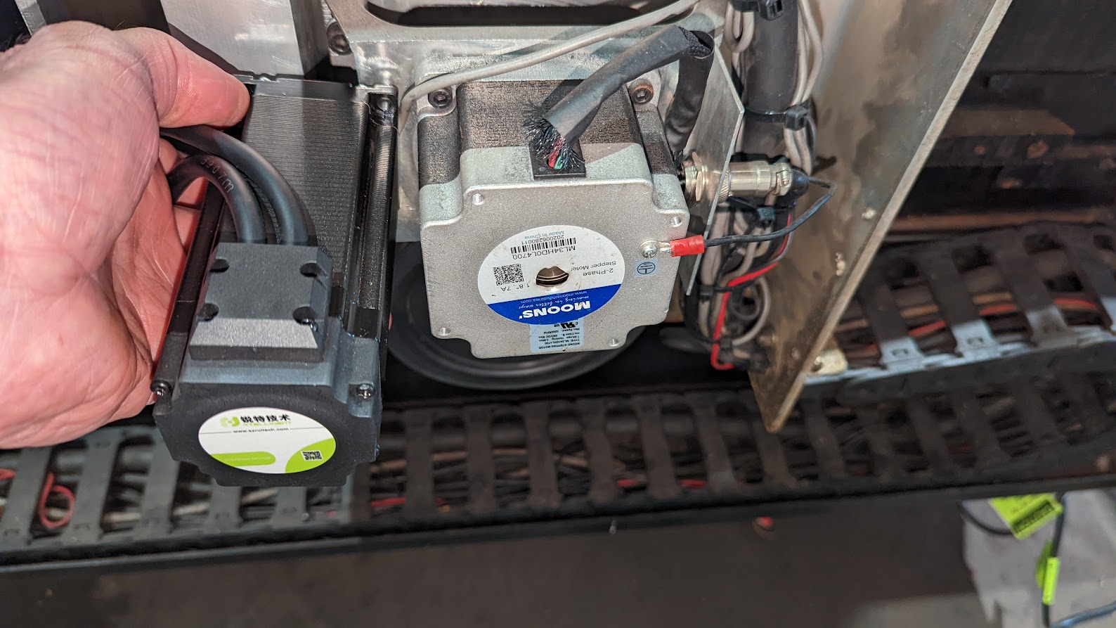

I suspect Seimens are talking about mains or 3 phase powered servos. Steppers use lower voltages. I think also from some images i've seen that Siemens have provision to attach the shield at the motor end. Stepper motors do not have this provision. Here is a pic of a couple of stepper motors.
The Moon motor (shown on my machine) has provision for an earth point which I've used. Its not a shield attachment point. This is a high quality motor, not the usual Chinese junk! The attached wire goes back to a star ground point on the frame. There are many views about shield treatment but the conventional advice for steppers I have seen and the advice of my HF electronics advisor is to connect the shield it at one end. I'll stick with that as this machine has been super reliable.
The ethercat closed loop stepper in my hand also does not have any provision and does not even use shielded cable for the encoder wiring.
