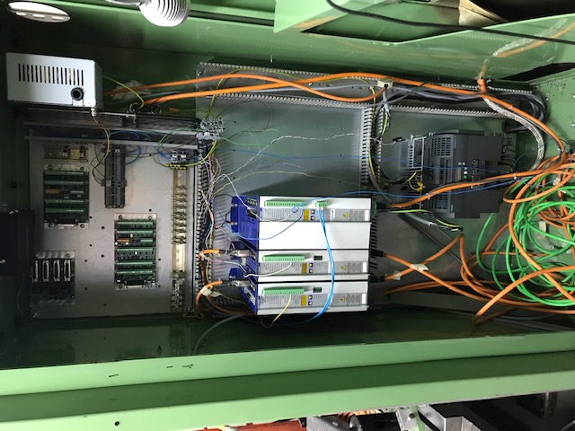

Hi, i wish a Merry Christmas to all the linuxcnc community.I have been working for almost a year on the mecanical aspects of this retrofit.New turcite, scraping, spindle bearings, adapting new servos on axis and so on...Now i just finished the wiring of the servos and spindle motor/drive.It's time to hook up linuxcnc and mesa cards with the following combo :7i80db 7i77 7i76 7i73.

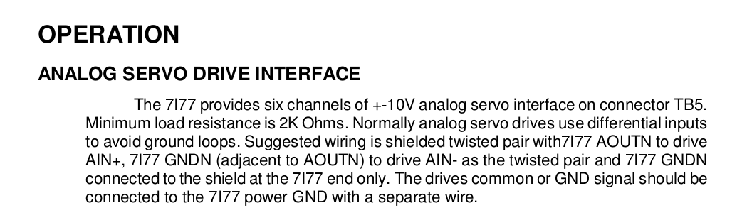

I use servostar S600 drives from Kollmorgen on all axis and i would like to control them in velocity mode with the analog /-10 of the 7i77 card.The position loop is done with encoders mounted on the ballscrews and connected also to the 7i77.
I'm really confused in the way the analog interface is described in the 7i77 manual.
If i get it right the wiring would be:
servostar Analog-in 1+ ---> 7i77 AOUTN
Analog-in 1- --->7i77 GNDN(adjacent to AOUTN)
AGND --->7i77 ?
Firstly it seem's there is a confusion in the in the manual between GNDN(in the descrition of the interface) and GND(connector description).
I'm searching which 7i77 terminal would be called CNC-GND from the servostar point of view and also to what terminal attach the shielding?

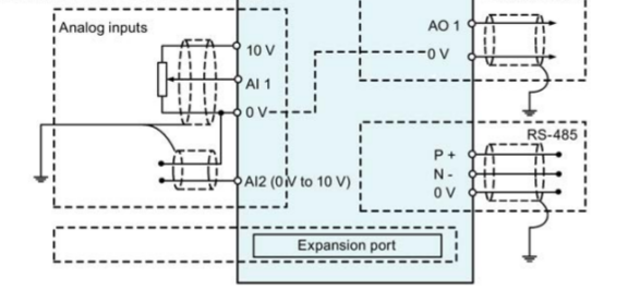

The spindle drive is Siemens sinamics S20.
Due to its ability to be driven in bipolar analog mode i would like to control it with 7i77 analog output to try to achieve M19 orientation with spindle encoder hooked to 7i77 or 7i76.
Siemens V20 Al 1 ---> 7i77 AOUTN
0V ---> 7i77 GNDN(adjacent to AOUTN)
GND --->7i77 ?
Again i'm confused with how to wire up the digital ground and the shielding.
GND --->7i77 ?

The 7I77 GND needs to be connected to CNC ground to establish the common mode
for the analog signals.
You could do this by connecting the AGND pins to both IN- and CNC-GND pins at the
drive end.
drive end.

Hi PCW, If i get you right my drives have differential input but the 7i77 has no differential output.
The 7i77 GND is the GNDN terminal adjacent to the AOUTN terminal and this is where i connect my CNC-GND and shield?
- Posts: 18100
- Thank you received: 5326
24 Dec 2023 17:05 #289009
Replied by PCW on topic Mesa 7i80DB to retrofit 4 axis VMC
Yes, that's correct.
