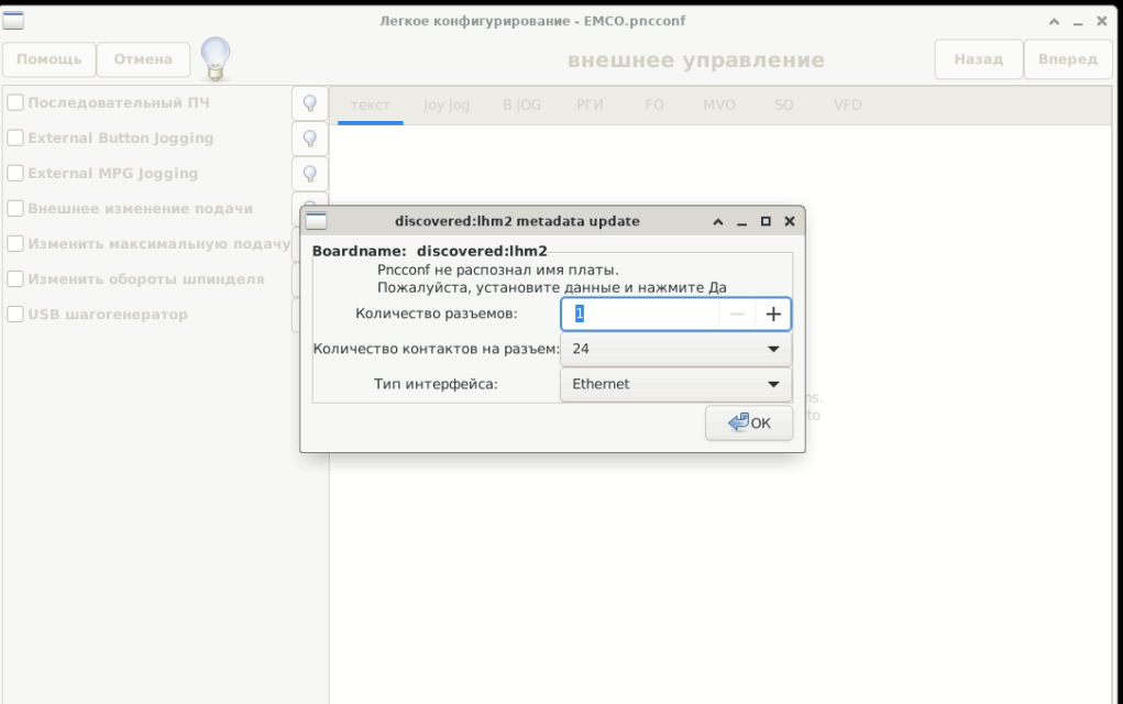

The first time I uploaded the configuration from the example rv901t_4out__3stepgen_2enc_1pwm. Another time litehm2.
The pinout changes, linux sees it, identifies the lhm2 board through a search, but for some reason it asks for how many connectors and ports, I indicate 3 to 24.
LinuxCNC 2.9.2 LiteHM2 board include

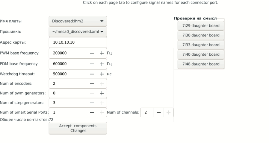

New variety.
Here I understand there are problems with the settings.

Replied by PCW on topic New project, litehm2: a hostmot2 port to linsn rv901t
Is it possible you have disabled the pwmgen in the hal file?

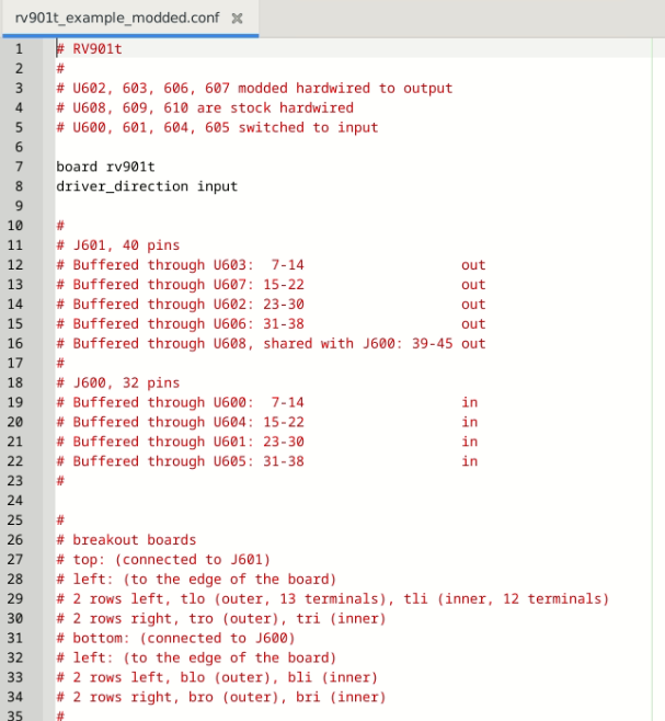

25 Jun 2024 23:12 #303795
Replied by Cant do this anymore bye all on topic New project, litehm2: a hostmot2 port to linsn rv901t
Mate if you read the README on the GitHub page you will find out what do with the bin & bit files.
You also need to read the section about updating the Linuxcnc driver.
It helps to read, understand and implement the instructions that the developer gives.
The developer recommends Linuxcnc 2.10 or a patched version of 2.9.2

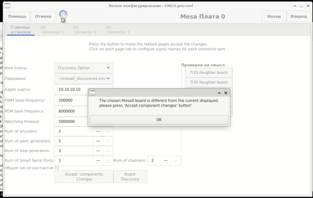

02 Jul 2024 11:47 - 02 Jul 2024 12:11 #304240
by dzik
Replied by dzik on topic New project, litehm2: a hostmot2 port to linsn rv901t

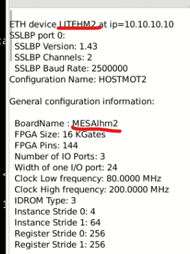

Help me please. I could not get.
I installed the mesaflash patch, it refused to see the board, mesaflash from LinuxCNC saw the board.
If I find the board, apply it and close it, the board starts with errors in the hal file, as I showed earlier, after restarting pncconf, and this window appears, the board stops starting.
Replacing it in the hal file does not help.
Then I noticed that when I search for the board through pnconf via DiscoveryOptions, it finds it:
What seemed strange to me is that the name of the board is MESAlhm2
Why?
Because after I clicked AcceptChanges, it gave me an error.
And then I noticed that if you select the lhm2 board then everything works, perhaps this is the correct procedure. However, there are doubts that it is possible that on the initial firmware of the board I specified this name for myself, and this entails a number of errors.
Because The developer's instructions are outdated because it does not have board.conf and litehm2.bit.
From the current examples, it was not possible (initially) to install the firmware. I installed litehm2 which is here for XU. Then the board started up.
When I install other bit files they go through and the config changes, but something is wrong.
Now in the example configs the name of the board is RV901t
Why?
