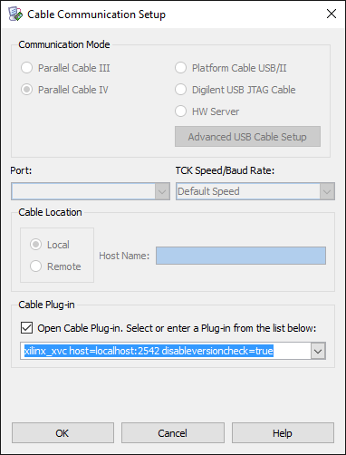

I didn't have a programmer at hand and found a very cheap option xilinx virtual cable.
It flashes perfectly. You just need to solder another contact to the ground on the board.
TDI = 4, TDO = 5, TCK = 6, TMS = 7, GND
Author's page where you can download gitee.com/xiaowuzxc/ESP32-XVC
"Over-the-air" programming over ESP32-C3
For IMPACT ise configuration JTAG spartan 6 xc6slx16
Can also configure for programming in flash memory in impact
Your host can find out from any program for scanning the ip environment.On my phone WOM WIFI
For example IMPACT
xilinx_xvc host=host=192.168.0.103:2542 disableversioncheck=true
If there is no ISE Xilinx there is a standalone programmer openFPGALoader
For openFPGALoader configuration spartan 6 xc6slx16
Write-flash JTAG to SPI bridge -f
sudo openFPGALoader -c xvc-client --ip <your ip> --port 2542 --fpga-part xc6slx16 -f <your bit file>
Write-sram JTAG -m
sudo openFPGALoader -c xvc-client --ip <your ip> --port 2542 --fpga-part xc6slx16 -m <your bit file>
For example
sudo openFPGALoader -c xvc-client --ip 192.168.0.103 --port 2542 --fpga-part xc6slx16 -f rv901t_4out__3stepgen_2enc_1pwm.bit
sudo openFPGALoader -c xvc-client --ip 192.168.0.103 --port 2542 --fpga-part xc6slx16 -m rv901t_4out__3stepgen_2enc_1pwm.bit

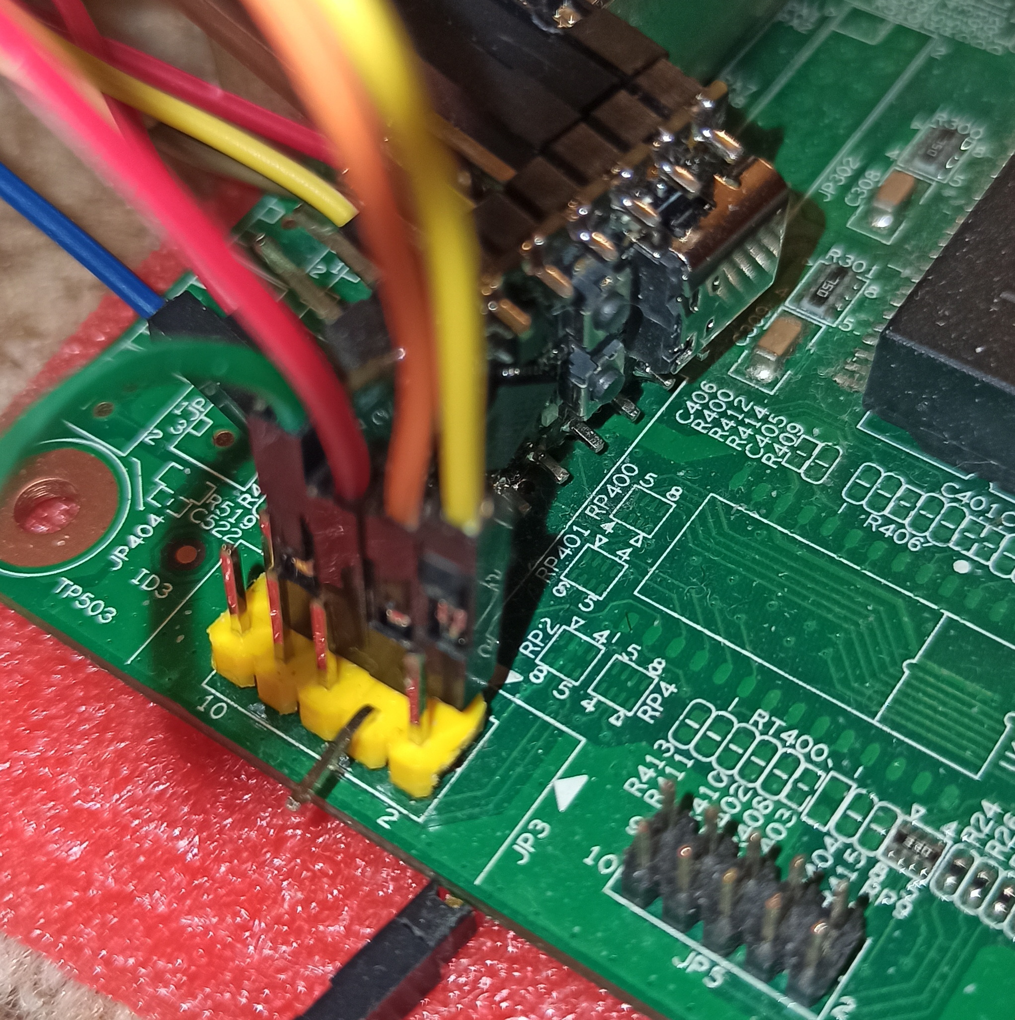

Hoping for some advice, things to check.
I have In rv901t board running, correct firmware, i disabled most os the mdb2hal stuff in hal to get it to run. I have modded the board as posted on this post, the j601 port works for outputs and tests well. However the j600 port isn't working as input. If i mod my hal file so one of the inputs (on the j600 port) is an output it works as one. ( setp ***** is_output true. - or something like that) shouldn't the firmware be setting it as input?
edit # found the problem, page 8 note that the bit file on github is not suited to a modded board. So use your own created bitfile or the page 8 one.
