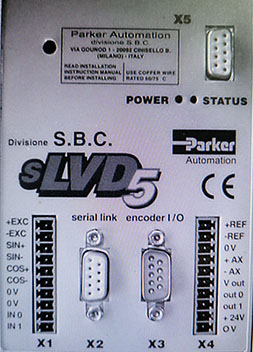

Hello friend , please to meet you all !
I have a CMS waterjet and I would like your help on what to buy on MESA.net site to make a working machine like it is suppose to be , i would like to keep the original drive ( SLVD2 parker with parker servo motor and resolver , and a compatible linuxcnc board with a lot of IO and axis7 the capacity of feed back to linuxcnc for the real positionning. (Absolute like encoder ) =14.0pxLet me know what is the best working and compatible setup you would sugest to me ! A link for the parker drive info .Best regards ,Fred
www.parkermotion.com/products/Servo_Driv...30_32_80_567_29.html

After a quick peek at the drive specs is has + - 10V analog input for servo control.
It also mentions a real time CanBus control as well but not sure without reading all the details if that may also be used for speed/position control.
You mention resolvers as well as absolute encoders. Please clarify which type that you wish to use for position feedback.

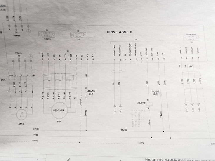

Hello Bari , the servo motor are equipped with resolver , I can't cut with it but the machine work fine and the position is kept all the time , if you push the Estop the drive are desactivated , you can push with your hand the bridge yaxis and you can move it and the position is in real time moving like absolute encoder , the reason of the retrofit is I can't export gcode for the machine it use propriatary iso files to work and the CMS industry is not very helpfull so I am willing to change the control to make it compatible with gcode files. The drive use Step & direction input for position control and 24 Volt to actived and i assume RS422/485 communication for the feed back positionning.
- Posts: 18100
- Thank you received: 5326
01 Feb 2023 23:38 #263478
Replied by PCW on topic Water Jet 5axis using Parker servo drive what mesa board setup?
If you get position feedback when the drives are disabled, I suspect they are running in analog velocity mode with simulated encoder feedback from X3

Using Mesa hardware, I would suggest a 7I92TM+7I77,
but I would first verify than the drives are indeed setup for
analog velocity mode, that is, if the drives analog input was
connected to the controller.

I have confirm with the data sheet and servo number , resolver it is .
Drive spec and encoder simulation RS-422 steps/rev 4...2500mode it is !
Power Supply V~ 230 ± 10%
Control Voltage V= 24 ± 10%, 1 A
Models SLVD2
Rated Output Current A 2,5
Peak Output Current (4 s) A 5
Internal Braking Resistor
Feedback resolver (speed 1)
Power Stage Switching Frequency kHz 8
Maximum Output Fundamental
Frequency Hz 450
Protection IP 20
24 V Digital Inputs No 2+2
24 V / 100Ma / PNP Digital Outputs No 2
Encoder Simulation RS-422 steps/rev 4...2500
Frequency / sign or Encoder Input kHz 800 / 200
Analogue Reference V ±10 differential
Auxiliary Analogue Input V ±10 differential
Auxiliary Analogue Output V ± 4,5
Serial link RS-422 / RS-485
Field bus CanBus ISO/DIS11898
I have just bought the 7i96S and the 7i77 card will it work ? or i need the 7i92MT?

Yes, the 7I96S will work
