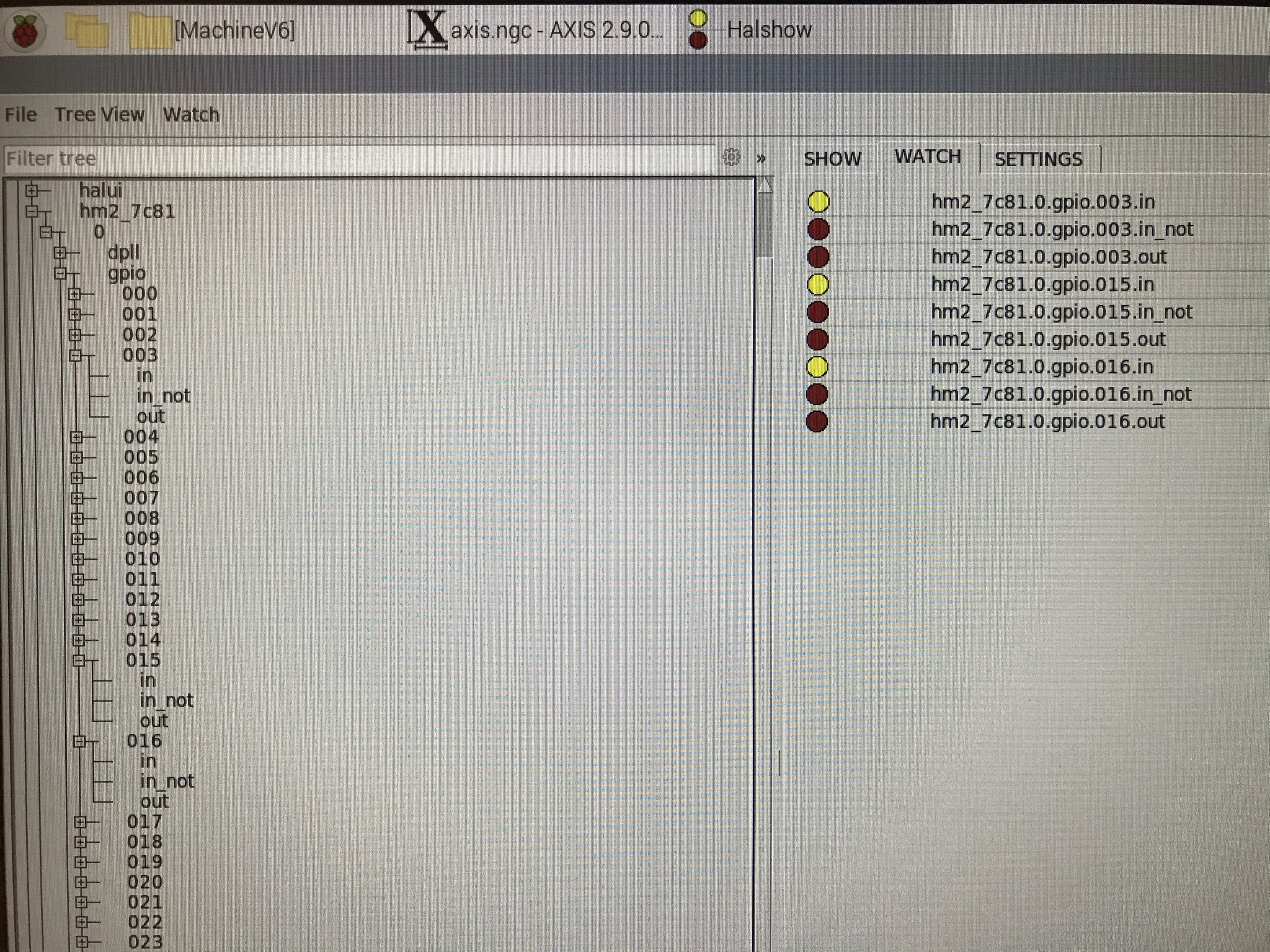

Use the "show hal configuration" from the "machine" menu, on the right side choose "watch", on the left side navigate to "pins" and find the mesa input pin, click on it.
Now on the right side watch the LED if it changes color while you manually activate the sensor.

Thank you for the advice, today I had the chance to try it out.
I have connected a limit switch to pin 12, 13 and 15 (not simultaneously), but although the LED on the limit switch itself changes color, none of the LEDs in the "Show HAL configuration" window (see screenshot) changed color.
Both the limit switch and the BOB are powered with 24V. I am pretty sure that all the wiring is right, so it is difficult for me to understand where to look for the problem unfortunately.

12 Jul 2023 21:09 #275300
Replied by tommylight on topic BOB wiring
Upload the hal and ini file here so we can have a look.

- Posts: 18093
- Thank you received: 5325
12 Jul 2023 21:56 #275305
Replied by PCW on topic BOB wiring
Do you have 5V power supplied to the BOB?
Can you check the signal at the BOB DB25 pins?
