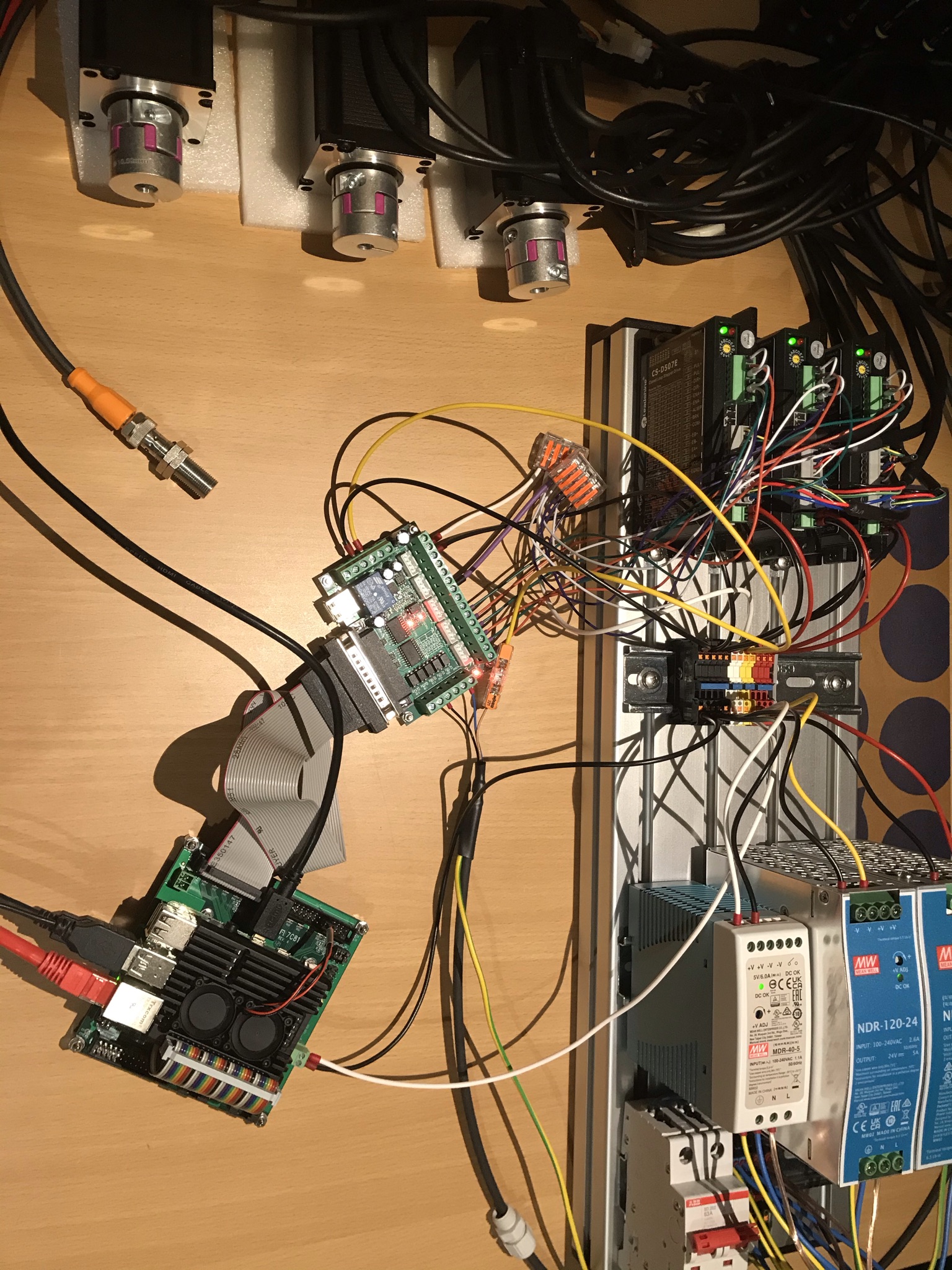

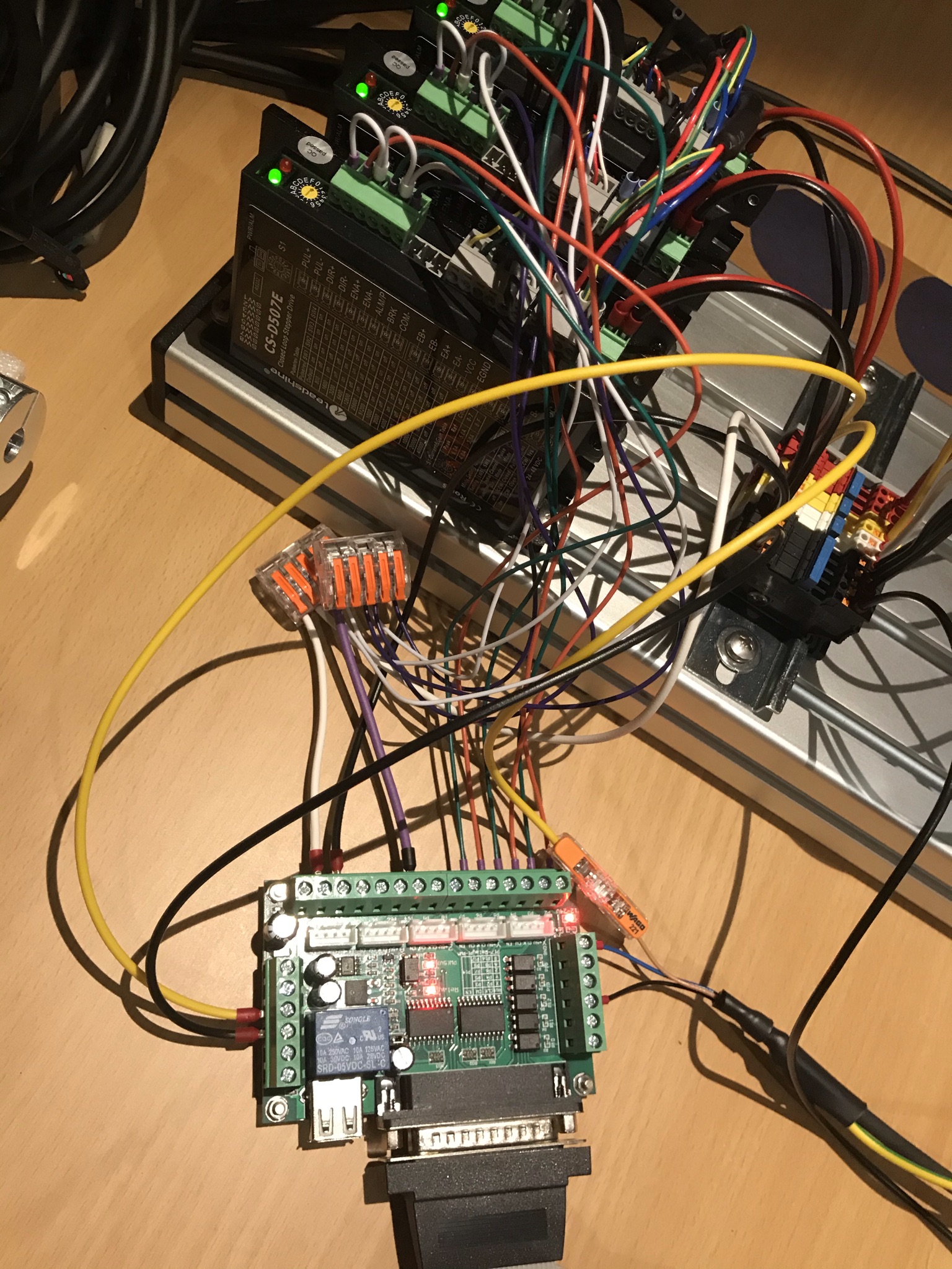

With the BOB connected to the Mesa card, I measured the voltage between HDR26 pin 10 and pin 23 (via the soldered pins on the underside of the Mesa card).
This is 5V, and activating the limit switch does not change this voltage. The limit switch is connected to pin 12 of the BOB.
With the BOB completely disconnected from the Mesa card I still measure this 5V between HDR26 pin 10 and pin 23.
The BOB is supplied with 5V.
I attached some images, just to show my test setup. The colors of the wires correspond to:
Black: GND
White: 5V
Yellow: 24V
Red: 48V
Orange: PUL-
Green: DIR-
Purple: ENA-

I am using a PNP normally open limit switch. The voltage between sensor pins 3 and 4 (measured on the BOB screw terminals) is 9.4V when the sensor is not activated, and 23.4V when the sensor is activated.
Sensor pin 1 is wired to the +24V from the power supply.
Sensor pin 3 is wired to GND of the BOB (so it is directly connected to the GND that is used for the 5V Mesa power supply, the 5V / 24V BOB power supplies and the 48V stepper motor power supply).
Sensor pin 4 is wired to BOB pin 12.

The BOB inputs expect a connection to ground to operate
(so a NPN sensor)
(so a NPN sensor)

Aha I see, yes then that will be the mistake, thank you for the help!
Most CNC/automation webshops in my area have much more choice in PNP sensors than NPN, so I thought PNP was more standard.
I am wondering whether I need a normally open or normally closed switch (there is no manual available for the BOB).
