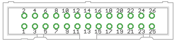

01 Aug 2023 04:21 #276681
by nwallace
Replied by nwallace on topic 7i92 firmware editing
Just want to make sure that I have this right. Does the first attached image (26pin header.png) match the pin layout on the 7i92t? Or does the second (alternative 26pin.png)?
- Posts: 18100
- Thank you received: 5326
01 Aug 2023 04:40 #276682
Replied by PCW on topic 7i92 firmware editing
Some of the pinout files show both HDR26 and DB25 pinouts:
-- P2 26 HDR DB25
IOPortTag & x"00" & NullTag & x"00", -- I/O 0 PIN 1 PIN 1
IOPortTag & x"00" & NullTag & x"00", -- I/O 1 PIN 2 PIN 14
IOPortTag & x"00" & NullTag & x"00", -- I/O 2 PIN 3 PIN 2

That is the DB25 pinout listing shows the DB25 pins when connected to a
flat cable terminated at one end with a HDR26 and the other with a DB25

05 Aug 2023 03:05 #276960
by nwallace
If I wanted to add a smart serial port, how many pins do I need? In some configurations I see that I need 4 (7i76) and in others I only see three (7i96S). I assume I would just need to replace one of the nulltag lines in the module section with one of the sserialtag lines copied from another config and then map the pins I want to use.
