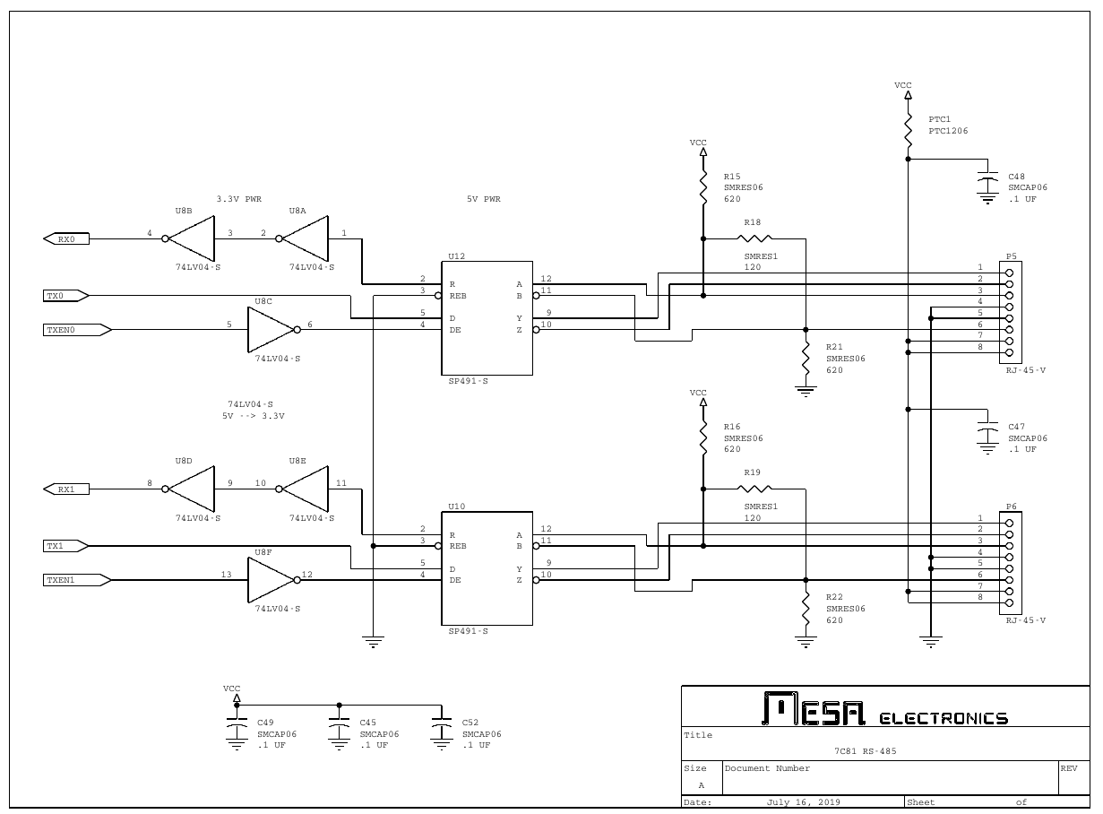

Ah, I see. So I would need to make my own pcb that pulls out the proper pins with a transceiver chip to make a 7i84 work. Thanks for your help!

Another quick question. Is there any reason why I couldn't just use a SP490 instead of a SP491 if I am only trying to connect to Mesa SSerial devices and not generic RS485?
18 Aug 2023 21:42 #278417 by PCW
Replied by PCW on topic 7i92 firmware editing
Sure, for SSerial or RS-422 only stuff (abs encoders etc) a SP490 is fine

I want to add modbus to 7i92TH I have received my 74LV04 and SP491 ic's today. Can I connect the RX0,TX0 and TXEN0 to 7i92TH io pins after the Pi5c16211 ?
30 Aug 2023 15:24 #279384 by PCW
Yes, and no level shifting /inversion is needed (so no LV04s )
Also for MODBUS and its low baudrates its better to disconnect
the 120 ohm termination (say a jumper option to disconnect R18
(leaving  the pullup/pulldown resistors connected)

If i wanted to connect MODBUS A/B from slave to SP491 since there is only 2 wires will i connect A/B to TX+/RX+ or TX+/RX- ?

Is it also possible to replace the SP491 with MAX485 ?
31 Aug 2023 13:26 #279471 by PCW
TX+/RX+ to B
TX-/RX- to A
Yes a MAX485 or equivalent will work for RS-485 (modbus etc) but not for sserial which is RS-422
On the MAX485, /RE needs to be grounded and DE needs to connect to TXEN
The following user(s) said Thank You: Donno

If i get Modbus working how does linuxcnc interact with modbus ? I have a lathe with usb dongle to modbus i use mb2hal.ini

Will the SSerial use mb2hal.ini file ? If so how would the settings look like ? Here is my --readhmid

No, you would use firmware with a UART (PktUART) on the RX,TX and TXEN pins
