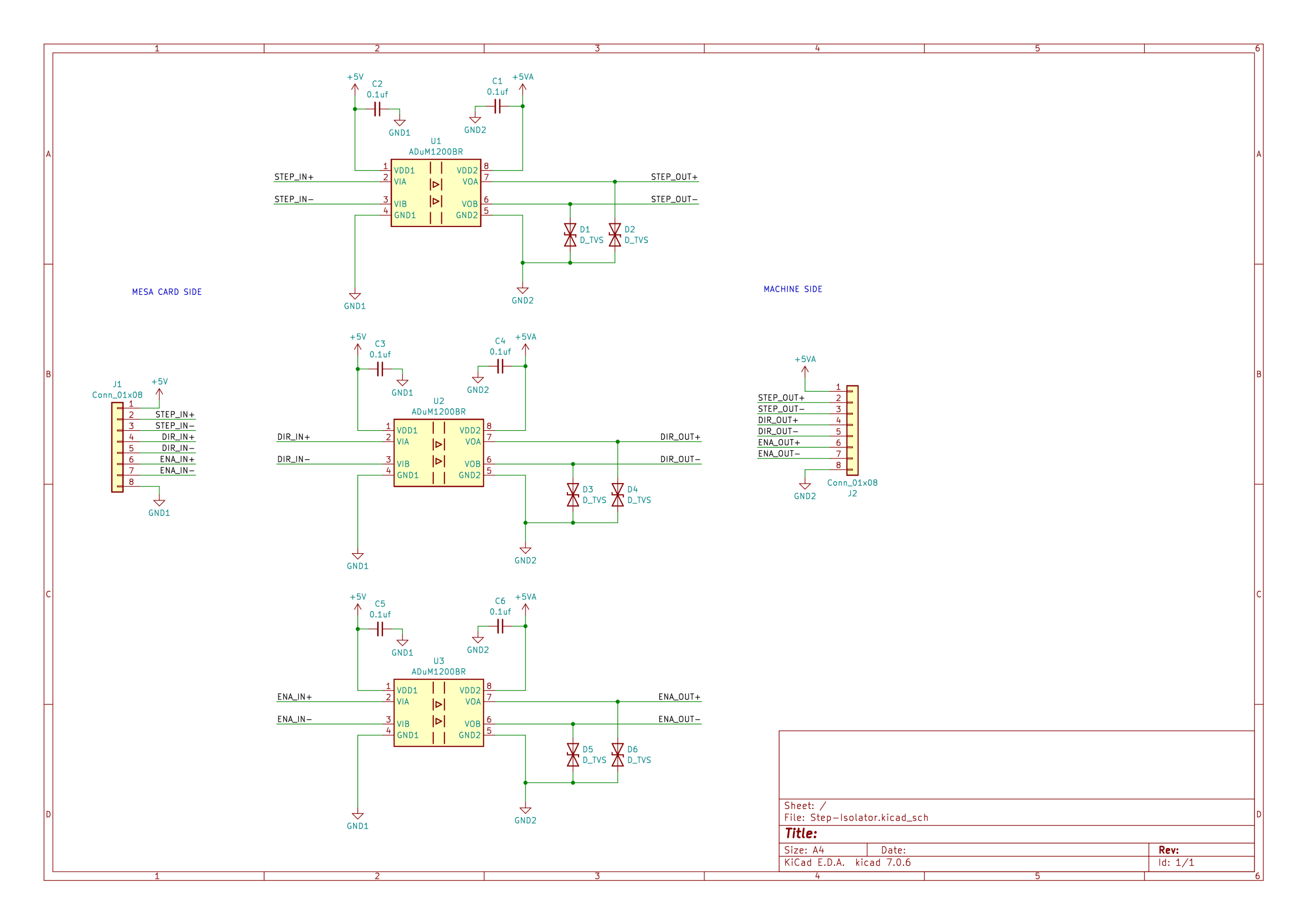

All the suggestions in the thread are good but wouldn't it make sense to actually isolate the stepgen outputs? I've never had great luck selecting fast optocouplers, they're out there but for connecting UART to noisy servo drives I use ADuM1201's which are pretty fast magnetic isolators. You could use the step outputs as single-ended, you'd actually want something like an ADuM1200, and all the cheap little break outs sold are for 1201's and for the sake of a convenient add on to your current setup I would literally Take some ADuM1200 chips and solder them into the step cables, cover them with some kind of hot snot then heat shrink them. Of course it would be better to make a proper break out board and that's super low effort as well.
Beyond that what about sticking some TVS diodes between the stepgen outputs and ground?
11 Aug 2023 05:42 - 11 Aug 2023 08:25 #277603 by blazini36
I only spent about 9 minutes on this, there might be better suited isolators but I'm familiar with these.
Any reason why this concept wouldn't solve the issue and still work for differential step outputs?
Edit: Just noticed the prices on the 1200's are out there for 2 channels.....ADuM160N is a 6channel device for $5 in small quantities. Still cheaper than killing Mesa cards.

11 Aug 2023 17:40 #277650 by blazini36
If you look at what I drew, the servo side is not powered by the 7i96 side. With those Isolators both sides are powered separately, the servo side powers itself (5VA) and has it's own ground (GND2) and the 7i96 side powers itself (5V) and has a separate ground (GND1). I assume the servo DB25 has a 5v pin.
11 Aug 2023 17:52 #277651 by PCW
Oh, OK I didn't zoom in on the schematic so missed that.
 I still think coupled transients large enough to damage the drivers
indicates a grounding/shielding issue  that may cause additional
problems down the line.

11 Aug 2023 18:52 - 11 Aug 2023 20:00 #277658 by blazini36
Oh, OK I didn't zoom in on the schematic so missed that. I still think coupled transients large enough to damage the driversindicates a grounding/shielding issue  that may cause additionalproblems down the line.
 I don't disagree with that. I don't have a CNC plasma but it sounds like this is a difficult issue to resolve if it's jumping around between enclosures. The inputs and outputs of a 7i96 seem reasonably  well isolated as you can isolate the IO supplies but you can't do that with the step outputs. This would at least resolve that would it not?
This is more of a response to sticking capacitors and stuff on everything. If there's a grounding/shielding issue, the caps aren't going to resolve that, they'll just snub some of the transients. I'm not saying that won't work, but it's less of a solution to a "grounding/shielding" issue than a digital isolator is. At least you can physically separate the problem electronics from the sensitive ones with isolators.

12 Aug 2023 14:18 #277730 by santy
I found some ADUM modules for 1$... which is fantastic. if the ever break, i can create a scenario to replace them easily.
My question here is about the 5v on the Servo side.
My servos dont have a 5v output channel. Can i use a 5v Power supply to power the servo side of the 3 ADUM modules?
