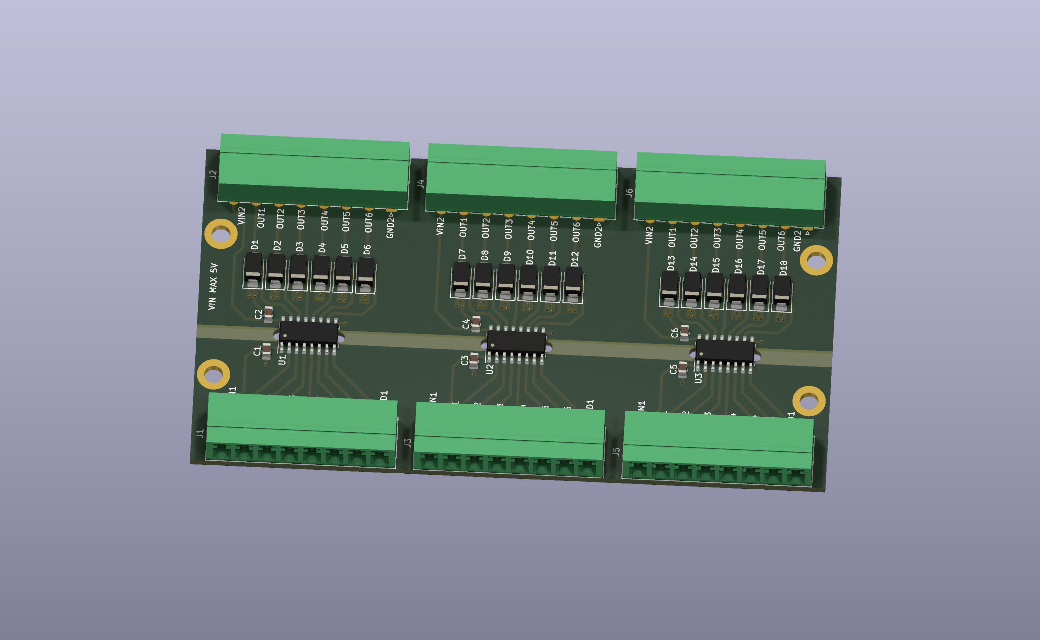

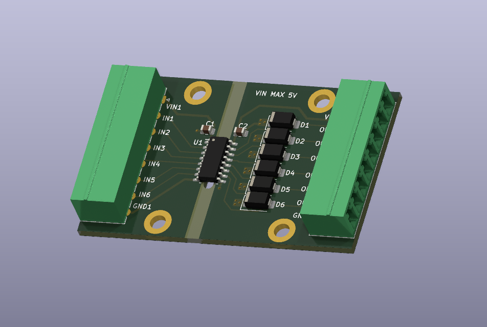

12 Aug 2023 20:29 - 12 Aug 2023 20:31 #277751 by blazini36
I found some ADUM modules for 1$... which is fantastic. if the ever break, i can create a scenario to replace them easily.
My question here is about the 5v on the Servo side.
My servos dont have a 5v output channel. Can i use a 5v Power supply to power the servo side of the 3 ADUM modules?
I searched around a little and didn't find any 1-way ADuM modules, so I'm curious what you're looking at. Modules with an ADuM1201 have 1 input and 1 output, they are for single ended serial applications. You could use just 1 side but you'd need 2 or 3 modules for a single stepgen and that's no good.
I think trying to be "cheap" about it is a bad idea, no way to know if the chips on those little PCBs from Amazon or Ebay are even real. Fake ICs are a real problem.
Sometimes in specific applications you can get away with not powering 1 side of an ADuM chip, just use the ground. I think this really comes down to how much strength is required to drive that side. I don't think I'd recommend it but I do have one thing I do where it works so well without powering 1 side I don't even bother to. I have another where I can't get away with that.
That said you should probably post a manual for your servo drives as that drive has to have a way of powering it's own outputs.
I had some time last night so I whipped up a 6 channel and an 18 channel PCB. I have to get some other boards ran soon so I figured I'd stuff these in there.
