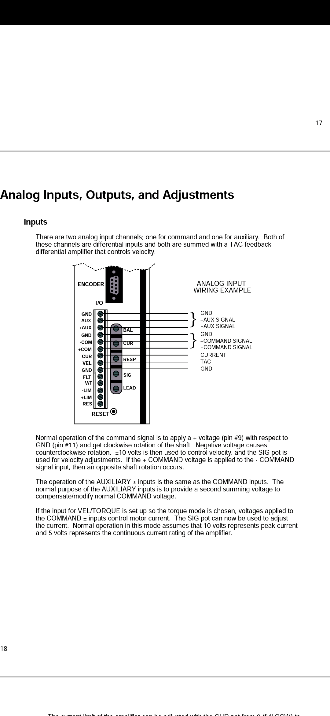

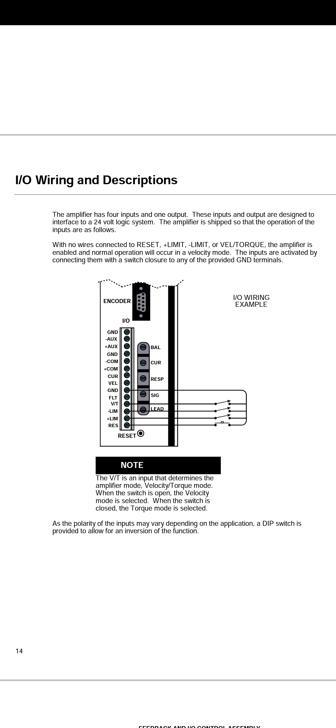

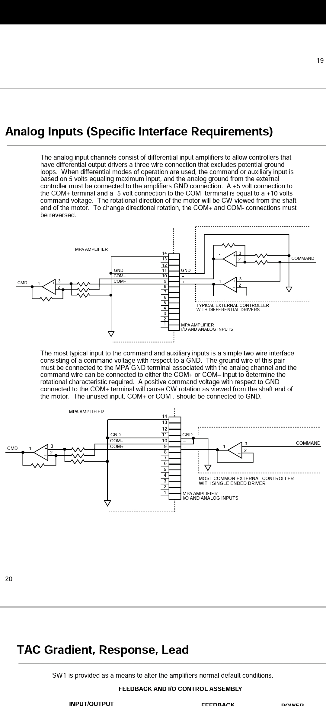

Hi , I just picked up a 1996 standard modern lathe with a bad centurion controller , the lathe uses parker MPA analog drives and servos.
A bit in the selection of boards , I require analog control +/- 10v for the mpa drives for axis and spindle , the drives require a sinking control to enable/reset but the rest of the machine runs on a 24v system for all limits
the drives have resolvers but output a simulated encoder signal for linuxcnc , the spindle (also a mpa drive) has a heidenhan encoder as well as a resolver.
I will also need to control a pragati tool changer that has a small 3 phase motor with a absolute encoder (i havent tore into this much yet)
thankful for any help in selection you guys/gals can offer , happy to be back on a forum its been a few years.
I also understand that boards are in short supply , I don't have a problem waiting a couple months for the right combo.
Attached is a picture of the drive wiring diagram

Mesa should have 7I97T cards in 6 weeks (basically the same as a 7I97 but with a different FPGA)
